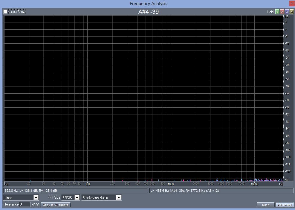

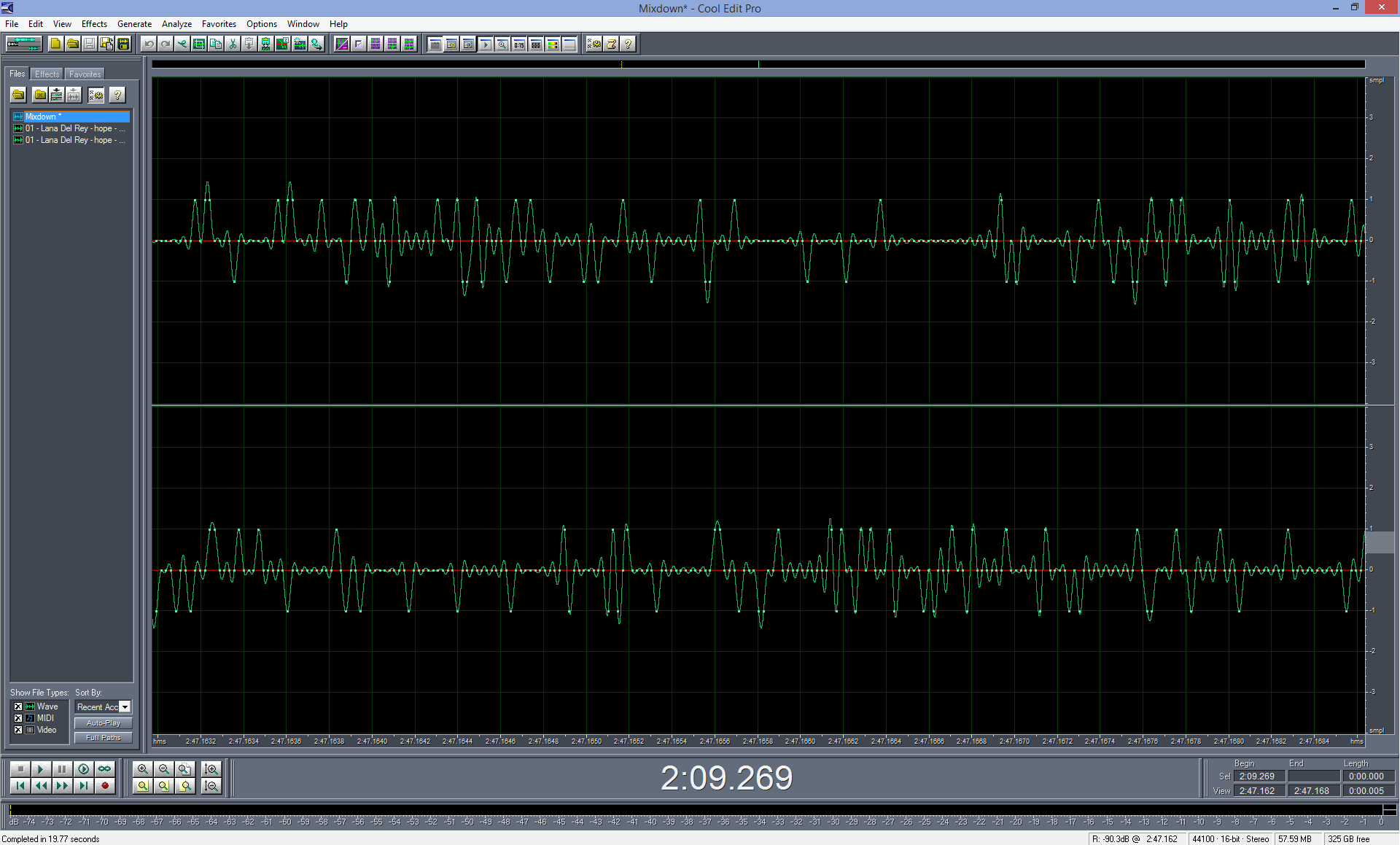

Hey Dan, you must be pulling our legs. "ORIG" file and "ORIG 16bit" file are identical and none of them is 24bit, though "ORIG" file pretends to be 24bit by coding. However levels are 16bit resolution. The files differ in 1bit (dithering?) noise. So any audible difference between these two is a wrong playback system.
