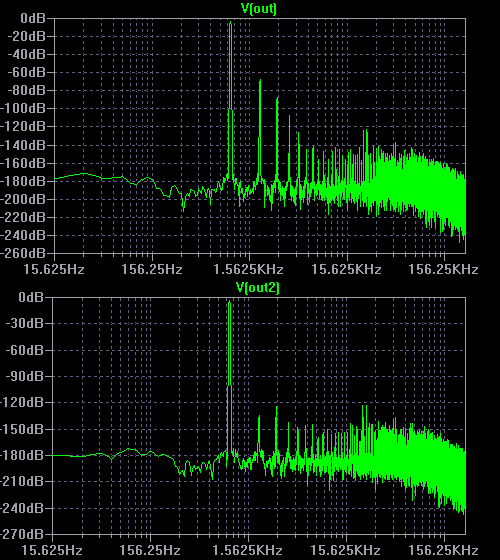

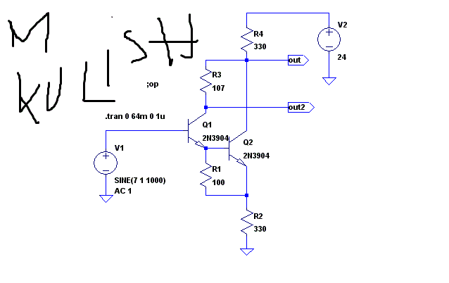

This is not my cascoded version et al. But increasing from 1v rms to 3 v rms and 20KHz (no filters applied) the harmonics are still below -100 un-trimmed/ 20% matched version.
How hot should I be driving it ?
Its late. I will see all the harmonics when I get closer to clipping. But for all practical purposes at normal max output levels, well below clipping, the 2H and 3H from all bipolar only dominate here..

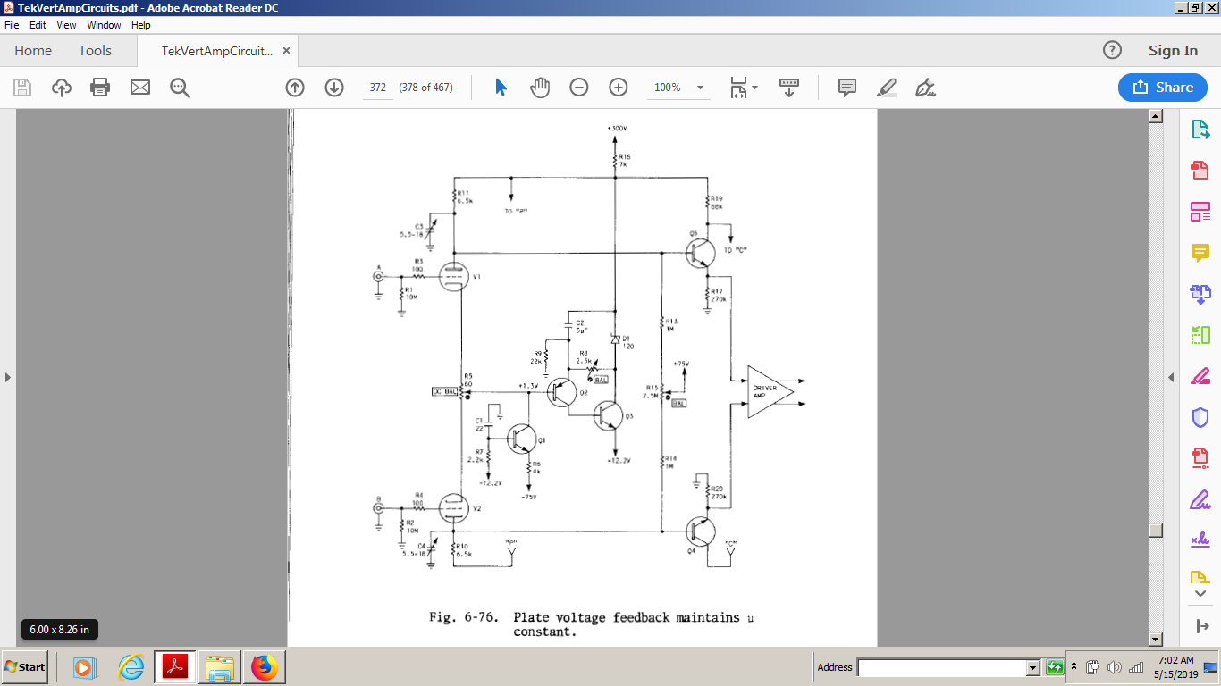

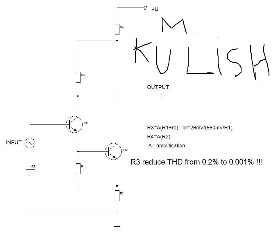

I found this over in the SS forum, around a half dozen threads related to it. In one thread it was suggested that this was an old tube circuit, but they never produced any evidence of that. Anyway, it provides around a 100X improvement in distortion over a single device. Only uses two devices. (Looks similar to a Darlington) Works with all N type devices, including tubes. It uses feedforward error correction rather than feedback. And it functions as a V to I converter, but is suitable for driving a cascode above it for V to V use. Still trying to get a clear picture in my mind how it works so well, but supposedly the second device is adding opposite distortion of the first device, so cancelling. Zo = R3+R4. Gain == R4/R2 (for Rload >> R3+R4)
R3 has to be critically adjusted for linearity. For gain of 3 in post #27 circuit: R1 100 Ohm, R2 332 Ohm, R3 318 Ohm, R4 1000 Ohm. More info and a diagram in the link:
Kulish Circuit
Single darlington line preamp. - Page 3 - diyAudio
Kulish Circuit
https://www.diyaudio.com/forums/solid-state/74861-single-darlington-line-preamp-3.html#post857018
I am producing that evidence now in the attachment.Tektronix used bipolar transistors to cancel tube distortions...
For every poison there's a cure.
