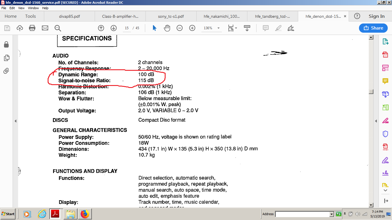

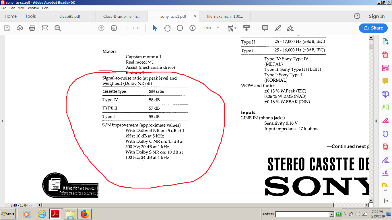

So all the measurements presented in their service manuals are done as an improvement in SNR at a specific frequency and they DO NOT get any closer to -115db...
Yet my best cd player had a max dynamic range of 100db and a max snr of -115 db , i had two of the best Nakamichi's and one of the best Pioneer(last and best version of dolby c), Technics (dbx), Tascam(dbx) plus several sony with dolby s and none of them at their best can give a PERCEIVED SNR and Dynamics any closer to my Denon Cd player while they had the last and most performant generation of dolby b-c-s.Dolby s is as quiet as it needs, but its Perceived Dynamics is lower that the 1991 cd player.
Without any noise reduction system there's no chance you can hear anything near to my cd player either.
This would be meaningless, the random noise at any single frequency has a zero mean value. A lock-in amplifier or synchronous vector averaging of FFT's will eventually give you a huge SNR. I never used Dolby BTW, in the old days I had a Nak and always used the metal tape and was never bothered by the SNR. Everyone I made tapes for asked how did I get it to sound so good. I met Nak's chief design guru in 1988, spoke perfect English (rare at the time).
In the end my cd player has wider dynamics and snr than any of those decks...I had two Nakamichi cr 4 in perfect condition...the tape sound better because of its inherent characteristics, but not because any superior SNR or dynamics.
Exactly, you prove the point. The manuals do not specify any particular bandwidth for the s/n measurement, it is the weighted (or not) full bandwidth noise measurement. Let's presume that Sony TCK-333 has a s/n broadband of 61 dB with Metal tape, at 3 KHz for instance the actual measured noise level in just the critical bandwidth of say 350 Hz centered at 3 KHz might be (wild guess here) 85-90 dB or better.
And I agree without NR a cassette is rarely comparable to a CD player...
Howie
And sorry, I missed part of your question. The improvement at certain frequencies they show are the difference in s/n Dolby in/out still a broadband measurement.
Howie
