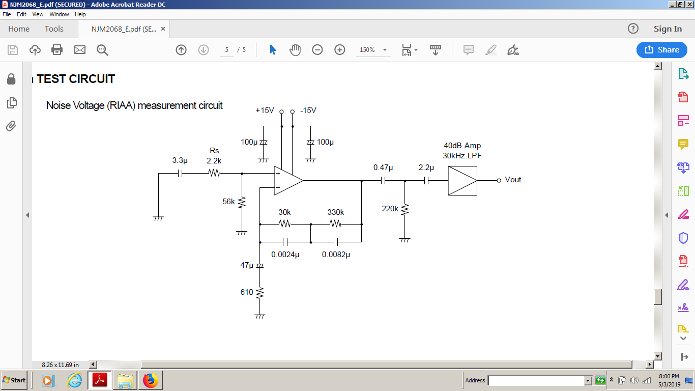

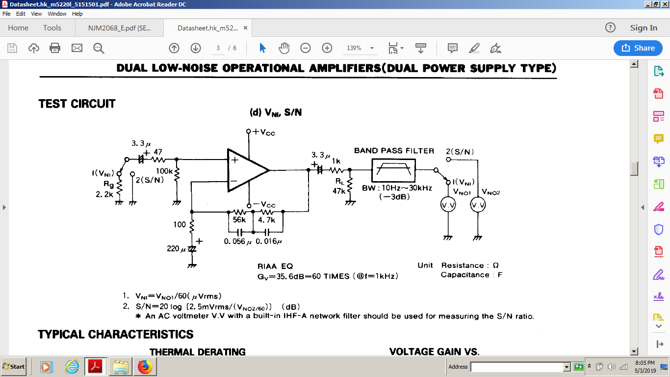

Do you see anything suspicious?
Well , njm2068 is a bipolar design ic, usually it needed a capacitor at the input .
m5220 was made for phono preamps, it was available 25 years ago and in fact it was so good hat they used it as i/v stages and as cassette tapehead preamps with no input capacitor...although it was bipolar input.
