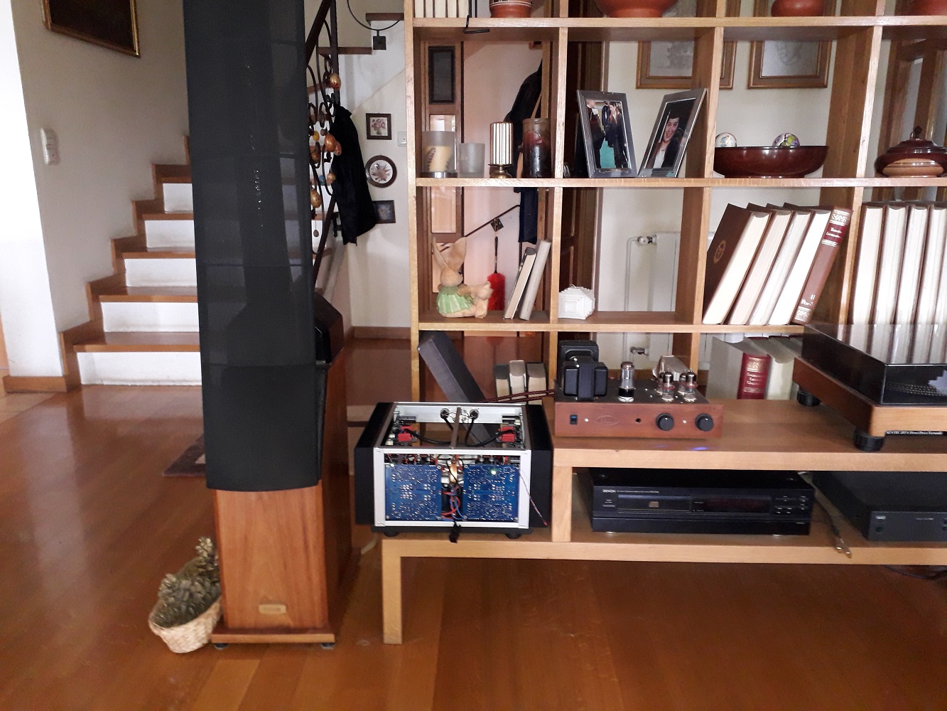

First listening impressions ?And this is my last monster amp (monster energy consumption) playing both channel now. So far so good.
So far so good.🙂 I tried with unbalanced inputs only, next I'll do with balanced using Benchmark DAC2.

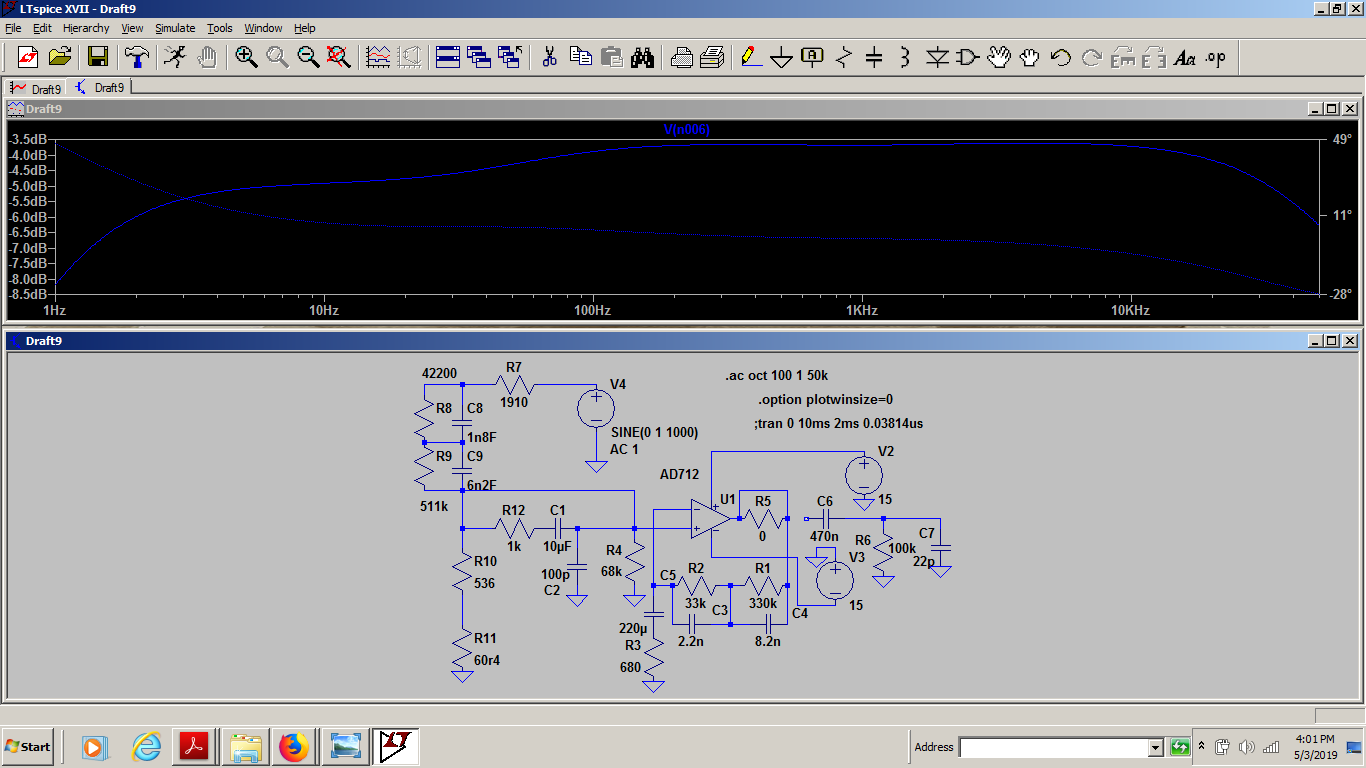

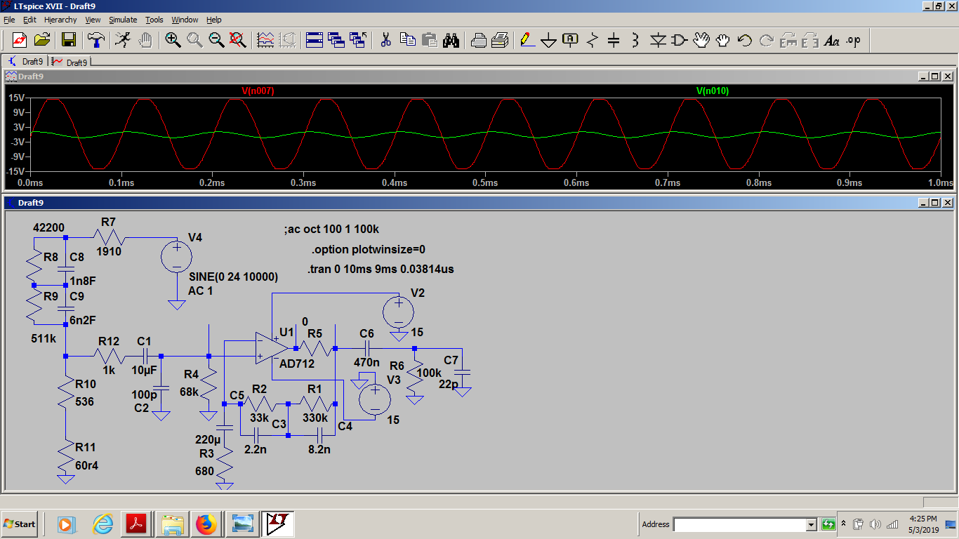

OK everybody, let's look at a PRACTICAL preamp circuit that was made for 95% of the audio users. Please note the caps, (input, feedback, output) in the phono stage to start. Check out their time constants and how their DA might add up. But that's not all. There is the rest of the circuit. AND what did they use? Scott's AD712 of course, one of the IC's recommended by me at the time to the designers of this preamp. Just to rub it in, the phono stage has 3 aluminum caps in the circuit, even though the AD712 is laser trimmed for lower DC offset. This is what we try to design OUT with a single servo with a single Mylar cap in the servo.
I finally get it...this thread is about a personal war between Scott Wurcer and Juhn Curl...
Well , i won't try to sell my "poor" third world country medicines to the USA, as they are not yet approved by the drug association, BUT:

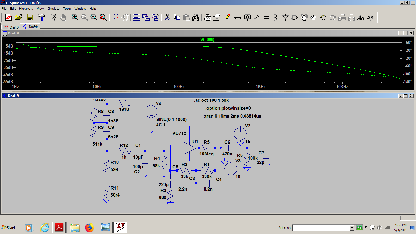

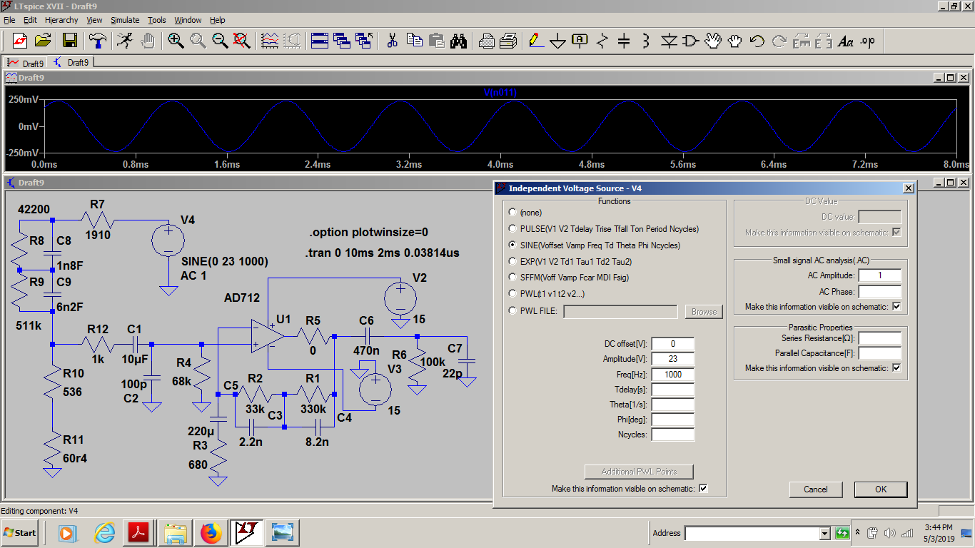

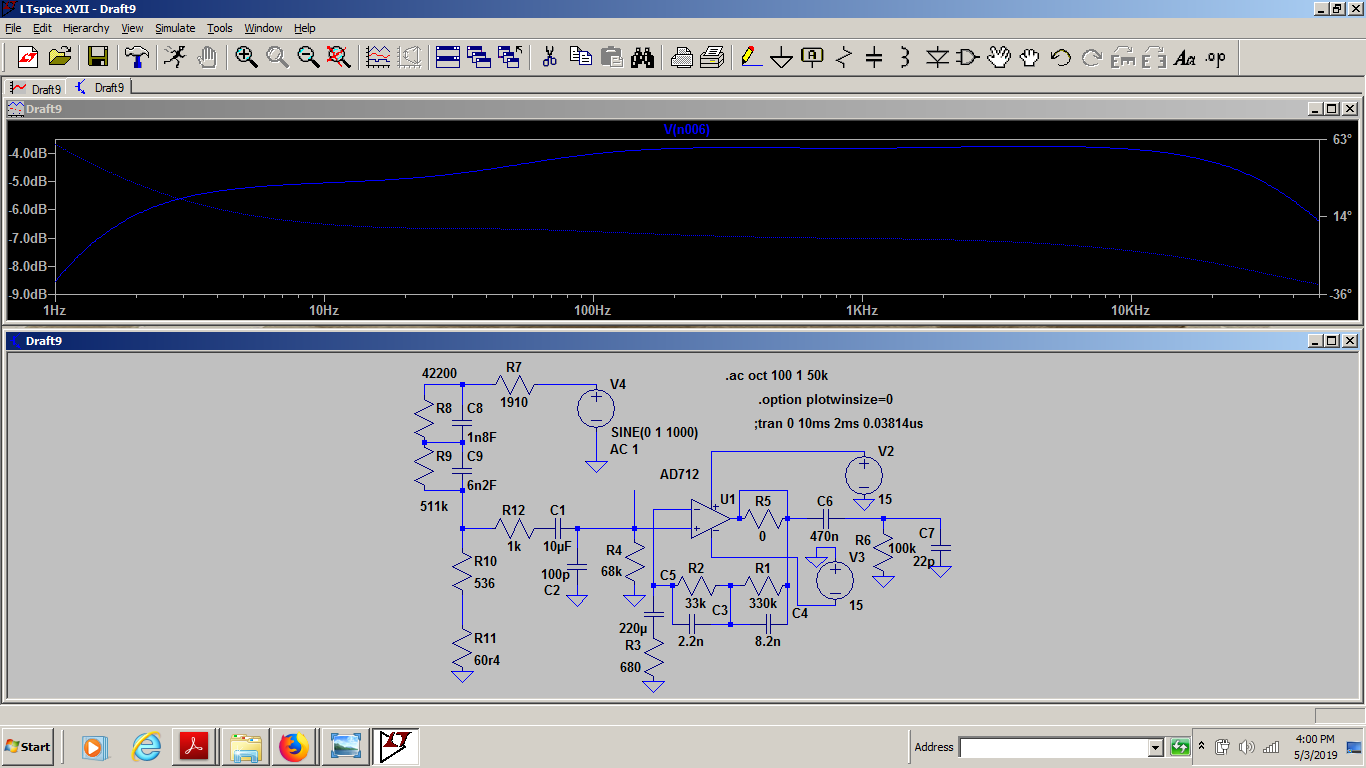

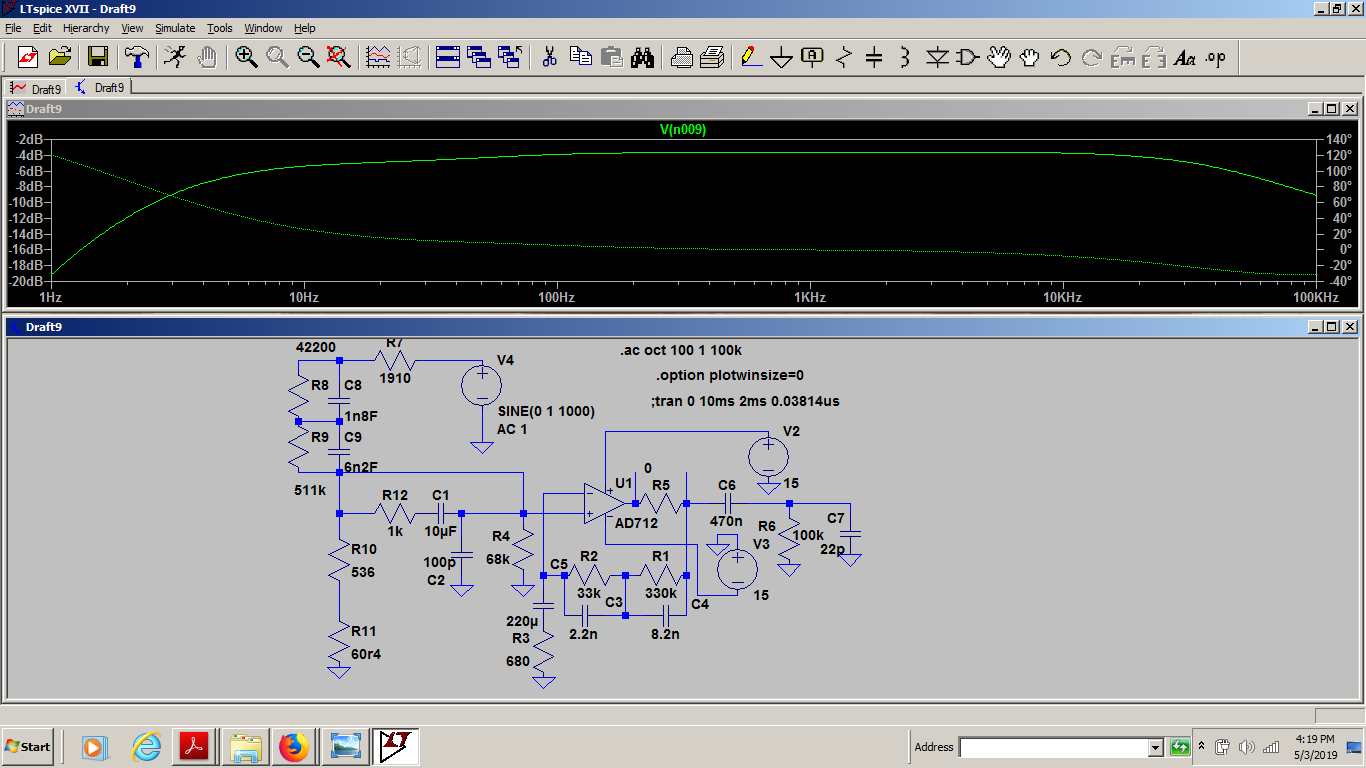

AD712 was not made for phono preamplifiers.
You have attached the proof for it next to the advertised phono preamp in your post .
What made you recommend this op-amp for a phono preamp after reading its datasheet?
I can't find a single argument for that.
At least you didn't complain about the c-mos electronic switch right after the phono preamp...I can appreciate the true engineer here!

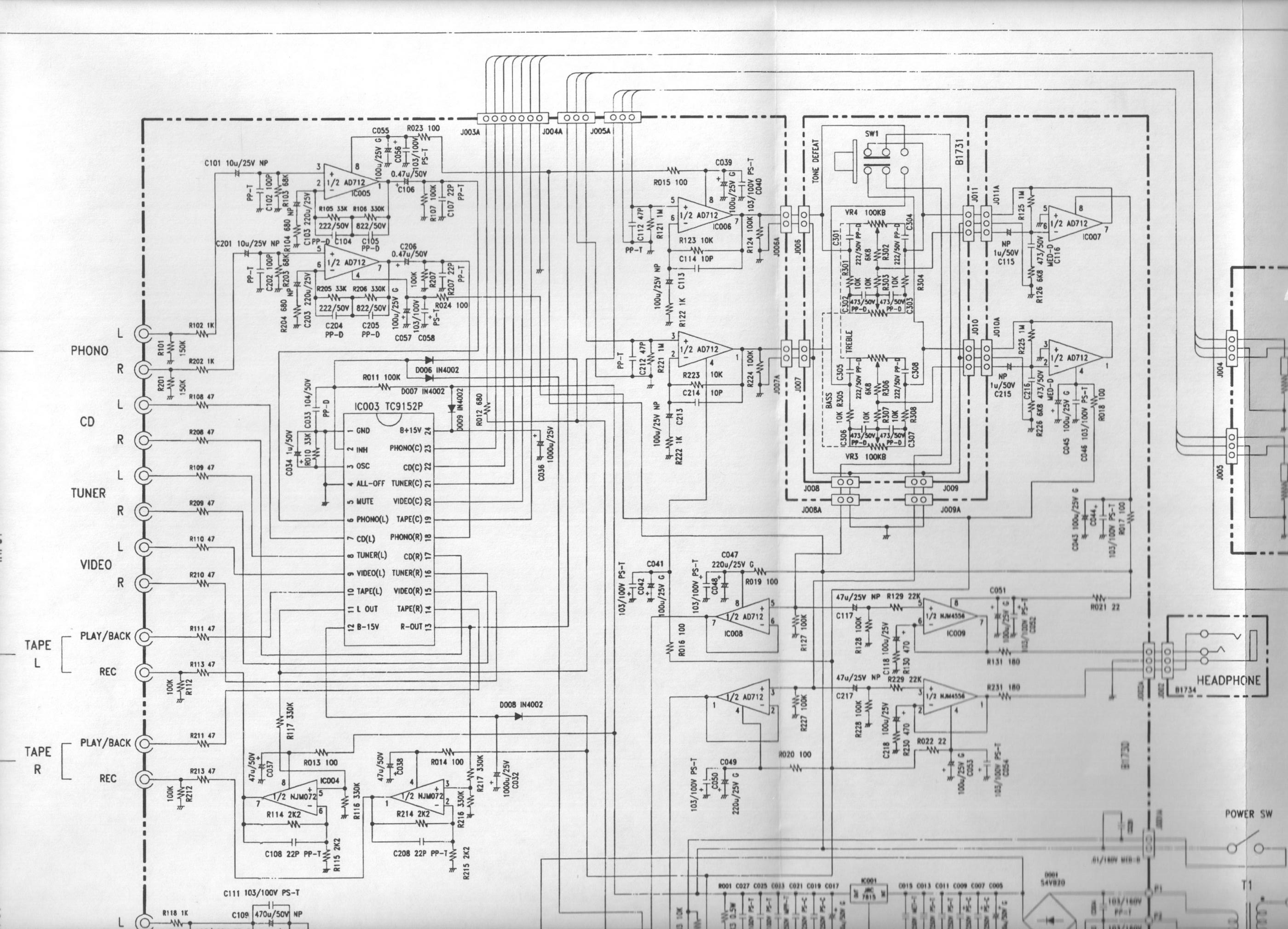

What made those brilliant designers put a capacitor at the input of a fet op-amp other than the fact they deliberately put it into a commercial system that needs to address every stupid user on Earth trying to plug the juicer through it to the grid maybe...
That amp was specifically made for stupid snobs and those designers that took advice from you treated them as stupid snobs.
Look inside any decent Marantz or Technics or Hitachi with fets or fet op-amps at the input...There's no input capacitor at all because it doesn't matter .
And they were sold in millions ...
Basically i have a great, no sorry, let me rephrase ...
I have THE GREATEST RESPECT FOR ANALOG DEVICES DATASHEET forms for they were much better explained and much more closer to the truth than the competition.
I've learned a lot more useful things from just two AD datasheets than from another 1000 from the whole competition, which are the AD797 and AD743
AD is not as humble as NJR , Hitachi, Mitsubishi or NEC which didn't even tell the most positive things about their chips for decades , but they know what they sell, that is for sure.
You can play the way you want with the sim i made and posted here and please try make the usual DA count for worse in a any phono preamp ever made IF you can!
A phono cartridge is an electromagnetic transducer, its slew rate can hardly beat any op-amp slew rate, but what's really important for a op amp in a phono preamp is its maximum supply voltage related to the saturation in the final stage.
Now...i know why this op-amp did still made a decent phono preamp in terms of linearity which is easily seen in the sim, and that is the high impedance of the feedback network, but you still needed to fix the lower range response with the final passive network after the op-amp .
So...where is it that you lost that dynamic?
Did you do it with the max +-15v supply?
Did you loose it in the high noise of the high impedance feedback network or in the final filter after the op-amp trying to fix the Bode plot?
Please keep in mind that i used the same antiriaa network with some simulations that show perfect response in the audio range with the right riaa network.

Dreamth, this is a Parasound schematic, but I don't recognize it. What is its title?
You should know better because it's your post number #11
https://www.diyaudio.com/forums/the...blowtorch-preamplifier-iii-2.html#post5344651
