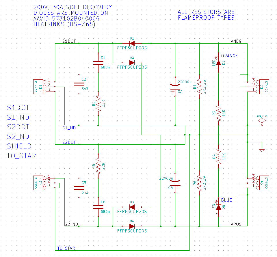

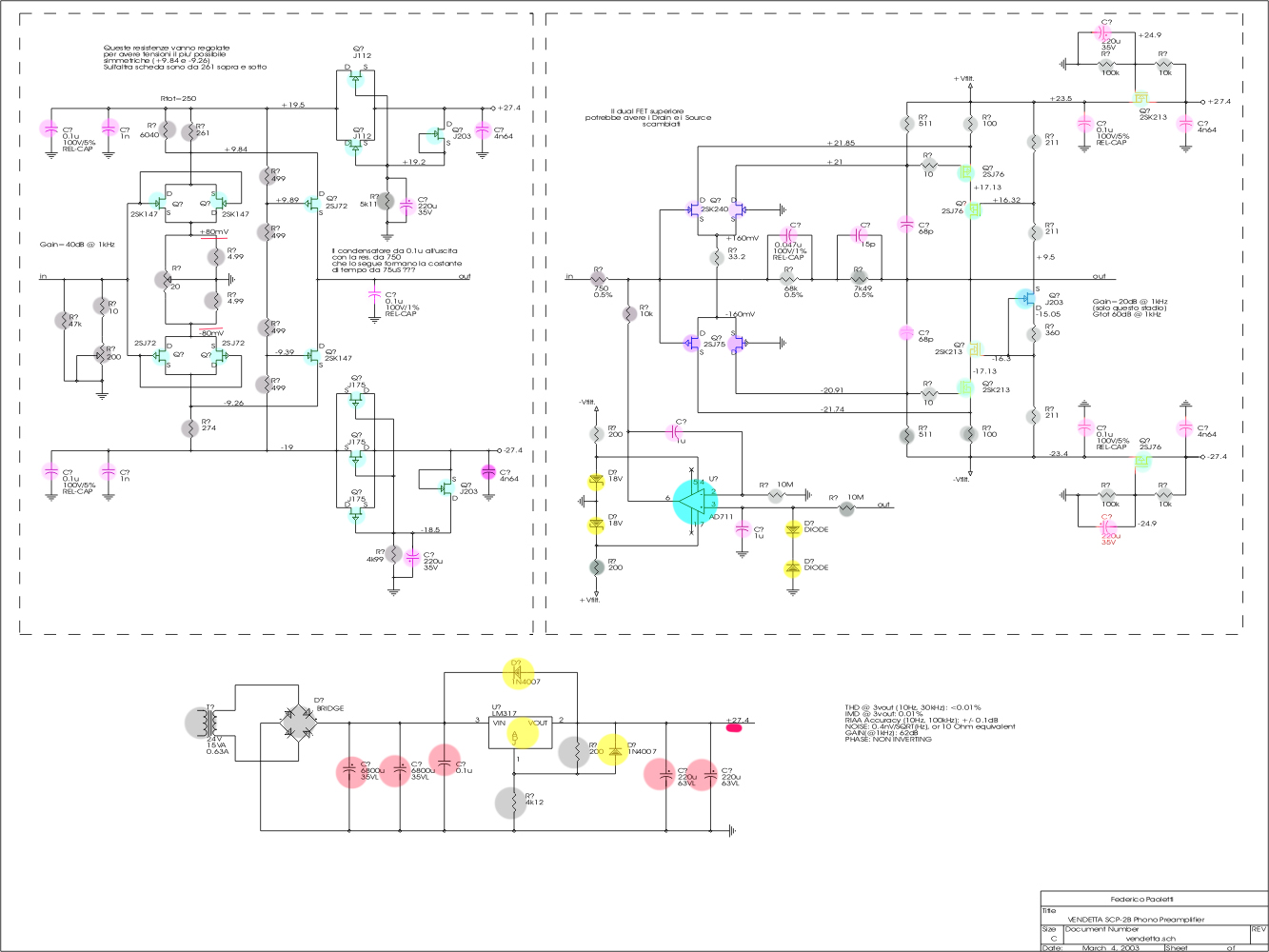

OK, starting with the snippy comment by Mark J, what can we do to IMPROVE the transformer and diode bridge in this schematic? Design first made 35 years ago. (Note, there is a (-) supply too.)
To move things along, we should AVOID a toroid power transformer, and instead use an E-I low leakage type, or an R-core to reduce RFI input from the power line. Also we should increase its rating. We upgraded to 30W per channel in the Vendetta as years passed. (30 years ago)
Also, we should use high speed soft-recovery diodes, either as a bridge, or as individual components put together to make a bridge. (D upgrade for Vendetta, from middle 1990's or 25 years ago.)
OK what other suggestions do you have? Mark? Want to go next? '-)

Or, maybe you should actually use a toroid with an electrostatic shield (if you are really concerned). That will give you smaller stray field and then you can actually put appropriate RFI filtering and a regulator that isn't from the late 1970s. It is much harder to shield against the LF magnetic fields from the transformer.
That, or join the 2000s and design a good SMPS.
I chose a common-mode choke for the CTC-Vendetta supply in 1998. (20 years ago)
Yes, those are nothing new. Same for ferrites, etc. There are a lot of different core materials available now, though, depending on what frequency range you are looking at. Wurth and a few others have an amorphous nanocrystalline material that gives something like the low frequency characteristics of MnZn and the high frequency characteristics of NiZn.
WE-CMBNC Common Mode Power Line Choke Nanocrystalline | Passive Components | Wurth Electronics Standard Parts

I'm not Mark 😉 But,

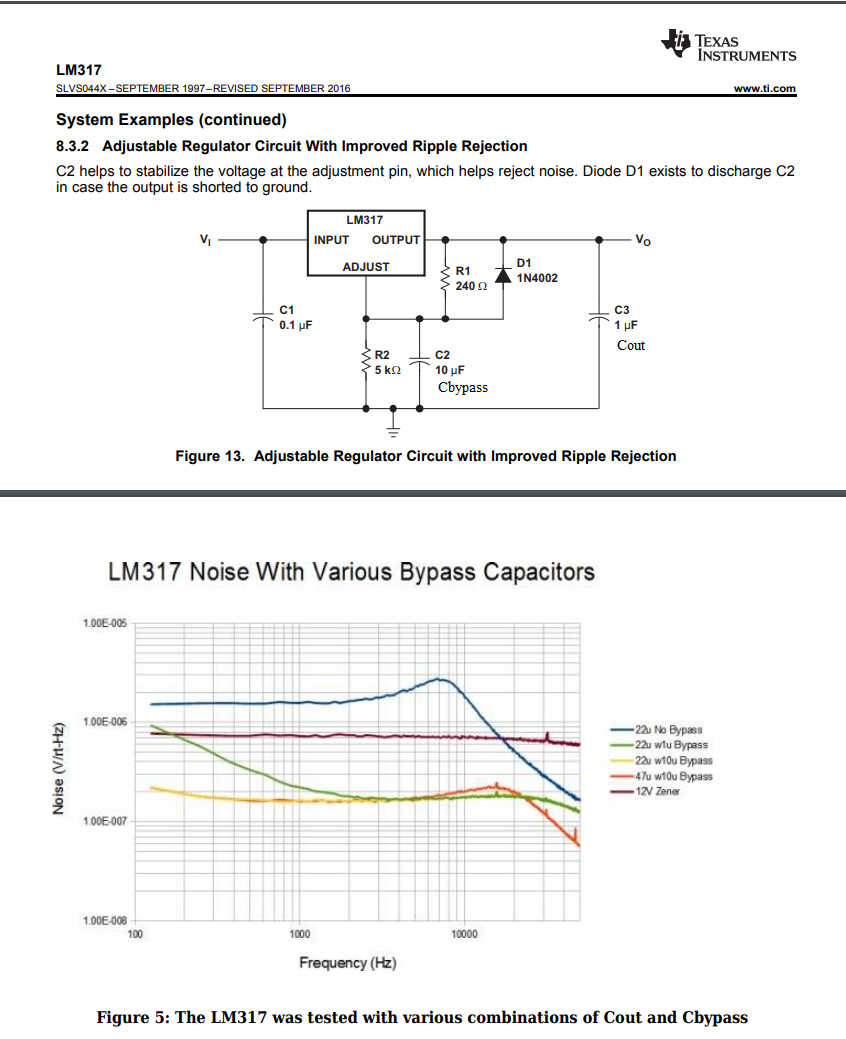

Vastly current overrate the soft recovery diodes. I like HEXFRED 25A or 30A devices. Ditch the LM317. Use a discrete reg made with a single series bipolar pass transistor also vastly current overrated. Tie the biggest capacity teflon cap you can stand from rail to rail at the power entry point of the front end.
That's where I would start. All the while being very careful not to blow the hard to get Toshiba transistors.
