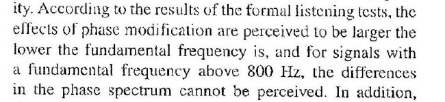

But only below 800Hz and only when they cause a 2-4dB magnitude change*. Shock horror.
Only? Most freq we listen to are midrange and below. Check your shock and horror at your speaker and room.
THx-RNMarsh
So you have the results from your own formal tests to present? Informal sighted testing as usual?
Read the fine print before you jump to conclusions, Scott.... [AES vol 61 no.11, 2013 nov]

I read the fine print. Above 800Hz can't be detected. You posted the extract!
I posted the Conclusion of the art.
Those with more inquiring minds can read the entire article as I put source of it up there. To fill or fine tuning the knowledge gaps. This is another fairly recent piece of audibility about Phase.
So. What is so special to you about 800Hz?

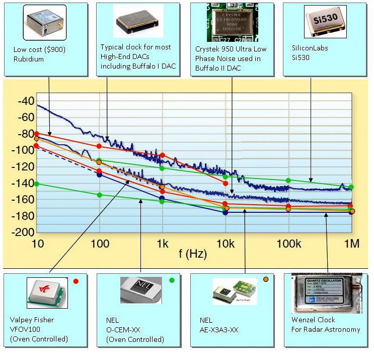

Mark... re Phase Noise in clocks..... have you or any other used the NEL model O-CEM-XX (oven Controlled)? -140 at 10Hz. -170dbv at >1Khz phase noise.
Typical clock for most High-End DAC's -- including Buffalo 1 DAC is like -45 at 10Hz and -115 at 1KHz.
It beats out a low cost ($900) Rubidium clock by a mile.

I don’t know where you get your numbers but they are wrong.
This is a $1.36 XO from Kyocera and the numbers are far better:
KC2520K22.5792C1GE00 Kyocera International Inc. Electronic Components | Crystals, Oscillators, Resonators | DigiKey
There’s going to be a point where the logic in the DAC swamps anything your clock contributes also.

Ah... thats progress, perhaps. Mine from actual measured results:
Again the truth is in the details --- Your's are "C" weighted (cheating).
THx-RNMarsh
You posted it! Attached is the specific sentence from the pdf you attached. Now the fact that phase shift matters at lower frequencies is both interesting and annoying and worthy of discussion.

Who measured that? What test setup? How do they even know what a typical clock is??
Kyocera specifies the model of Wavecrest analyzer they used.
Just what do you think is in your Benchmark?
Rubidium clocks are the right solution for a different problem. A good crystal oscillator is the right solution for audio. Those are very good and will be a restricted product ( and very $$$). Anything with phase noise below -150 dB gets special treatment.Mark... re Phase Noise in clocks..... have you or any other used the NEL model O-CEM-XX (oven Controlled)? -140 at 10Hz. -170dbv at >1Khz phase noise.
THx-RNMarsh
The phase noise won't make it through any DAC or ADC I know of. The internal additive phase noise will limit it. However it will sell DAC for premium prices.
OK. Good. That is my intention, too.
