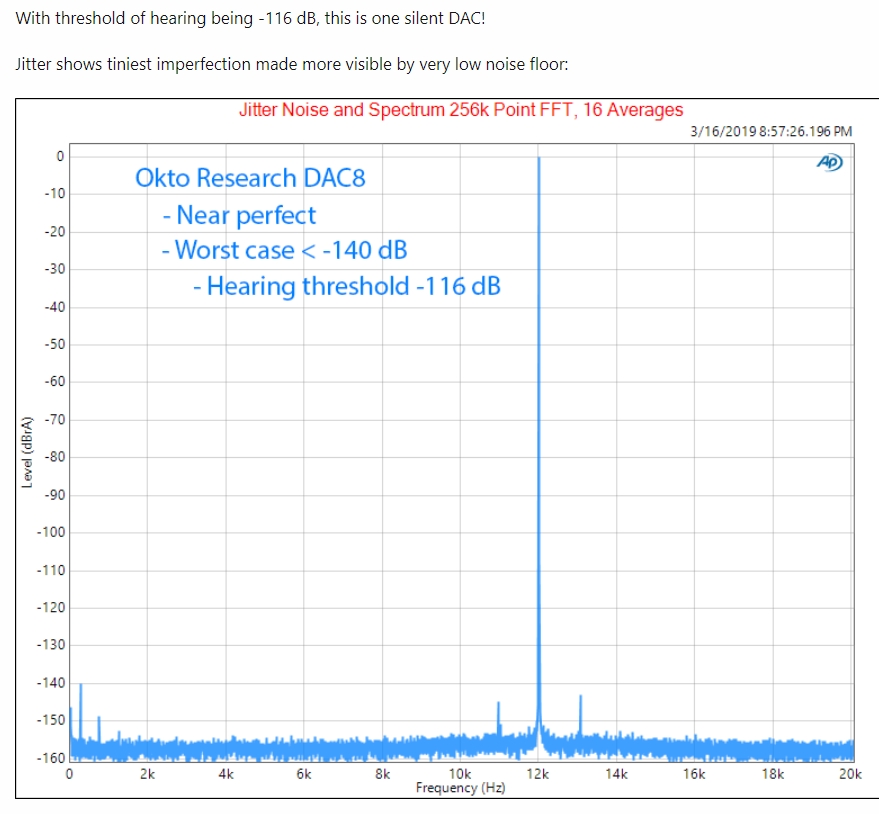

Further, I was reading a review of the latest greatest dac yet at ASR and the guy that does the measurements said the dac distortion came at around -130dB, IIRC, and since the limit of audibility is -116dB the dac distortion is therefore inaudible.
Needless to say I was surprised at the number -116dB, not -117dB and not -115dB, but exactly -116dB! None of the other objectivist guys jumped in to complain either.
Regardless of wherever that number came from, I think the actual number is probably a bit lower for at least a few people. Nothing amazing about it to me, maybe you are more easily amazed, I don't know. Human hearing is an interesting thing and we haven't learned or proven everything it can do yet, IMHO.

Do you have a link? Again you use a known flawed way of digitizing a signal to prove some point.
The CD example only makes clear than one particular effect has been demonstrated and accepted as non-controversial. Doesn't prove anything beyond what it says. It does illustrate at least one kind of correlated high order distortion can be audible at low levels.
Regarding what I recalled seeing at ASR, looking at it again maybe I was misinterpreting what they were trying so say. Could be. Picture below. Link: Review and Measurements of Okto DAC8 8Ch DAC & Amp | Audio Science Review (ASR) Forum
