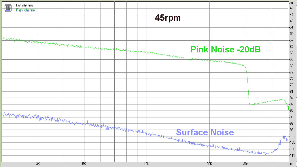

A remark in the form of a question, for people, like J.C., who, accustomed to analog sources and its weak signal/noise ratio, seems to be spoiled by the low resolution of the digital systems on very low levels, it might be good to keep a little analog noise in its amps and keep the analog threshold higher than the digital noise level ? A pink noise generator that we could adjust in level ?
Sometimes the best is the enemy of the good ;-)

Noise blanket masking?
I see from your editing you are approaching the vinyl fans club
https://www.diyaudio.com/forums/att...tridge-dynamic-behaviour-45-surface-noise-jpg
(Courtesy of Hans Polak)
