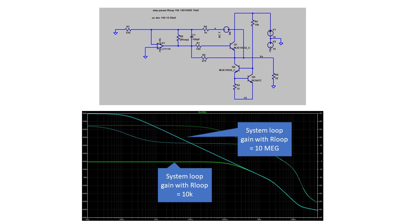

You can try this.
(there are other techniques as well where you run the actual opamp itself at high gain)
But, if you want low loop gain, why are you not happy using a NE5534? It has much lower loop gains (10^5 IIRC) than modern opamps, access to comp pins and you can tailor the loop gain to exactly what you want.
I am not anti-discrete, but I don't buy that 'discrete is better' for any reason.
(R2 in the atrached diagram allows you to bias the opamp output stage into class A i.e. Ibias ~0.6/R2)
