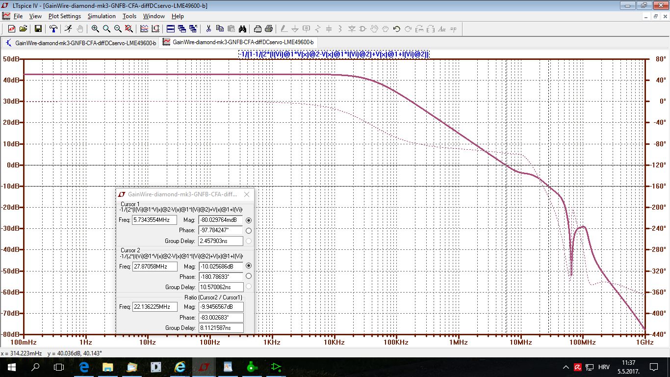

Its very easy on a power amp to have wide loop bandwidths - that's what TPC, TMC etc are all about. And its also very easy to adjust the loop gain magnitude as well, if that is a concern you have.
If you want that on your op-amp based designs then there are a number of routes you can go if you have access to the comp pins.

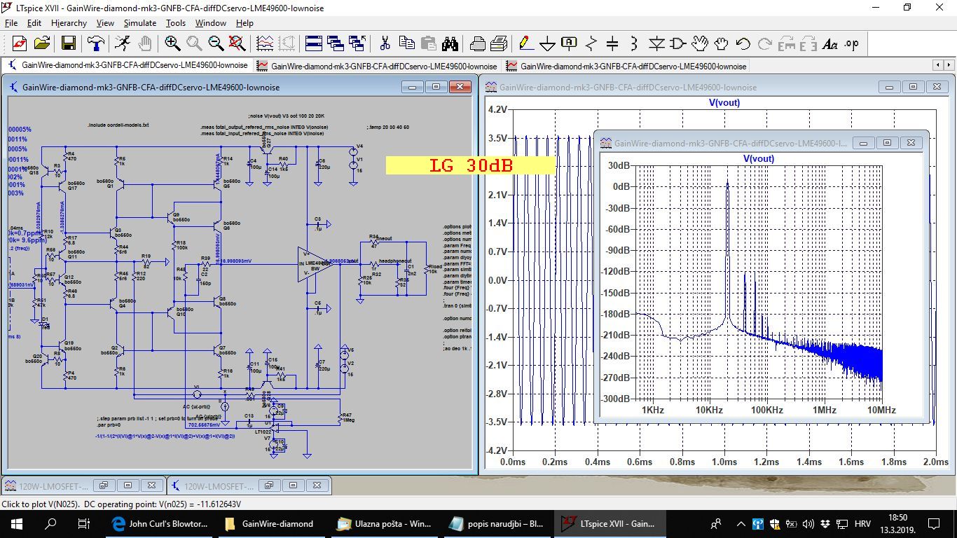

Preamp GainWire mk4 with IC buffer and discrete current conveyor IPS showed some post back Loop Gain plot is here. CLG is 11dB.
edit:
It's easy to lower LG to 30dB flat up to 90kHz and THD is still very very low.
Ron's tests are still primitive, as he has to design his own test equipment in his garage. IF an upscale audio test equipment manufacturer would design this test into their test equipment, we would most probably have a much lower distortion residual, and therefore virtually every IC could be measured easily. Of course, it might be that PIM as defined by Otala is again not the only mechanism detected by the human ear when it comes to how much feedback one uses.
Try harder to understand PIM. There are several AES papers that go much farther then Bob Cordell did, back 35+ years ago.
John, you are doing it again. You keep harking back ‘35 years ago’ like your LM741 thing. Modern opamps are about as close to a 741 as a WW1 bi- plane is to a F35.
Wrapping amplifier design up in subjective mystique and peddling it as ‘advanced engineering’ is just nonsense and you know it.
Where is the PIM plot on a modern opamp? Please produce a valid measurement otherwise this is just another straw man.
