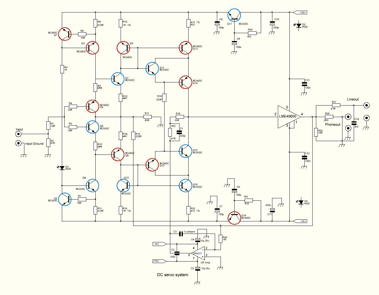

I am going to build this phone amp in SMT, practically no distortion at all level or phone loads.
Damir
Looks good. You should check out the new BUF634A. It’s a slightly improved version with wider BW and lower quiescent current.
