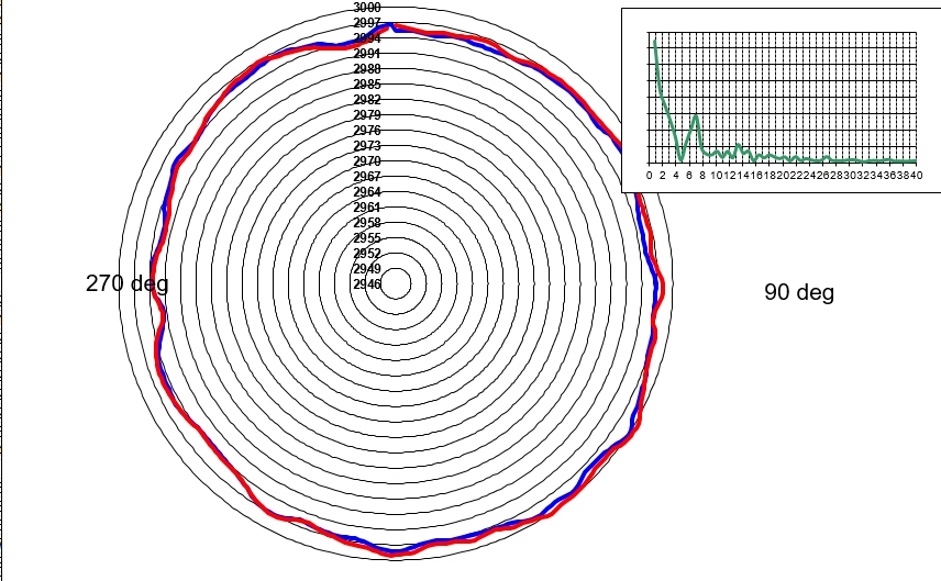

I've attached a plot from that thread, which is an SL-1200 Mk4. Possibly the lowliest in JP's collection. The plot is speed stability over two rotations overlaid. In this case there is possibly a worn bearing, but the result is still very good compared to other TT measurements. And people worry about DAC jitter :)
Doesn't look super impressive, but how bad are other ones?
Some are really awful, but usually becuase they were in need of a good tuneup. It's all in here Turntable speed stabilty

Bill, I think I'm going to get all my TT advice from you first. You're avid in all the topics about them, it seems. And you were not pulling my leg, the one you showed is far from the worst!
