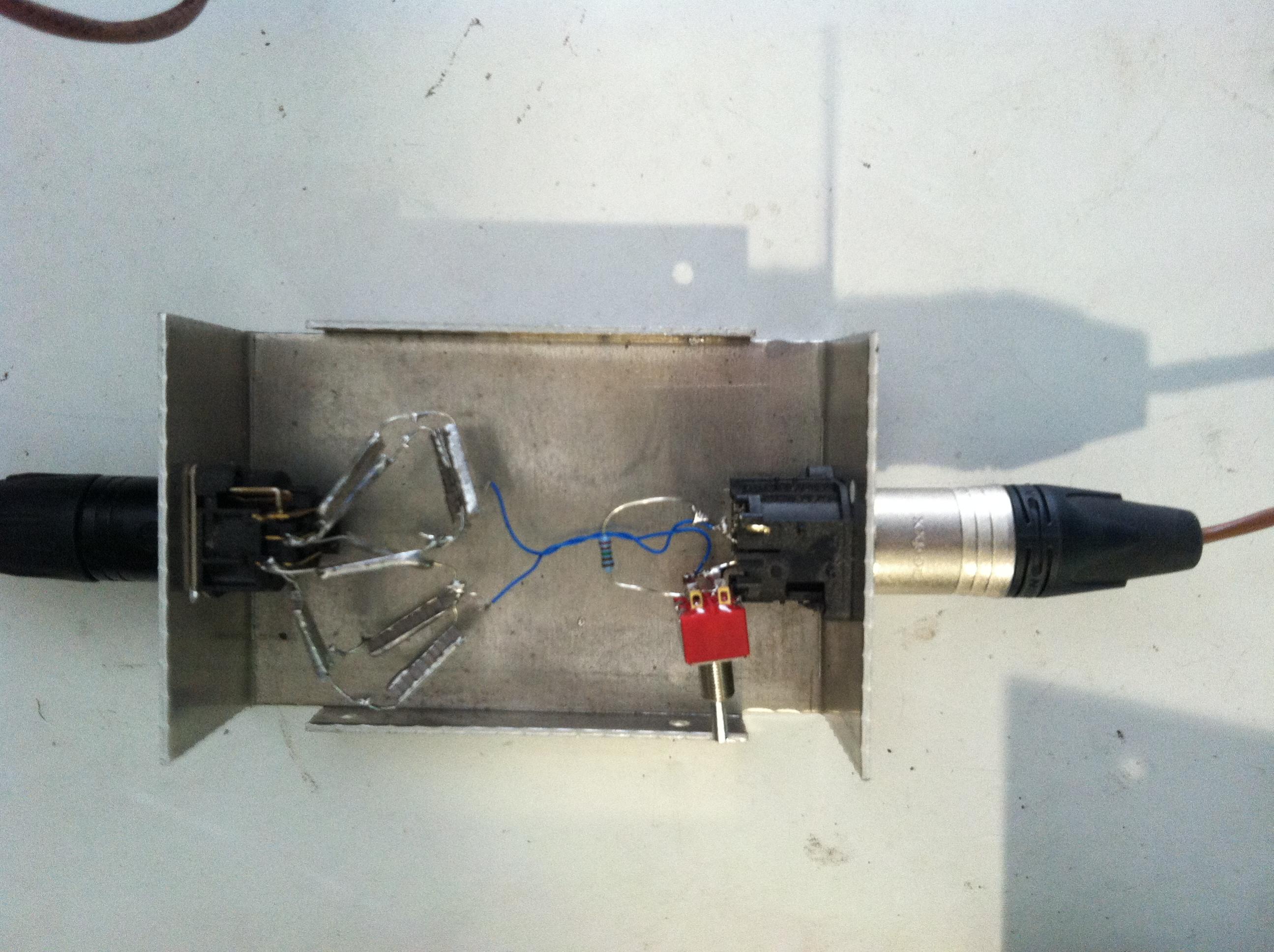

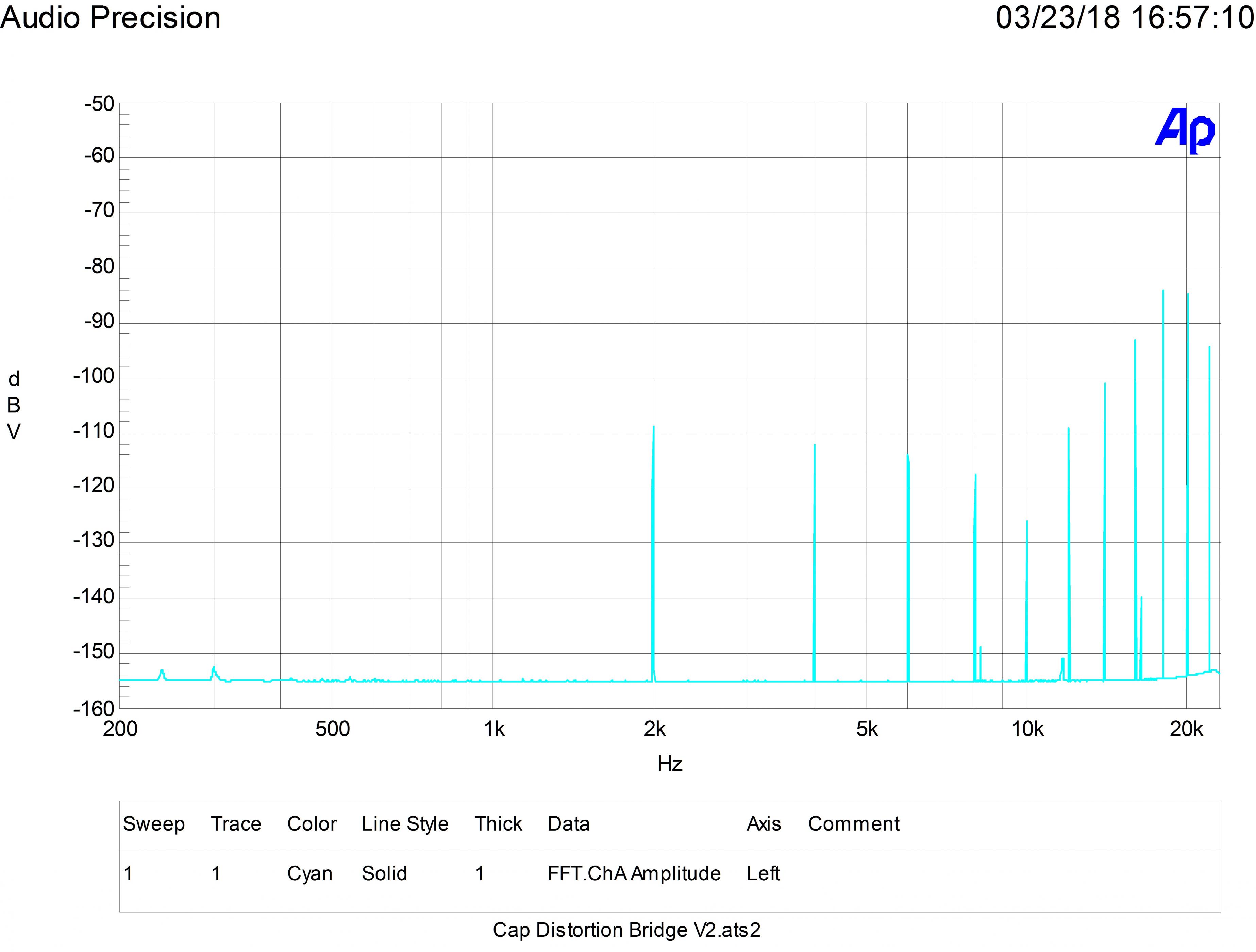

Now that I am almost caught up at work. I have started testing capacitors. The first using 1 uF 50-63 volt units in my 4/1-1/4 bridge at three frequencies (50,500 & 5,000 Hz.) and 18-20 KHz IMD.
TDK CGA5L2COGAH104J160AA 50V NPO .1 uF x 100 pieces sorted and matched for best balance as 1 uF per assemblage.
For those of us dense enough not to remember exactly what you mean by 4/1-1/4 bridge, can you post a napkin schematic?

Reason for -60dBv? It's quite low...
Fundamental is suppressed by the reasonably well matched bridge. It is actually 10 volts or +20dBv. voltage out of the matched bridge not surprisingly runs a millivolt or so.
Derfy, It is a classic 4 unit bridge with all legs having the same value. The technique is that two elements are composed of four capacitors in series parallel so the value stays the same but the voltage across each is 1/2. compared to the other two halves which are single capacitors. So 4 on top on the left to 1 on the bottom and the other side has 1 on top and 4 on the bottom.
And you're measuring differential voltage between the non driven legs of the bridge, I assume.
I have to run the math/spice it with nonideal capacitors, but don't intuitively see how this produces a more sensitive test. Or what exactly this measures in terms of part distortion.
