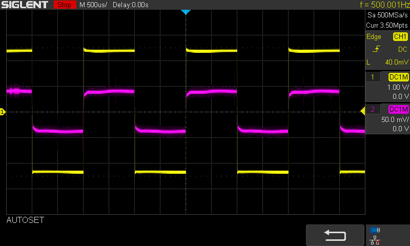

I have stated this and I would like (indeed appreciate) your thought on this: Make the amplifier produce the same current at all frequencies, that is EQ the current down to the Re of the driver.
It would look like this (same as in the previous post, but here it represents to Zobels for above 200 Hertz and an LCR for the Fs peak.
So there we have the two results, one equalised current and the other not.
Now let us put a square wave through it when current EQ is applied and see what it does on the current side of the amplifier (note I chose my words carefully there):
As you can see, this is 500Hz, but you can choose any frequency you like. Carefully adding elements to the EQ (or some would call conjugate) and you can get an even better result.
Now here is the question:
Driving that driver and varying the impedance from zero to infinity, both that square wave and the actual measured (but easily modelled in SoundEasy etc) acoustic response, will hardly change at all. The more perfect the EQ and the better the result will get. The output impedance of the amplifier effectively becomes cancelled out, and note I speak from the angle of the end result, not in absolute terms. But you can now drive that speaker. It also works if you have a crossover 2-Way and cancel out the effect of the amplifier's impedance. End result is good. The issue is also, why does it sound so good when you do this? This is what we are exploring.
Now for the second question:
Since the driver will also behave in a bi-directional manner, and we have seen agreements here that it produces volts, what will I see to the current of the amplifier if I was able to scream loudly into the speaker (at the front with the driver in a box). Make that scream a fairly constant note. Maybe even use a signal generator and produce another speaker putting a signal into our DUT. What would show up on our neat 500Hz square wave. Would it look the same?
I find myself intrigued to know your answer, I mean that genuinely. It is not a trick question, but one of exploration and what you would make of it?
-Joe R.
Joe, adding elements across the speaker to make the total amp load resistive does not change the current delivered to the driver.
Nor will it change the driver phase response.
If you purposely give the amp an excessively high output impedance, you just create a divider, and the driver true response will change. Without actual engineering, all you can do is play with tailoring of the speaker sound. Some may like the result, some may hate it. But you would be building a filter for the speaker.
Why do you not include driver phase in your plots, and why no square root of negative one?
Jn
JN,
Just to tweak you, yes adding the resistor does drop the loudspeaker driver current. Of course a bit due to the effective internal amplifier resistance (correctly impedance since it does vary with frequency.)
As this can in a well designed voltage amplifier with global feedback be as little as a few milliohms at low frequencies. Probably lost by the connecting wires' resistance.
I know that, I could have told you that too.
But it does change the current of the amplifier! That is significant.
Yep, knew that already.
Ahah! That would be the 'voltage model' explanation. Thevenin and all that, I get it, I used to think that way exactly too. That is the common explanation being used. When I tried to engage Earl Geddes on this, I couldn't get him past this point.
But there is another explanation. If we know that the dBSPL is proportional to the current (through the VC) and not the voltage, would not the correct view need to be explained by a 'current model' which might actually lead to a better understanding? Please don't take this as an insult, it is not meant to be. Just that I am realising that is often what is being misinterpreted here. It simply the question I asked myself. It is an important question to ask.
The saying goes, "follow the money" and in this instance "follow the current" can prove highly instructive. It has to me, explained things that going Thevenin could not. Wrote a private discussion paper. Then I have shared it on many occasions, gotten positive criticisms and great conversations. Everywhere it has been great, but can't have that here. That does make me wonder, why not here?
I could of course also have furnished the other plots, but it is not easily done instantly as I have to get the image, upload it via FTP, then find the full URL address for it to be found and link it on the page. Attachments don't work that well as you cannot insert it where you like. Whew! But I have them, I can assure you of that.
Here is the electrical phase of the driver in the previous post, after EQ is applied:
Red is the voltage source and Green is 200 Ohm, which simulates a current source nicely.
