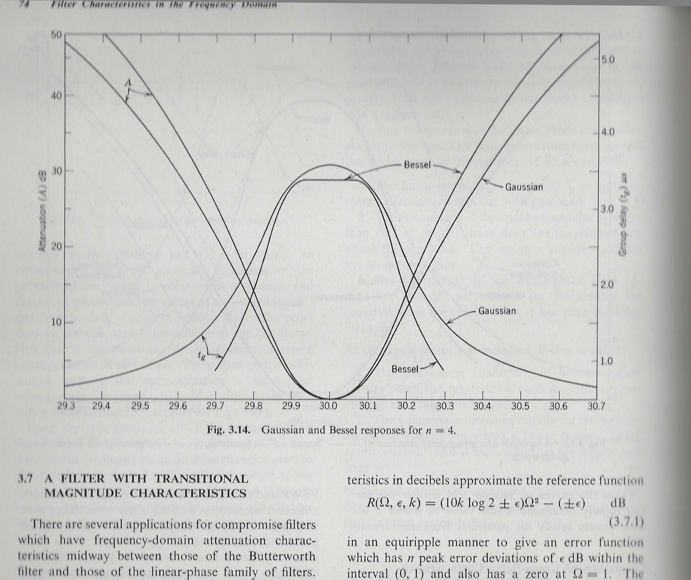

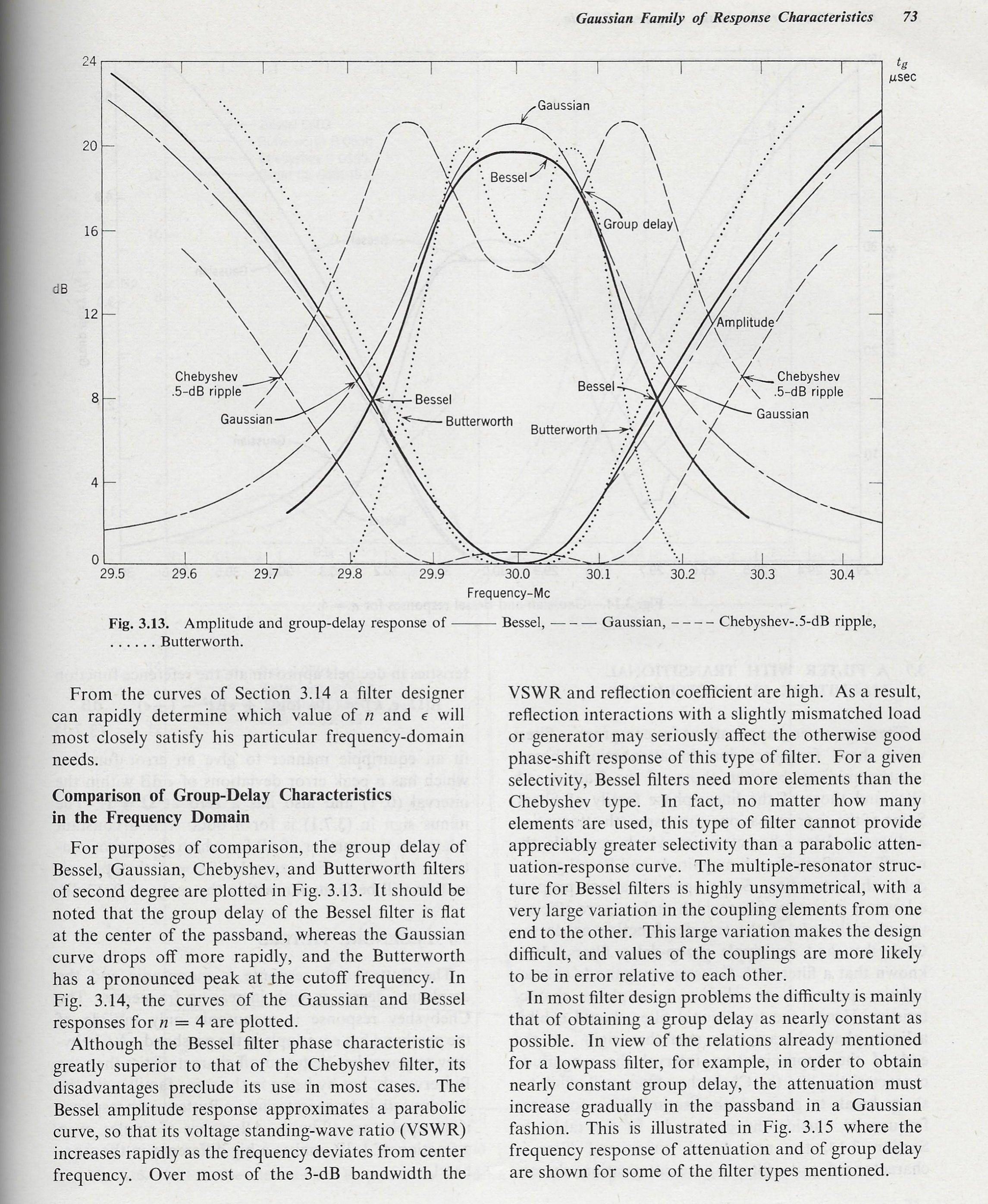

Attached are a couple of the graphs from the citation in post #1407 for your viewing pleasure.
Post Script - So much for steep slopes if we want to minimize group delay.
See left pic, last paragraph in the second column.
