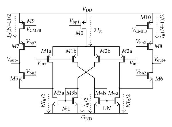

Here's a nice topology --- where would the cm signal be derived from on this circuit? VCMFB.
THx-RNMarsh
A poor question.
I will answer a much narrower, much better question: "From where would YOU derive the common mode signal, in this circuit?"
My own answer is: I would derive it from a little blob of a few CMOS transistors, the inputs to this little blob being Vout+, Vout-, and DesiredVcmReference. I would of course take advantage of the fact that nearby transistors on CMOS chips are well matched and, if necessary care is taken, extremely well matched.
From where would YOU derive the common mode signal?

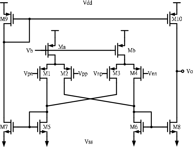

Have you tried a DDA in any circuits? Differential Difference Amplifier?
http://workshop.ee.technion.ac.il/upload/files/Shraga Kraus.pdf
http://shodhganga.inflibnet.ac.in/bitstream/10603/5652/8/08_chapter 3.pdf
THx-RNMarsh
file:///C:/Users/Richard/AppData/Local/Packages/Microsoft.MicrosoftEdge_8wekyb3d8bbwe/TempState/Downloads/1999.PDF
last one is a Current-mode feedback version of DDA.
THx-RNMarsh

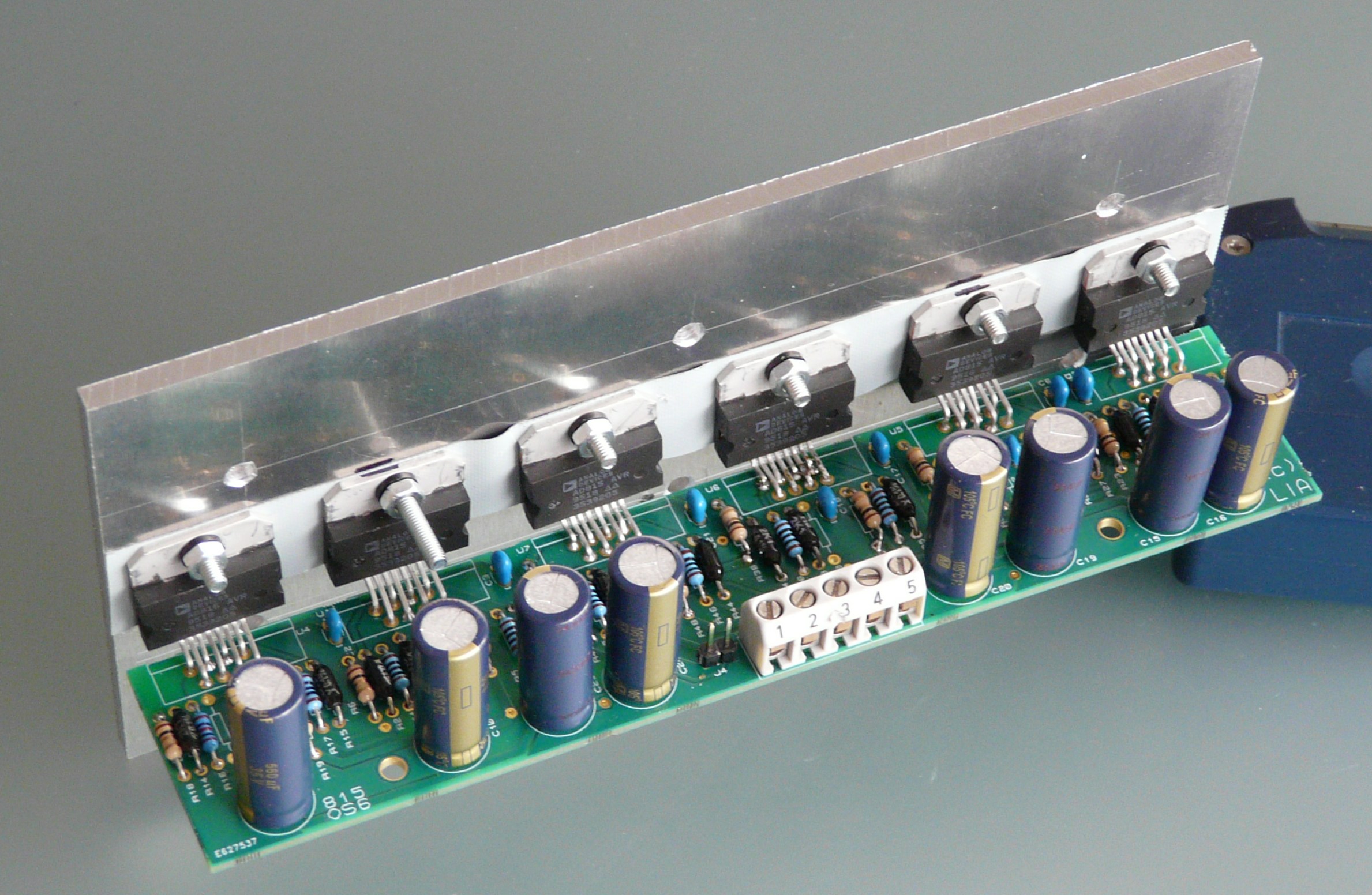

I have noticed that the latest Intersil smart power stages used in top PC motherboards are using a new QFN package with exposed thermal pads on both sides. Using the PCB as a heatsink is nice for cost saving but it's good to be able to mount the part directly to something. The newer ADSL drivers are thermally designed with the application's crest factor in mind I guess.
Yes. The problem is double.
Nulling the signal between an input and an output of an amplifier, as an example, request you have to attenuate the output in a ratio that have to be exactly the gain of the amplifier: not so easy, if you want to dig in <0.1% of distortion.
Professor, do you realize that the feedback 'automagically' adjusts the closed loop gain to minimize the effective input signal on the input pins to be just enough to support Vout through the open loop gain?
Jan
One wonders how hot the PCB will eventually get with all those thermal pad chips on the board. There must be a limit to that as well. In the end, it all has to be shed to ambient.

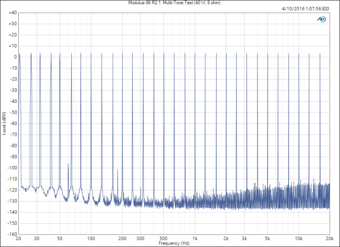

I've posted this before but here is said nasty chip amp running hard. As you can see it doesn't seem particularly bothered. At it's sweet spot of 40W, which is more than adequate for a lot of us it works very well. And is cheap to build and compact. It won't drive evil high end speakers, but for an active 2 way hard to do better in the same form factor.
