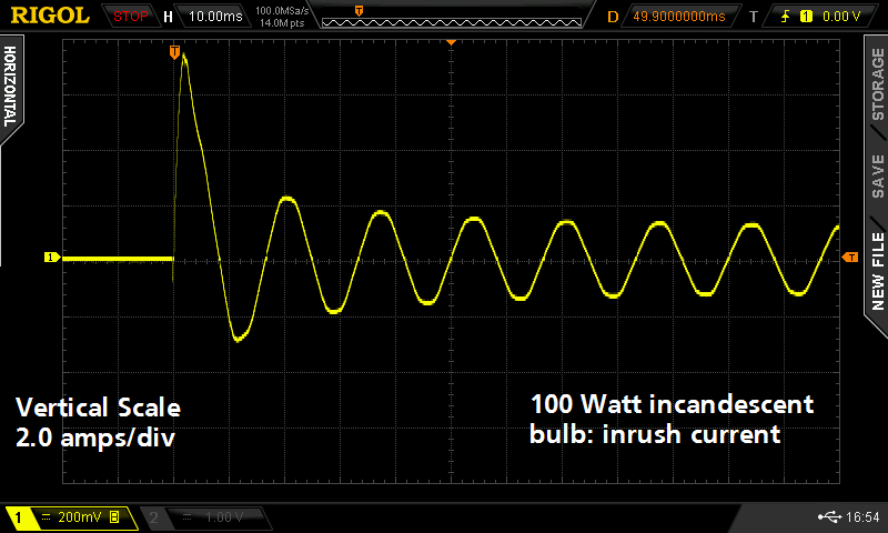

For John Curl:
Here's an early experiment on a simple test subject. It's a plain ordinary 100 Watt incandescent lightbulb, made by GE and sold for US applications (115VAC 60 Hz). Test performed in my workshop, with plain ordinary residential AC service, in the SF Bay area. There is quite a "long tail" on the current-vs-time waveform, probably because the bulb takes several seconds to come to thermal equilibrium. But for studying the initial turn-on current, a/k/a/ inrush, this sort of view seems helpful.
If you look really really closely and squint your eyes really hard, you can see the triac "pull in" and "drop out" points. But since a triac is not a relay, they use different terminology that I am too lethargic to look up at the moment.
_
