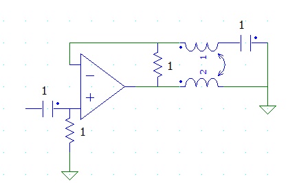

Like this ? :I was referring to the simpler method of just taking the feedback off
a secondary VC without the subtlety of your approach.

Your method would be great on an existing vc, assuming you had the extra room between the coil and the front plate. You would need to co-wind a teflon insulated wire with the 4 mil wire to create a uniform spacing, and remove the teflon wire after cure, or at least after set so you could smooth down the epoxy while it was still pliable but holding the 4 mil wire in place.
totally agree.Making a cylinder flex circuit would be quite expensive if you can even figure out how.
But then you also need to span the gaps with something with strength. Because the epoxy would not have good tensile strength, especially if it started getting hot.You could make an aluminium former in a spiral with maybe 4 turns. The output would be low but it may work. Connecting leadout wires would be a bitch.
As to soldering aluminum, man that is a PITA. If the ends were copper plated, maybe. But definitely not worth the effort.
As to 4 turns/low output...the whole idea of nesting is to make the exact same coil so there was no additional signal processing needed at the amp. Just a second wire pair (coax or twisted pair), a connector, and a resistor into the feedback loop.
Setting the bypass resistor from the output to the feedback means that the amplifier can be designed to work on a speaker with no dvc feedback, but if the owner wanted to, just run the connector and second wire to the speaker, the amplifier would automatically operate in the newfangled mode.
We're talking about a field modification that would take less than half an hour. Break the fb loop, add a resistor, add a connector, solder the wires from connector to the fb/ground.

Thanks for the clarification, now I got it, basically, that is 🙂Ps.. Note their reference to the pickup voltage being velocity dependent. They then have to filter it.
My scheme is not velocity dependent at all. All the velocity information picked up by coil 2 is subtracted from coil 1. The information remaining is only the real component to the drive signal, only signal that is in phase with the voltage.
Jn
So, we subtract the velocity voltage (a copy of it, via coil 2) from the total coil voltage of coil 1, resulting in the voltage actually impressed on the transfer impedance which makes a driving current from the voltage accross it, after all.
This would still give nonlinearities in the current as it isn't a stable impedance. If we regulate upon this voltage we'd still have some similar errors terms as with standard voltage drive but we would have an SPL transfer curve (and damping characteristic) that is almost equivalent to current drive as net effect is the same: the output current isn't measured explicitly but still we have a close equivalent of it in form of a voltage needed to develop accross the quasi-constant transfer impedance and which is measured by cancelling out the velocity terms. Which results in the same behavior as current drive to first order but with probably higher distortion?
Where is the actual benefit, what am I missing?
If they are wound front to back, they will not see the same coil inductance through all positions. They will be opposite, so Le nonlinearity would not be compensated. If they are bifilar, that will work but you have double the mass or half the turns of the volume for drive.What's wrong with the 2'nd coil on a DVC driver ?
The Le is dependent on position. As it increases, the magnetic field sucks in energy from the vc. As it returns, the energy returns to the vc. That non linearity is seen by a co-wound coil exactly as the drive coil. So all non liearities attributed to magnetic stuff is read exactly by the pickup coil and subtracted.Thanks for the clarification, now I got it, basically, that is 🙂
What remains it the exact voltage component that is in phase with the drive voltage. So in essence, yes we are pretty much driving as if it were a current mode. But with compensation of magnetic non linearities.
So what for an initial ' 1rst order approximation ' to see if it works at all ?

Bingo! Except for Bl(x) and final Bl drop when the coil leaves the gap as you've mentioned. Are there other non-corrected terms, for example does it really also cancel the reluctance force (as per Klippel's definition)? Reluctance force isn't addressed by current drive so if your approach did that additionally could make it favourable to current drive. Thermal issues wouldn't be addressed though, right?So in essence, yes we are pretty much driving as if it were a current mode. But with compensation of magnetic non linearities.
Dead on. It doesn't worry about BL(x) and final drop.
I'll look up Klippels reluctance force, I may have covered it but it's best to be sure..
And, no, thermal issues are not addressed. In fact, my setup also will suffer power compression as I'm not compensating the dc resistance at all.
He defines reluctance force as relating to dL/dt time current squared, which is interesting as it appears to be units of "energy per unit time".
Oh, Yes, mine does. from the eq V = L dI/dt + I dL/dt. The second term is what I believe he is referring to in his reluctance force. I subtract that out, as the voltage that is superimposed on the drive coil from that is entirely dependent on the flux going through the loop, and the pickup has the exact same flux. So it should be automatically cancelled.

Frequency dependent Le will be compensated?
Yes. For bifilar and co-wound, anything related to flux that can be measured on the drive coil will exist on the pickup.
