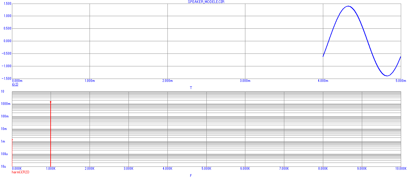

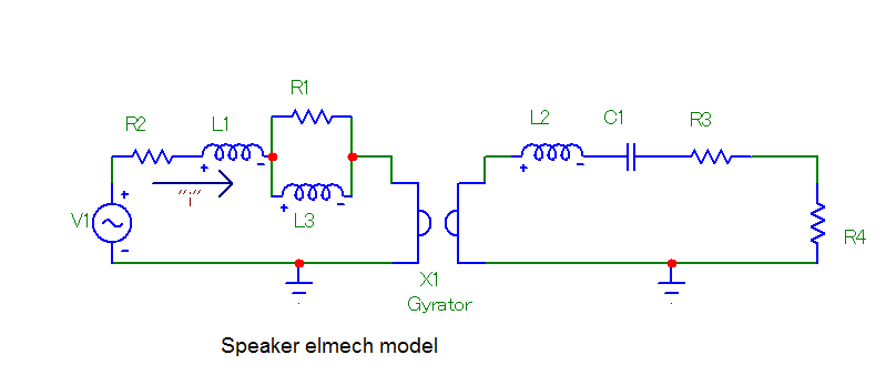

What I am pointing out is that (and the idea is getting traction) is that the reduction in distortion under current drive is because the amplifier cannot produce reactive current. But under voltage drive, the amplifier readily produces reactive current. So the increased distortion we see (and the measurement can easily be repeated) is due to amplifier reactive current drawn by the back-EMF impedance of the driver.
Sorry, completely wrong. It is the complex load nonlinearity that creates the distortion seen. In case of linear complex load, there is no distortion - attached. "Back EMF" view is a nonsense.

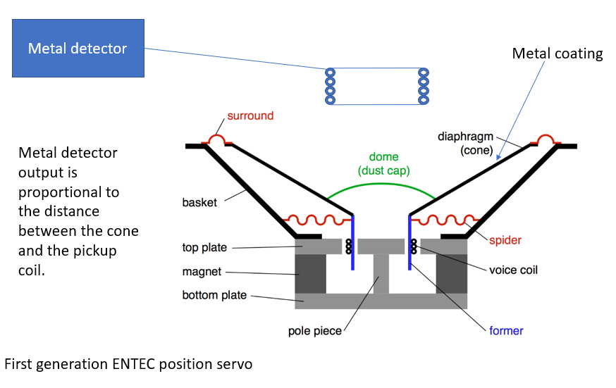

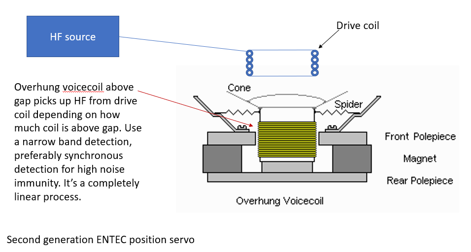

As I promised earlier, position servos. Both easier and cheaper than the Renishaw encoders. Also with digital encoders you will have some challenges with delays and finding the rest point. Keyance also has encoder/position sensing solutions. They work to pretty high frequencies. And for something like a speaker these are a possibility: Vibration Sensors & Probes | Fiber Optic MTI 2100 Fotonic Sensor | Ultrasonic Transducers (I have a couple and they work pretty well to above 20 KHz but not easily implemented in a speaker. However. . .)
Attached are two position servo solutions I have used commercially. Both work. As John has said implementation is not trivial.
The first uses a metal detector to sense the metallized cone. Its output is proportional to the distance from the metal. It also works with metal voice coil formers. However it can be sensitive to various noise sources.
The second uses a coil to create an ultrasonic magnetic field around the voice coil. A detection circuit measures how much of the ultrasonic field is picked up by the voice coil above the gap. The gap acts as a shield preventing the coil below the gap from picking up the field so the HF on the coil is directly proportional to the position (or projection) of the voice coil. Its distantly related to an LVDT, linear variable differential transformer, LVDT Tutorial | LVDT Basics - What is an LVDT | TE Connectivity which would also work but much harder to implement in a speaker.

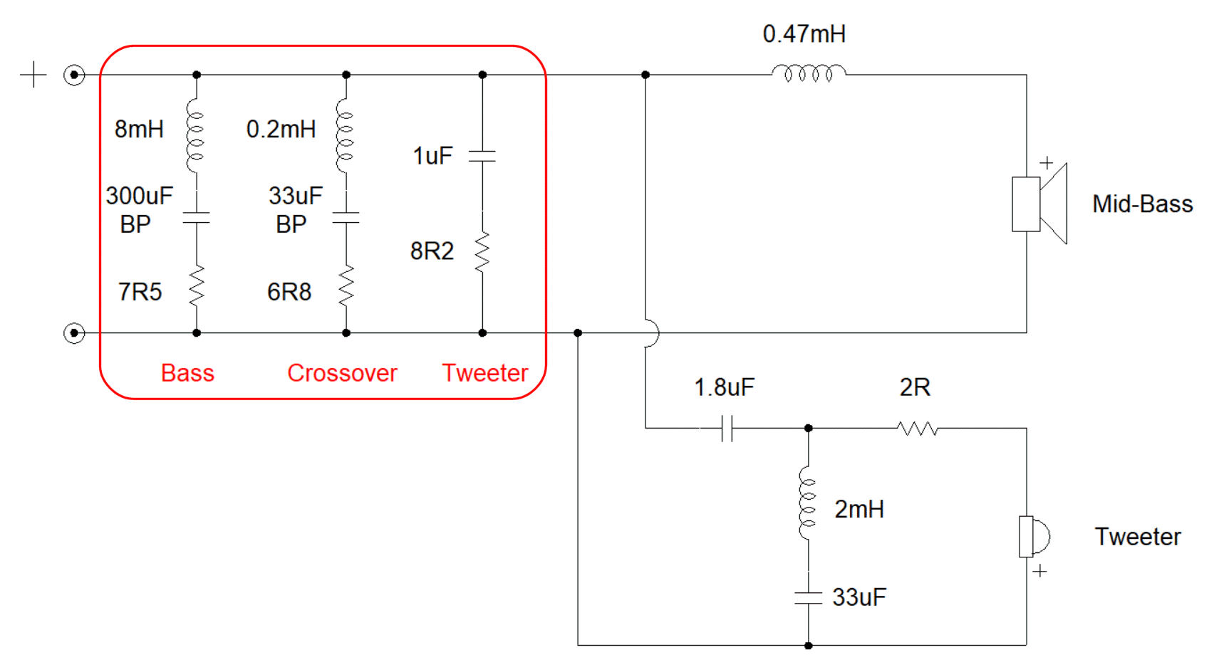

Please see attacments below.
EL-6: DIY speakers.
EL-6 Voltage (yellow) versus Current (purple) of the amplifier when driving EL6 speakers.
EL6: FR using Current drive (green) versus Voltage drive (Red).
EL6: EQ of Vented Bass alignment, but Sealed alignment can be made better still.
Note that when forcing the amplifier to produce the same current at all frequencies, the output impedance effectively becomes cancelled out. Even the crossover no longer needs to see a zero Ohm impedance. On the surface, as Scott alluded to, the explanation is a la Thevenin (a voltage model), but a closer look this is purely about how the current is dealt with and gives a much more clearer picture.
Final attachment: What a typical 2-Way crossover and EQ might look like.
