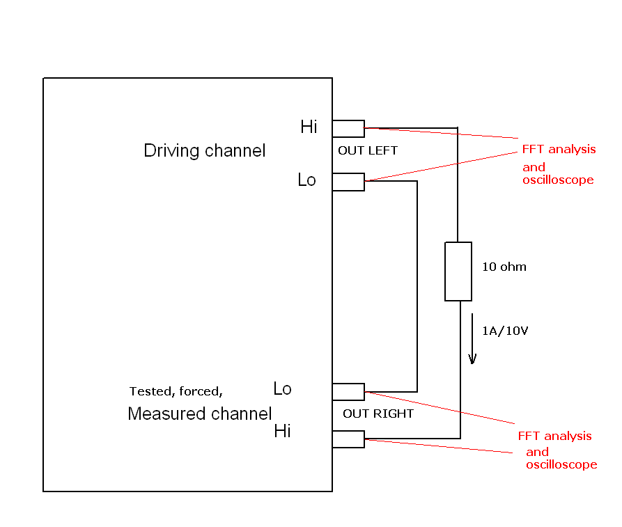

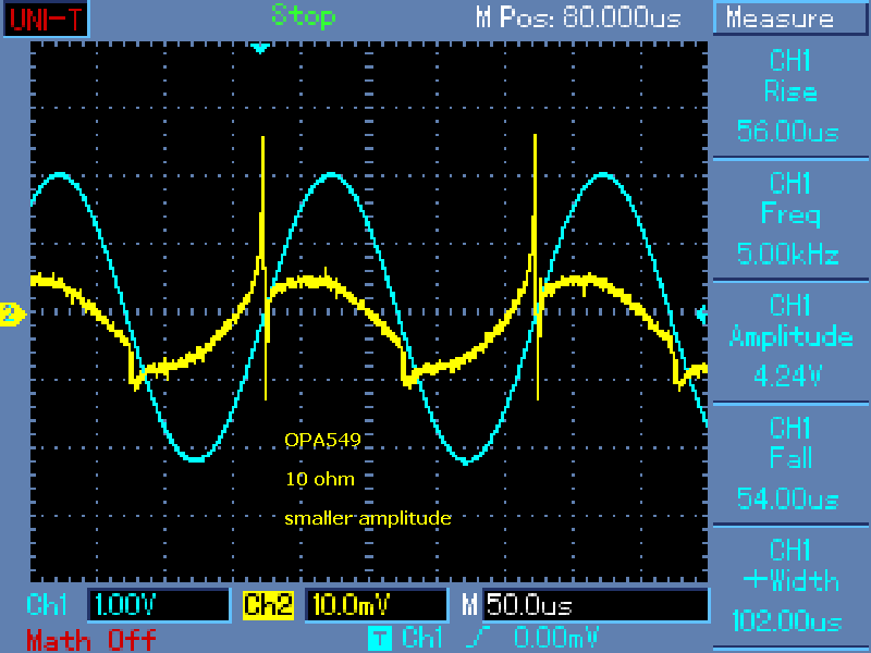

This can be easily found by forcing current to the amp output. Avoid power chipamps and underbiased class AB.
George, feedback reduced the issue, but did not cure it completely.
This is probably happening because as the amp under test passes through zero, the devices are 'almost off' and will actually be off in an under biased class AB amplifier. So, during this period, there is notging sinking the driving amp output current, so it spikes up or down.
If you increase the feedback, the dead zone will narrow - decrease feedback it should open up.
If you decreased the amplifier gain, the loop gain would increase, and the spiking across would decrease.
One of the following days, I’ll mod a chip amp for variable gain and try to see if I can repeat that misbehavior.
