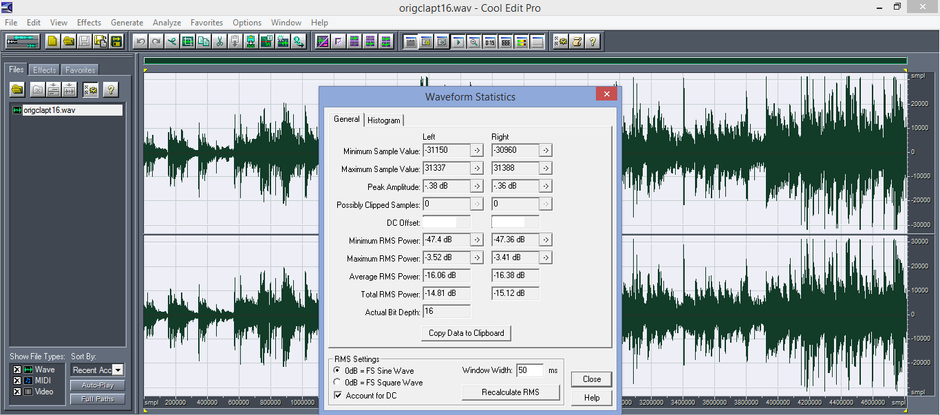

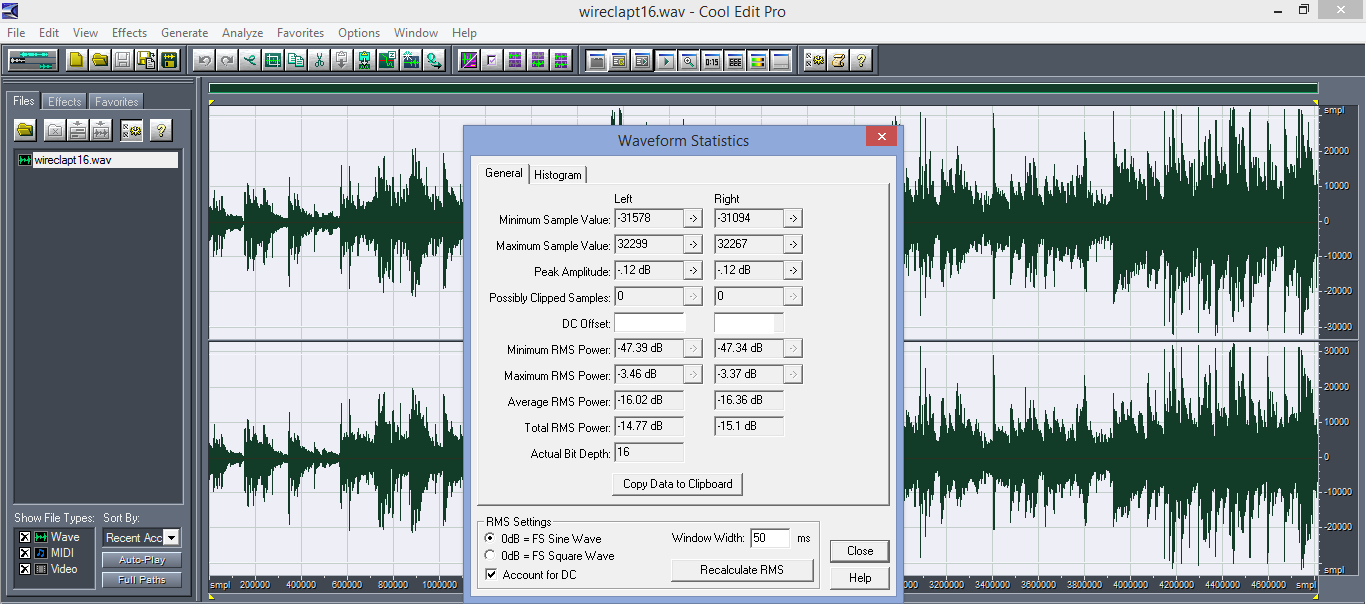

Thank you for posting your analysis, George. I will post mine as well, but it is good to have yours as an independent one.
You are welcome Pavel.
Note: Some differences in min, max RMS Power btn mine and Pavel’s statistics is due to a different setting of analysis settings. Pavel’s is at 50ms (Window Width), mine is at 1ms (Resolution). If I set mine to 50ms too, differences are at the second decimal point.
I’ve already said that the amp Pavel used does not change the dynamic range of the signal.
I have asked myself a relevant question though on this point.
When I am to arrange such a comparative test: In case one of the DUTs changes the dynamic range appreciably (>1-2dB), either due to increased noise floor or due to smooth compression of the high level peaks or both, what instrument reading should I use for to level equalize the two files (target is equal perceived level of loudness)?
Peak hold, VU peak, average RMS power?
George
I think you hit the point, George - the amp should not change the dynamics of the recording and also should not audibly increase the noise level of the recording.
And you are asking a good question - unfortunately I am not able to give you similarly good answer 😉.
