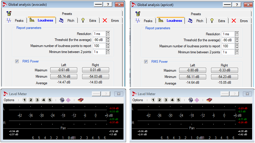

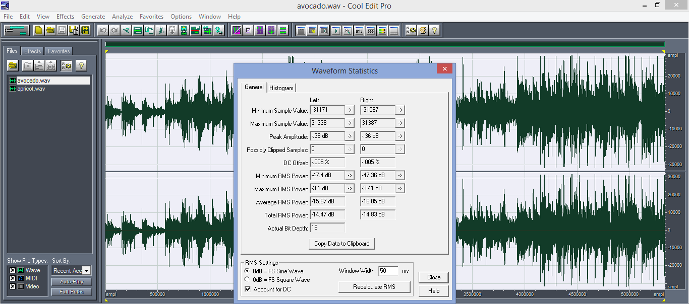

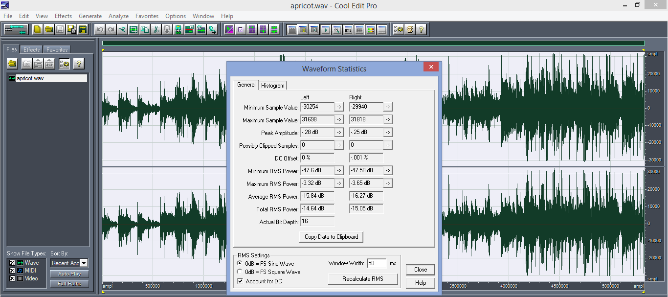

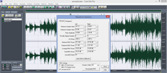

In terms of level balancing, you have done a great job. Plus the amp does not change the dynamic range of the signal (<0.2dB)
I already described it in sufficient detail for anyone interested to implement - please reread a couple of posts back
Is this one?
The use of some form of hidden controls, as recommended in ITU guidelines, is one possibility to ascertain is the participant sensitive to a certain level of known audible difference - for instance in one or more of the 16 trials of an ABX test, B could be an exact copy of A except that it has been adjusted by 1dB (or whatever is deemed appropriate) & if X is not identified correctly as A or B then we have an indication of false negative for this particular type of difference - does it generalize to lack of sensitivity to other small impairments? More than one trial & more than one run of ABX would be needed to evaluate the sensitivity of the participant/test to small impairments. Volume level is just one suggestion, easy to implement, to act as a hidden control - other differences are possible & other approaches have been suggested in the past
George
Is this one?
George
Thank you for posting your analysis, George. I will post mine as well, but it is good to have yours as an independent one.
However, I do not think it is a technical point or real test parameters that are attacked. It is the ABX itself, by those who do not like the protocol. I understand it, but if I have a choice between technically well performed ABX and a sighted test, I would vote for the ABX. Further, where is the proof that the parameters like level equalization within 0.2dB were fulfilled in the sighted test? That would be my question to the oponnents.
Below 0.3 dB it gets more and more difficult and that´s usually the region where imE all listeners only notice the sound difference but not the level difference as such.
So using level difference at different niveaus even allows to monitor the effect of training.
As you know well, level difference is not only a result of "volume control setting", but it is however a quite complex result of frequency response and non-linearities as well. As a non-linearity in my DUT goes up to 1%, it affects the "level" as well, should it be a peak level, peak rms, avg rms and min/max rms. Please check the file stats I have shown in my previous post.
However, we still have a "null" ABX result, so we should not blame the result to a "poor" 0.2dB level matching.

Oh, I see. In a test setup itself, the level difference is verified to be in order of 0.01dB. Less than 0.1dB. Now, please tell me why you ask, if there has been no positive ABX protocol yet?. In case there are positive results, I understand there is a reason of being suspicious to the level difference only. I still have a strong feeling there is a reluctance to the ABX method itself, rather than to real technical issues. Seems to me as a substitute issue.
