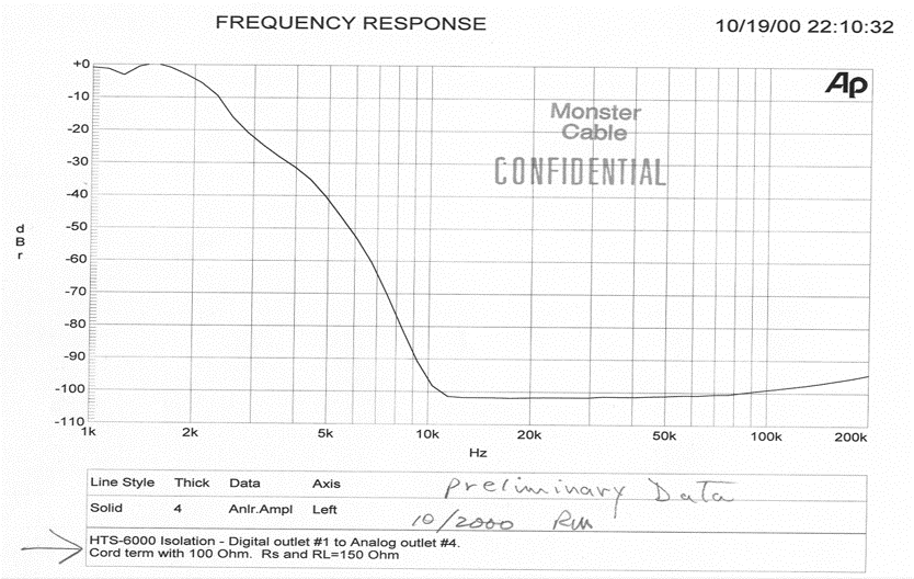

Rather than trying to modify each and every equipment's PS, Mark used this filter on his DAC --->
View attachment TAA 4-15.pdf
Attenuation starts at 548Hz (-6dB) and the scale is 10dB/div. The atten far exceeds -100db (10KHz) range of instrument. Out to 10MHz the atten is still -60dB.
Since this is passive filter, the unwanted freqs/noise on the ac line is blocked from the DAC and anything from the DAC is prevented from getting onto the ac line.
This was going to be an article in Linear Audio. but that pub is no more... too late. Oh, well.
THx-RNMarsh

You can get similar results from the Monster -7000 unit available now on e-Bay. Best deal of the century and backed by real science and engineering.
Yes they ground isolate and to -100db from port to port.
Enjoy
THx-Richard

Just wait.... I have seen them all over the map. 250 sometimes. >1000 sometimes. I recently bought one and I paid $450. "free" shipping. Works fine. Looks like new. I am going thru my storage... I might find one there
If it helps to know.... the 2 transformers cost me 100 $ each - mfr cost. From China. very special. Not an off-the-shelf item. Similar to a Topaz Ultra-Isolation transformer. Several mfr tried to make them for me to my spec. Only one mfr could do it well enough.
This is prototype isolation…. dont remember - think final version is much better.
You also get significant, sag, surge and transient line protection. D.Martin had primary responsibility for that portion of the design.
All power conditioners passed thorough UL testing.
THx-Richard
