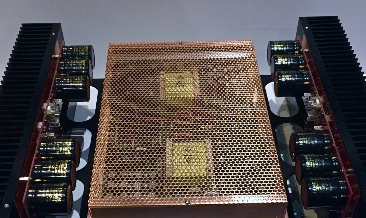

They connect the RCA shell right to the chassis too by the looks of it. How ever will they let the RF in? They need to contact Lampizator to figure out how to do it right. 😛
