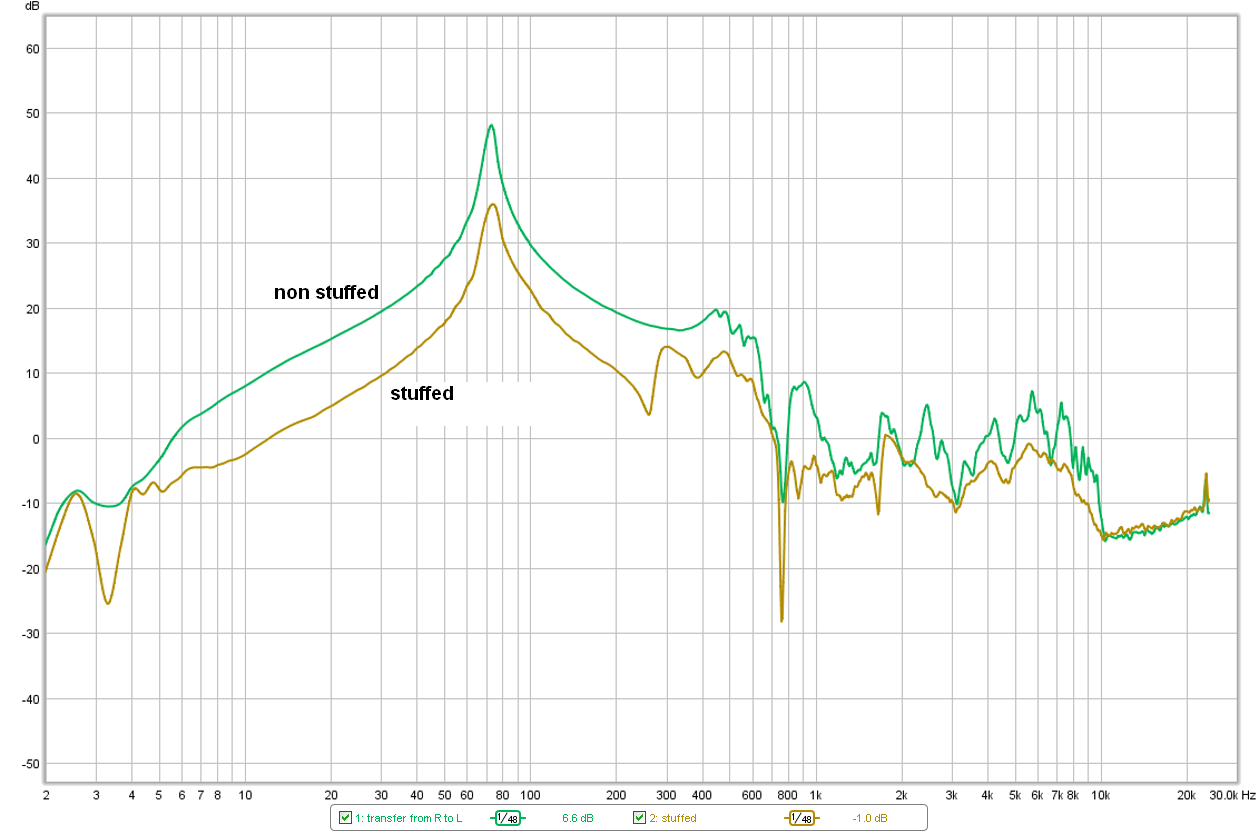

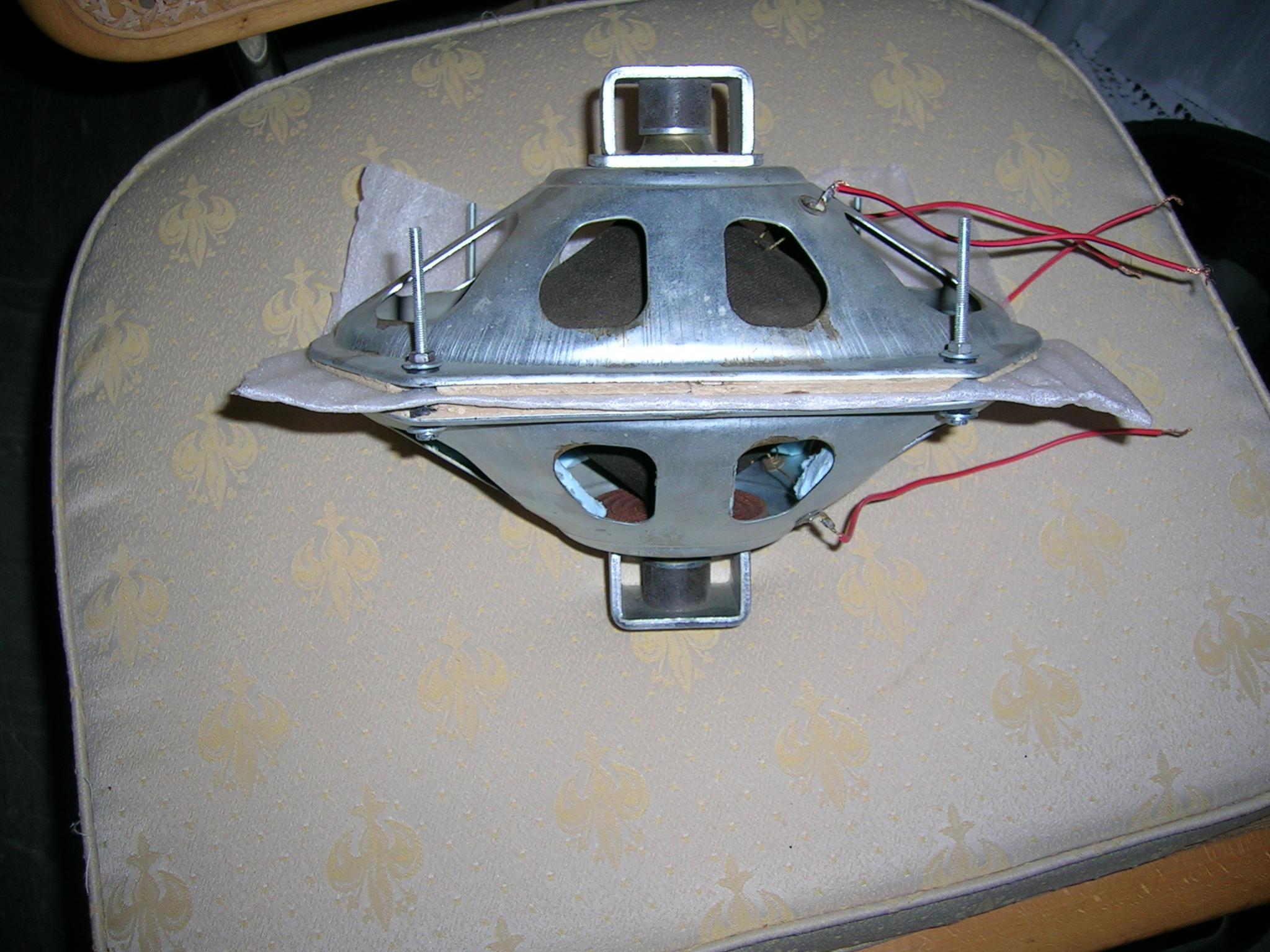

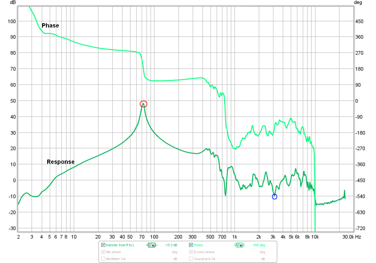

gpapag, I wanted to say this sooner but if you use one driver to drive another, I suggest you add a lot of mass to the master driver, as it's variable electrical damping may contaminate the measurement.
As is now (no added mass, no fibreglass in between), close acoustic coupling of these two drivers has this transfer function.
I think of using driving LF signal at 73Hz (resonance) and 3100Hz HF at the monitored driver
George

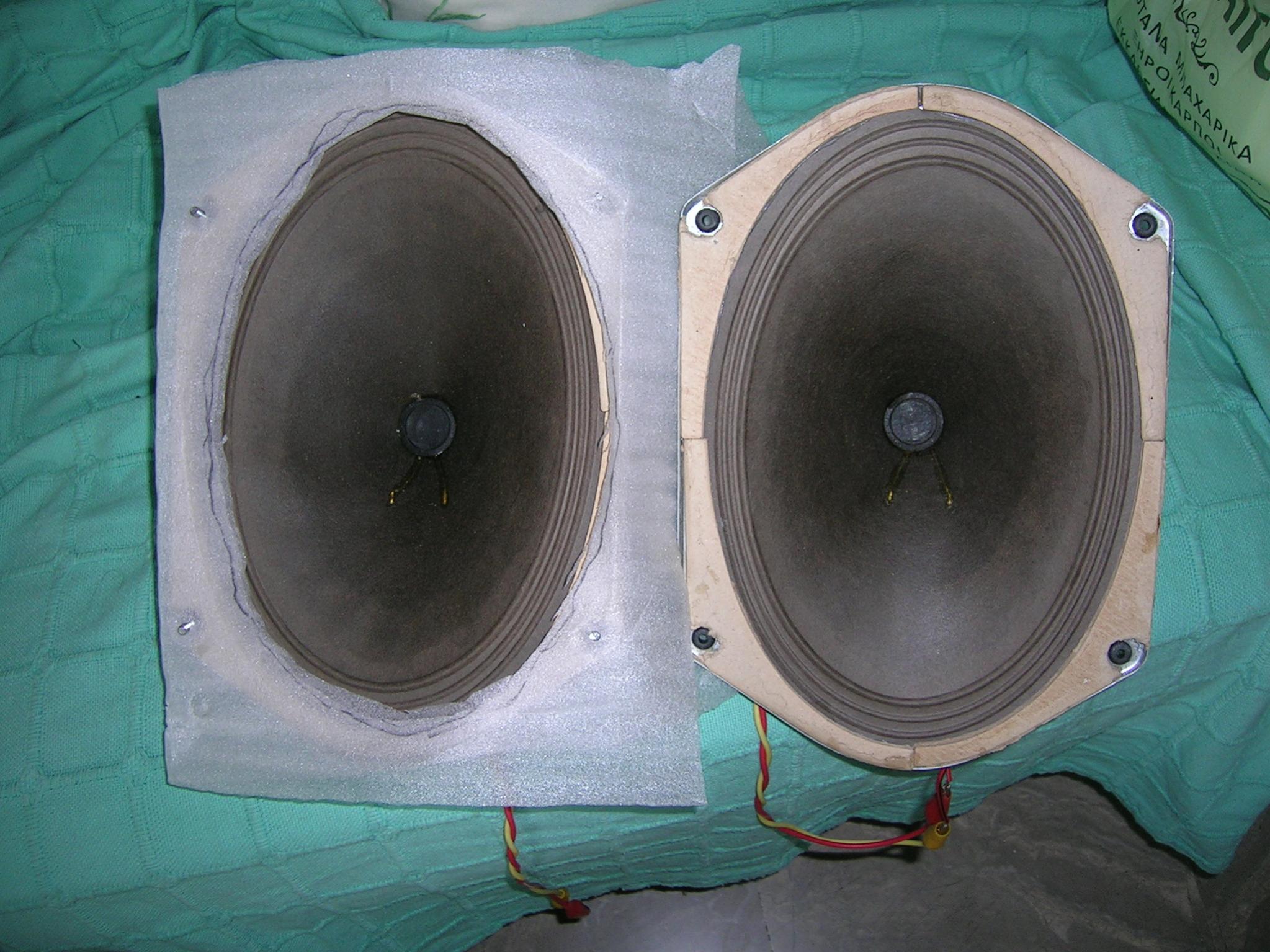

Hmm. I thought the idea was to connect the cones with a shaft of some sort and drive them directly. I would think the other driver's behavior will be less important with air coupling though.

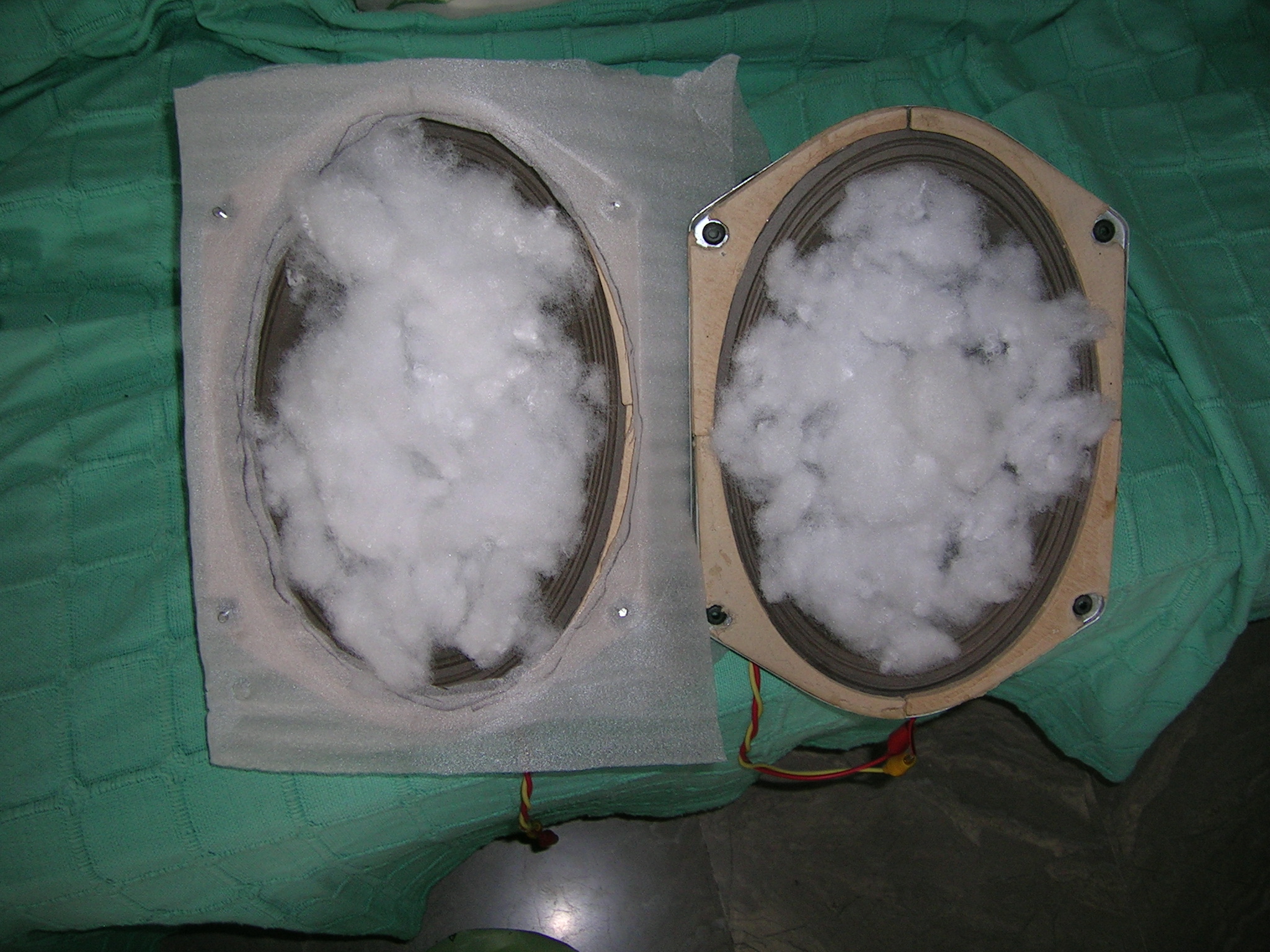

It would probably be better to have them coupled through a box that was stuffed with old socks, then you don't have to contend with reflections affecting the coupling between cones. But then again, what do I know. I guess you had the idea of putting a sheet of cloth or or something between them?

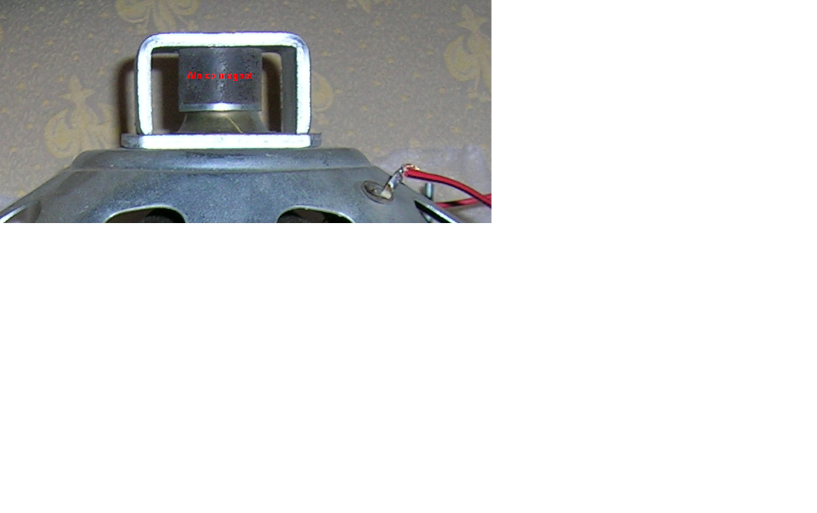

BTW, what is the deal with that EI core like magnet structure I see on older speakers? It is good, bad, ugly?
Easy to compare how behaves as a microphone at low frequency and 10kHz the speaker that drives the other. Don't forget it is powered by an amplfier, so hightly damped by its low ouput impedance for reflexions of the 10 KHz. And we don't care, anyway, this speaker is only here to make the menbrane of the one we measure moving at low frequency, while we measure what's happens at 10KHz.It would probably be better to have them coupled through a box
I am not sure the resonnance frequency of the assembly is the best choice for the low frequency: we want maximum excursion and maximum coupling (IE very low frequency), we don't care about maximum acoustic power.
Well, I thought of starting with the easy to do/no damage acoustic coupling and see how it goes.
Next step, stuffing the area btn cones with pillow filling material.
The construction you see was common for small wide band alnico magnet drivers. It worked well (a common problem after many years and some bad handling is mechanical position shifting of the alnico barrel. Coil rubs or stucks.)
I am not sure the resonance frequency of the assembly is the best choice for the low frequency: we want maximum excursion and maximum coupling (IE very low frequency), we don't care about maximum acoustic power.
I would prefer to use lower freq but I am afraid at very low frequences (1-10Hz) there will be increased pressure leakage, thus not maximum coupling (I may be wrong though.
Yes. In these measurements here, the driving source has an Ro of 150 Ohm
