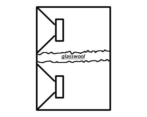

An other more simple solution that do not put any risk on the drivers should be to use a little closed box with the two speakers mounted on -it. Air pressure will be sufficient to couple the two drivers at 50Hz and will have quasi null influence at 10 000 ?This I can do. The low freq can be very low, so there will be enough of HF content within one LF cycle to analyse

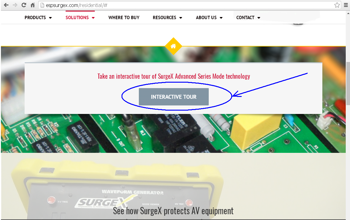

Surge-X is a company/product that arises out of the work of Neil Muncy and Jim Brown. Very accomplished and knowledgeable about mains problems.
It shows
Residential – AMETEK | ESP | SurgeX

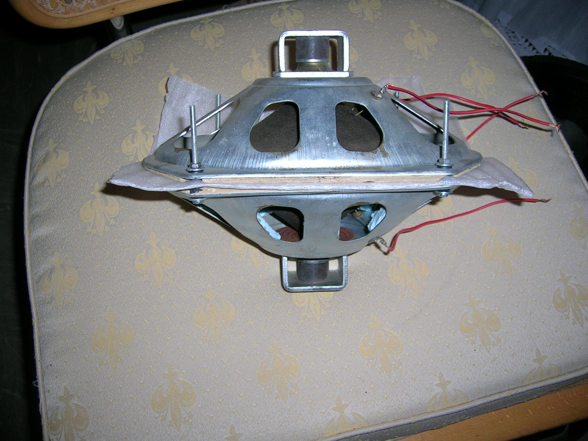

I had this at the back of my mind, as I have two acoustically coupled left from another test. But the space between is minimal, and acoustic coupling will be effective at higher frequencies too. I’ll check it.
Thanks again
George

I have 132 4 inch drivers uncommitted. I was thinking about attaching two of them at ends of a sonotube or pvc about a foot long to remove magnetic interaction (perhaps a copper screen in the middle as well. Well sealed, I can use one to drive the second acoustically. Then input the test signal in the second, and monitor the distortion of the V/I space. Or, do a spectrum analysis of the current drawn by the second.
