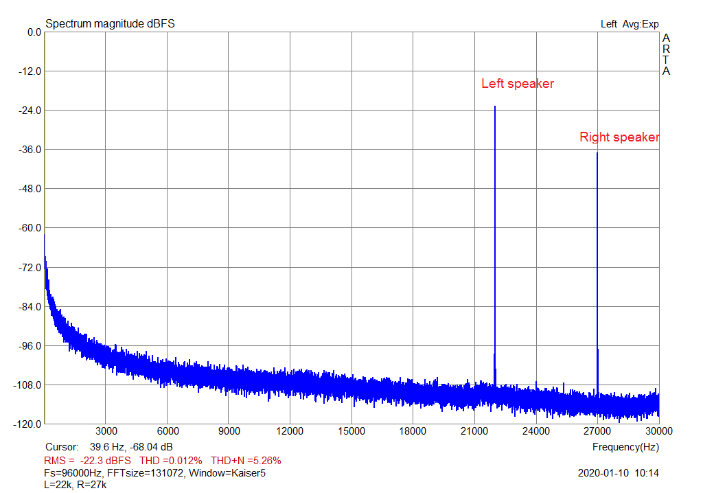

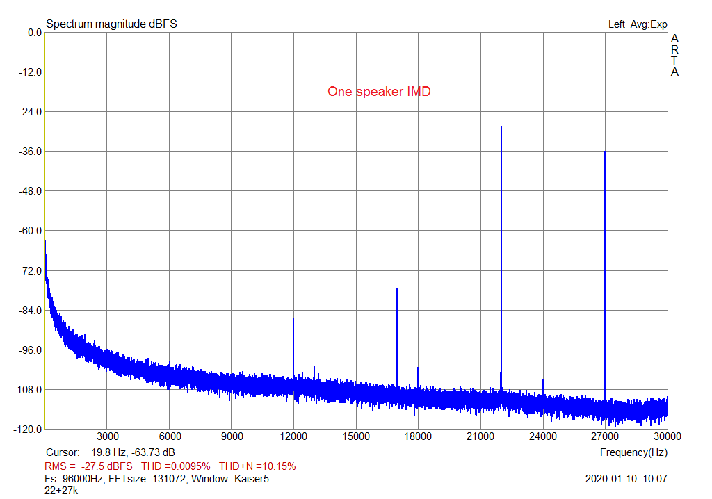

The problem is, my dear Jakob, that I can easily demonstrate that it is the speaker that creates IM. The amp IM is about 50dB better than that of the speaker.
2 plots, one with L channel playing 22kHz and R channel 27kHz. This shows that microphone is clean and does not create distortion.
2nd plot, one speaker plays 22+27kHz tones and we can see IMD products in audio band.
Dear Jakob, this is the issue that Oohashi did not take into account. He should have used 2 speakers instead of one, one for ultrasound, one for <20kHz programme.
The audibility is questionable. Yes in case of quiet environment and not too far from speakers. Probably not if masked by music programme.
Those levels will be quit audible with music... rarely will there be only 2 freqs. A lot of HF freq are there. From imperfect LPF from CD player.
