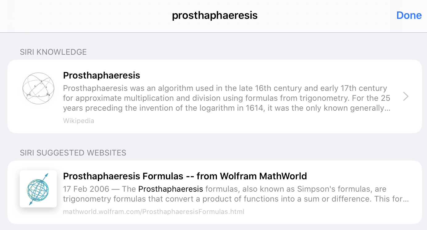

Thank you for a new word, prosthaphaeresis. I will note the Fourier spectra of both sides of the equation must be the same. The right side is done by convolution (product) and since the difference between the sine and cos is simply a sign flip of the negative frequency there is cancellation leaving the same two original lines. There are no new frequencies via the trig argument.
BTW - I prefer Euler's formula for trig stuff.
Where do you come up with these multisyllabic words???

Aside: weirdly enough, these product identities were used before logarithms were invented in order to perform multiplication. Here’s how you could use the second one. If you want to multiply x times y, use a table to look up the angle α whose cosine is x and the angle β whose cosine is y. Look up the cosines of the sum α + β. and the difference α – β. Average those two cosines. You get the product xy! Three table look-ups, and computing a sum, a difference, and an average rather than one multiplication. Tycho Brahe (1546–1601), among others, used this algorithm known as prosthaphaeresis.
