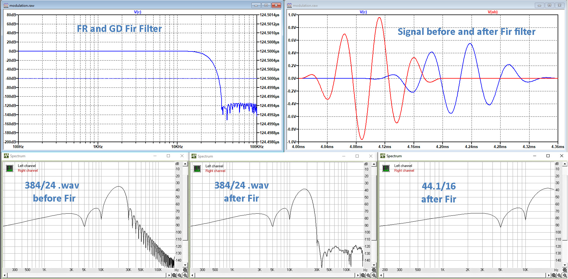

OK, here we go.
Summary:
- The FIR from the filter toolbox is basically fine while not high precision, and with Hans's parameters it doesn't do any brickwalling, rather a soft-knee shallow-slope response -- "gaussian pulse shaping" the docs say for the "FIR2" type, and the compromised performance is noted as well.
- the brickwalling is actually done by LTspice during output file saving, probably a crude resampling and that is what corrupts the signal spectrum.
Fully separated from the ongoing discussion that doesn't have my attention, I have the impression that we did not do precisely the same.
Shown below is the FR and GD of the Fir filter that I used and as mentioned before 'not exactly a brick wall filter', but the best I could get in LTSpice with a constant GD for a "quick and dirty test".
But what a difference from your FR ?
The second image shows the output signal of the filter, still completely analogue without any of the staircase-steps that you showed ?
And brickwalling while saving is not what ever happened.
I just made .wav files from the analogue in- and output and played them back in RMAA, because LTSpice makes a mess of displaying a .wav file.
See the 3 RMAA files below.
So in my LTSpice sim I did not do any (re-)sampling, I just made a 44.1/16 .wav file from an analogue signal that was Fir filtered, a thing that LTSpice can do very well.
A proper brickwall as in Audition will of course get much more accurate results.
- spectrum as analyzed by Audition looks the same (except the missing 44.1 brickwalling), a slowly increasing drop of magnitude at high frequencies.
The quick and dirty job was seemingly informative enough after all.
See comparison of original filter output @384k (red), a precision resampling to 44.1k and back with Audition(yellow), and the 44.1k LTspice output upsampled to 384k with Audition (blue). LTspice corrupts the output quite a bit. It has additional droop below 20k and the spectrum looks deformed overall (notches don't match, etc).
Your upsampled spectrum to 384K is probably screwed-up because of doing something wrong in LTSpice.
Hans

Hans, thank you again.
Note that your filter output also has a longer carrier wavelength, and is rather consistent with the spectrum plots.
If you overlap input and output, they are again, not the same.
jn

The proof is in the pudding. Both Hans and KSTR have now provided exactly the same evidence.
The carrier is shifted in frequency away from the initial one.
jn
It isn't, and any filter cannot change that. You are still mistaking the peak magnitude point of the filtered response as the point where the carrier freq is situated, which is only true when no additional EQ is present, obviously. With EQ, the peak point in the spectrum does shift but the carrier and the sideband frequencies are not changed. In a single cycle of raised cosine window the components have widespread leakage, in the periodic equivalent we see distinct lines at 20k carrier and 15/25kHz lower sidebands and that picture doesn't change when additional EQ is applied to this.
