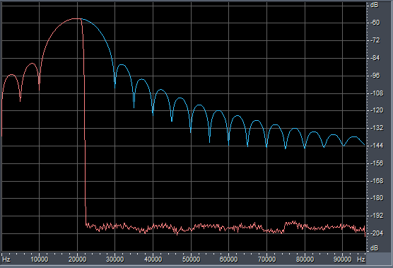

Why did the 20k shift, yet the 5k and 10k notches are dead on. I first thought simple time scale error on the waveform plots, but that would have shifted the spectral notches as well.
A 5k modulated 20 k sine should not get through that filter unscathed due to upper side bands, and clearly it didn't. The surprise is it appears to be frequency shift. I also didn't see that coming.

That's just the droop of Hans' filter. With a steep brickwall the spectra are exactly identical to beyond 20kHz.A 5k modulated 20 k sine should not get through that filter unscathed due to upper side bands, and clearly it didn't. The surprise is it appears to be frequency shift. I also didn't see that coming.
The filtered version has a lot of time-domain ringing from the steep filter (symmmetrical, as it was lin-phase as built in into Adobe Audition's resampler), but the "effective envelope" is exactly the same.
And by the way, the test signal is not 20kHz modulated by 5kHz sine, rather the modulation/window is one period of a *raised cosine* of 5kHz, which is something completely different, sin(x) is not 1+cos(x)/2.
