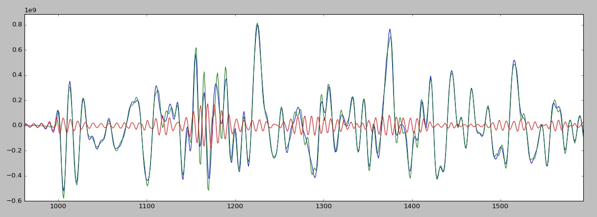

Wouldn't it just be easier to just subtract the blue and green and show the difference on a plot of the same timeframe?
Here the difference (red) seems to be mostly at the Gibbs frequency, probably a whole new can of worms.

If you examine the two waveforms scott put up, the unfiltered green on occasion has roughly 20% higher peaks than the blue filtered, but they are of the same form. If the difference is of the same shape of the blue in time, then it is a simple reduction in envelope.
I am not referencing the criteria of audibility by threshold nor by listening tests.
If the difference is just a fraction of the blue and of the same waveshape, it would be a smoking gun saying that the upper sideband removal also altered the audible waveform coming out of the filter.

Those wave forms are inconsistent. The first few cycles match very closely, once the dc offset is gone. Then in the middle with aproximatley the same freq. and amplitude they are out 20%. Whats with that.

Except it explains it?Here the difference (red) seems to be mostly at the Gibbs frequency, probably a whole new can of worms.

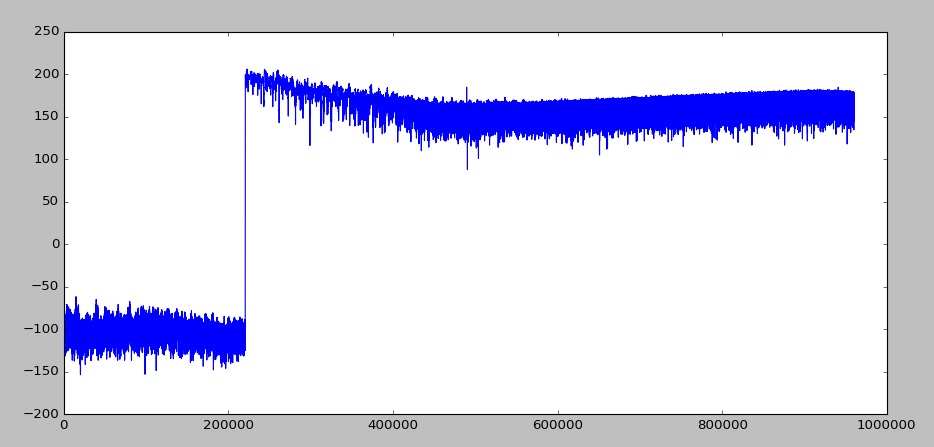

Here's the spectrum of the difference. Scale is arbitrary on the vertical and frequency x10 on the horizontal (10 sec of data). Notice the brickwall is perfect a transition in one bin (0.1Hz) of -300dB. Why the time domain looks like mostly 22050Hz is a mystery to me.
EDIT - Looking at the scale the energy near 22050 is 50dB more than the higher frequency information so maybe not a mystery.
Now that, I did not see coming.
That is going to take some thinking..
hmmm. We see gibbs when the slew rate exceeds bandwidth ala square wave transitions.. The filter reacting so to speak to a call to do more than it will allow..
The Gibbs envelope seems to correlate to the hf content of the green unfiltered, and almost seems to correlate to a phase shift between filtered and non filtered. In fact, when there's lots of gibbs energy, the amplitude of the blue filtered is diminished.
Thanks for the effort, I will be thinking about this for a while.
Did you get a chance to try a 5k/20k modulation envelope or simple gated 20K through the same process? At least there, we're dealing with a bit more known.

Scott,Here's the spectrum of the difference. Scale is arbitrary on the vertical and frequency x10 on the horizontal (10 sec of data). Notice the brickwall is perfect a transition in one bin (0.1Hz) of -300dB. Why the time domain looks like mostly 22050Hz is a mystery to me.
Could you show the inverse transform of your brick-wall.

Well, the only tool in the toolbox for the brickwall is the sinc, no?
I am thinking the gibbs envelope reflects the system fighting everything that exceeds the cutoff, so by reading the envelope, we can see where the content would want to break nyquist.
To violate nyquist, we simply have to provide a stimulus that exceeds it. Frequency is one, envelope modulation by AM is a second, and I believe FM is also another way to break the bank.
If you gated a 20K sine on/off, I would think the gibbs envelope would be large at the transitions, tapering off at constant sine.
If you modulate at 5k, I suspect a 5 k modulation of the gibbs envelope.
If you were to do a fast frequency sweep 20 to 20k, I believe sufficient rate change at the hf would also invoke the response. The gibbs envelope should show us exactly where we begin to violate nyquist by signal modulation.
See, that is why I hate having someone else do all the hard work, many times the result of an experiment informs decisions on what next to do.
But again, thank you very much Scott, much appreciated.

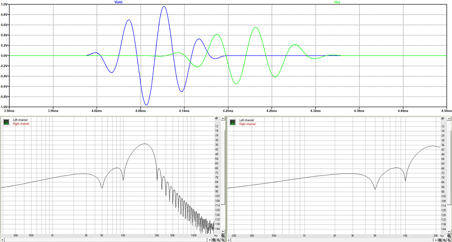

I have a bit of a problem understanding what is momentarily tried to being proven.
In the images below I have made a "quick and dirty" simulation of a 20K sine modulated by a 5K sine in blue.
After that, the signal is brickwall filtered with a very moderate 250 taps Fir filter.
At last I have made a 384Khz .Wav file of the original blue signal and a 44.1 .Wav file of the green Fir filtered signal, see both spectra below.
At first sight I don't see alarming things of the original spectrum being mutilated by sidebands or whatever.
The other thing is, my Fir filter is far inferior to the ones used in practice and does already attenuate -4.6dB at 20Khz.
Hans
P.S. The window used was 100msec, giving a resolution of 10Hz

I'm doing the filter in the frequency domain simply setting all bins above 22050 to zero so the inverse is exactly the sinc function. I'm using any N FFT's so I don't have that added confusion, all bins are exact Hz or 0.1Hz

Nice. Why are they different frequencies?I have a bit of a problem understanding what is momentarily tried to being proven.

Edit: if you look carefully at the zero crossings, the green post fir has zero crossings spaced farther apart. Also, if you compare the two spectra, both have dips exactly at 5 and 10 kHz, but the pre filter on the left peaks exactly at 20 kHz but the post filter on the right peaks at a lower frequency, consistent with the waveform frequency differences above.
I see also that you truncated the post filter spectra just above 20k. What did it look like when displayed exactly as the pre filter spectra?
