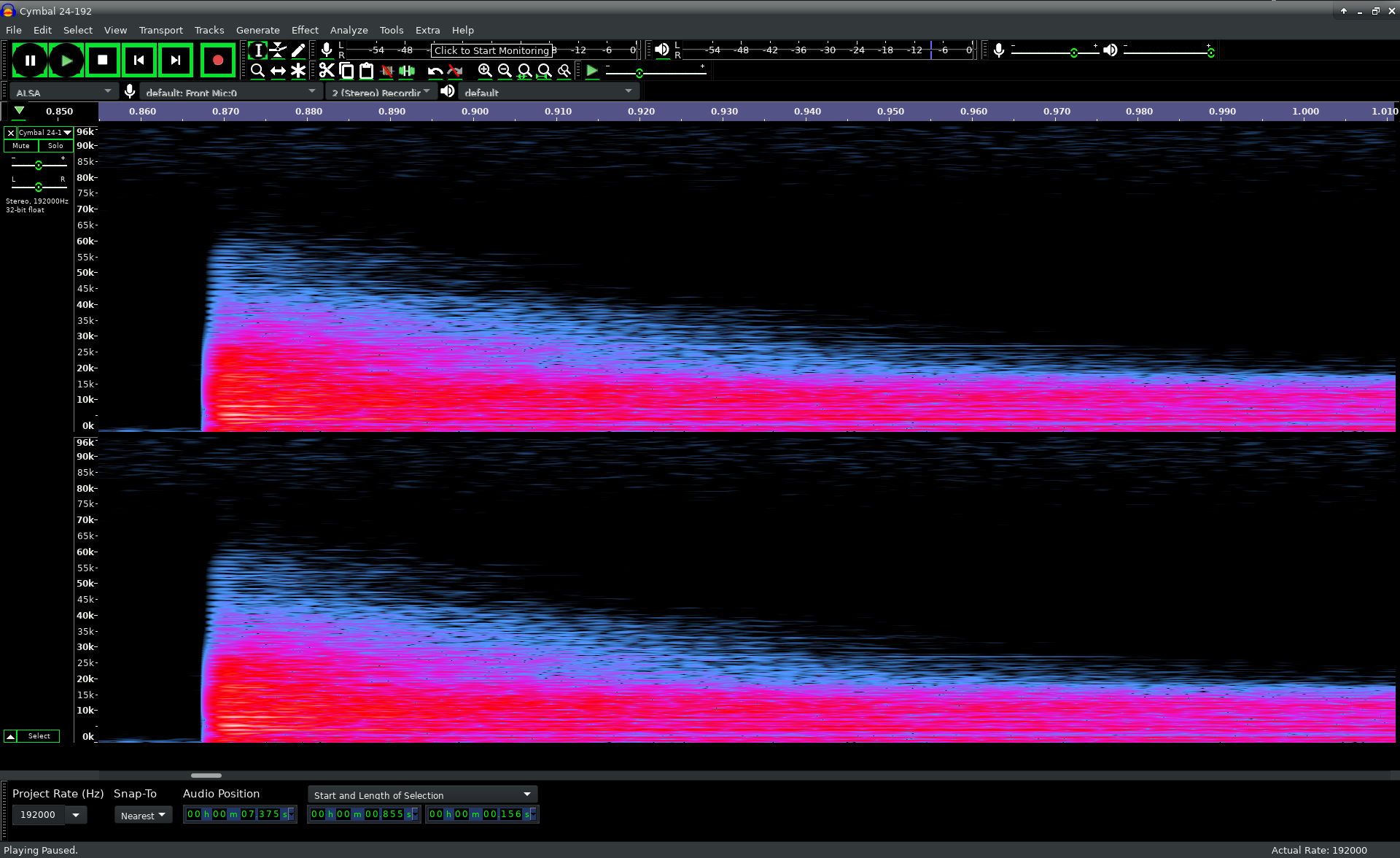

Can you say what hardware - adc etc - and recording software was used?
Cymbal was Zildjian K Custom Hybrid Limited Edition 14" Reversible Hi-Hat top.
Mic was Schoeps MK41 capsule with CMC 6 body (aka Schoeps CMC 641).
Mic and premap-to-ADC cables were custom manufactured Jam designed XLR cable wire.
Preamp was Grace Designs M101.
ADC and master clock source was RME ADI-2.
SPDIF from ADC into Focusrite Scarlett 6i6.
Recording software was Reaper 64-bit with project sample rate set to 192kHz (to avoid any unwanted resampling).
Hope that's enough info for you... 🙂

I just want to record the content that can be heard. 20k as a frequency limit, but also a bit more bandwidth to assure capturing the envelope information we are sensitive to.
