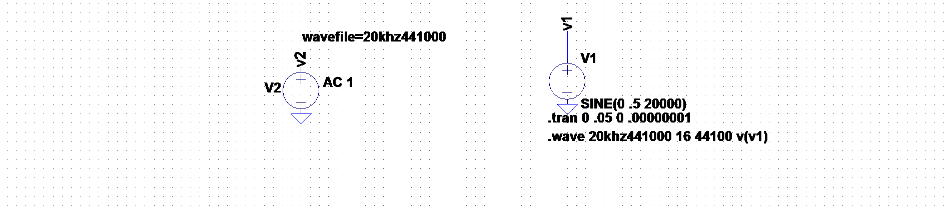

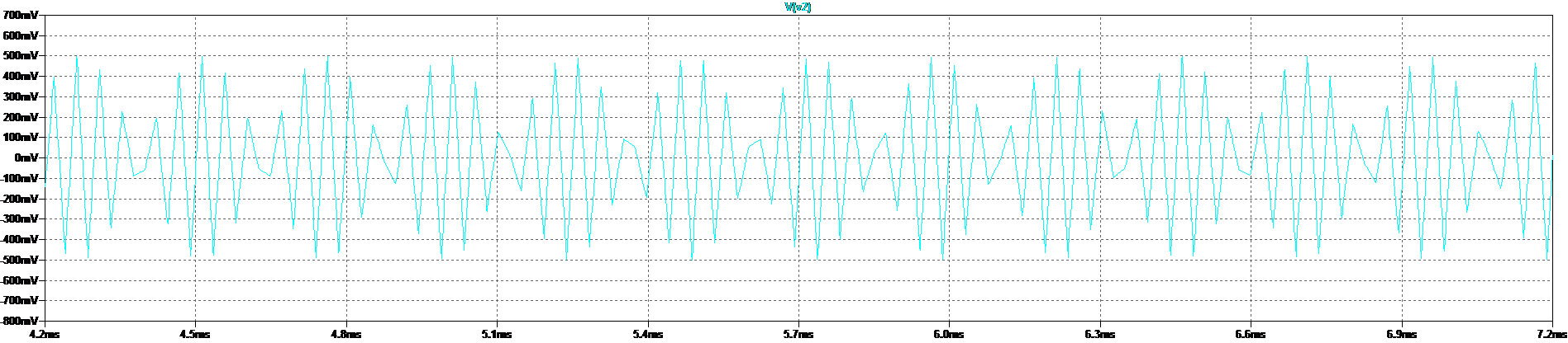

Interesting you asked us to measure 20kHz distortion on a system that is brickwall limited at ... 20kHz.
Really? So how can I buy a test CD with 20khz tones on it?
Toneburst Test Signal CD

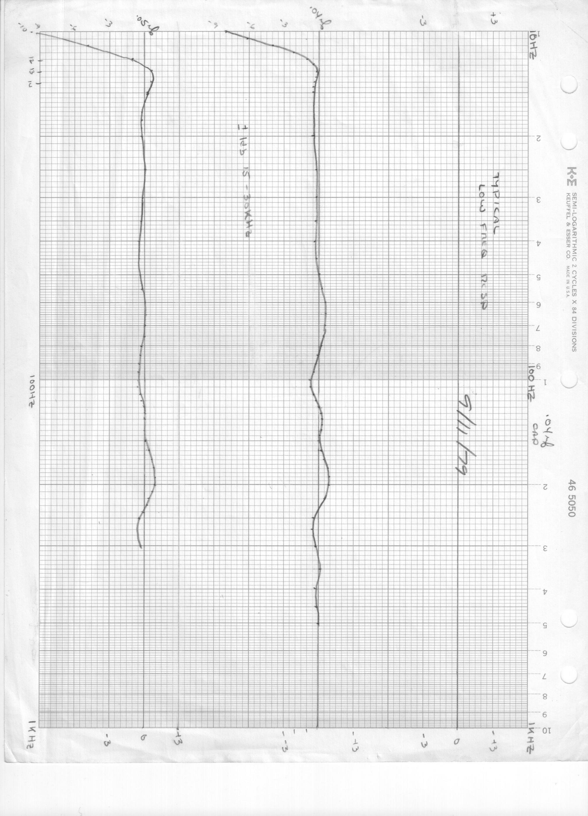

For the record, the low freq response with 30ips can be fixed. Here is an example.
Secondly, often ultrasonic bandwidth is rolled off to improve MEASURED NOISE specs, or to compensate for reproduce head losses due to scanning (at low frequencies) or from lamination thickness. At 30ips, scanning is not a problem, 2mil lam heads are quieter than 6mil, like Ampex used in the 60's. It took a decade from when I pointed this out (1968) to the Ampex audio department to when they improved the heads with 2mil laminations. Much of the head noise is ultrasonic, so rolling off might be thought useful.
It is NOT the frequency response that is so important, it is the RISE-TIME of the recorded signal that is.

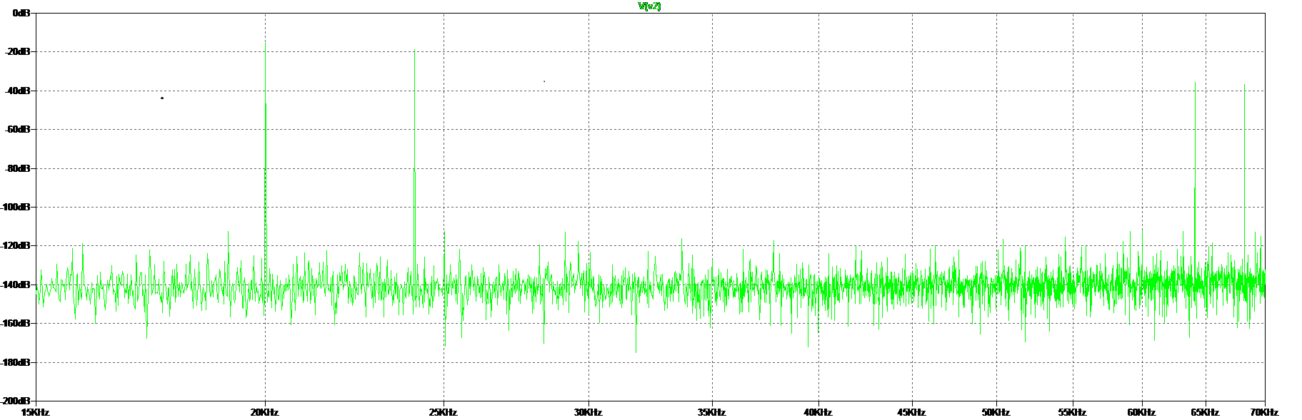

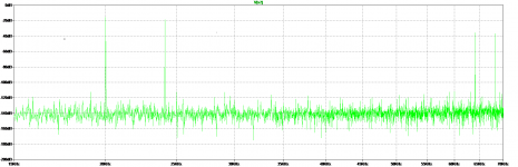

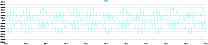

looks like lots of 20k and nothing to filter till 24k. ie a brickwall should retrieve a decent 20k sine.
LTSpice can very well create a 44.1/16 .wav file like you did, but is not the right tool tool to analyse the spectrum of this file, because it connects all datapoints with straight lines instead of ZOH.
This alters the Frequency content and shows a wrong spectrum.
Better to use a tool like RMAA to analyse the spectrum of the created .wav file.
