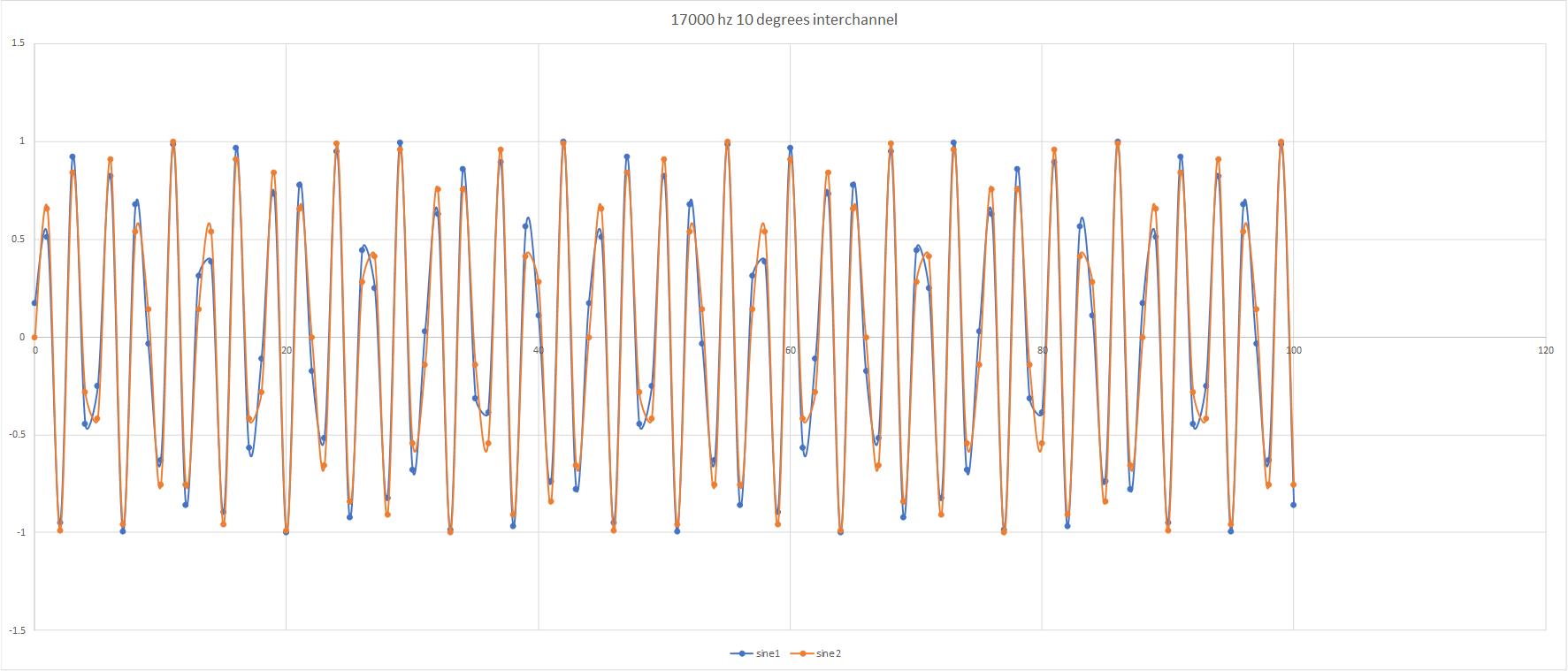

On another note, I had time at lunch so built the excel sheet I mentioned yesterday.
Since Lavry liked 17Khz, I used it.
I built the sheet to display two channels. I set the sampling rate, and set the sine frequency of interest as well as the angular separation between the two sines.
So this plot shows 2 17Khz sines sampled at 44Khz, with a 10 degree angular separation between the sines, and simultaneous sampling.
Note that the dots are exact out to 15 places in amplitude. (that was the resolution of PI in excel.)
Also note that excel did the line fit, I had no say in how it does the fit.
Also, the data points do indeed mimic Lavry's 17Khz sampled 44.1K prefiltered.
Of note, there are distinct amplitude and phase differences throughout the graph. Given two identical channels filtering that mess, the question is...will the reconstructed pair have an exact and continuous phase shift of 10 degrees in this case?
I can't believe you think that signal reconstruction is equivalent with Excel interpolating, allegedly with some polynomial, over a few periods. You could let Excel draw segments between points and get an even more spectacular effect.
You are still missing the elementary fact that digitizing a few 17KHz sine periods at 44.1KHz is violating Nyquist, since there is a lot of energy beyond 17KHz that you wish to be reconstructed. The spectra of a few sine periods extends to infinity, only an infinite sine has the spectra of a delta function at fo.
