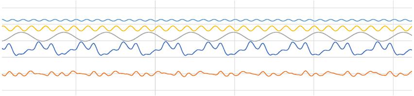

My first thought on analysis would be to do a harmonic subtraction analysis, jpg attached.
Start analog with multiple frequencies of interest added together, convert via redbook, play them back in a system, take the resultant analog waveforms and do a subtraction.
The example I post (I cropped all the scales and titles for IP reasons) shows the result of one analysis. the dark blue line is the signal of interest. I sequentially subtracted appropriate amplitude/phase waveforms , minimizing the residual error (the bottom orange trace). The grey was first removed it is the fundamental of the waveform, then the yellow third harmonic, then grey fourth harmonic.
What is really interesting is that the residue is actually a product of first and fourth harmonic. That information would be lost to a mechanic if I simply used an FFT. What it shows is that the fourth harmonic is being gated, or modulated, by the first harmonic, or vise versa. Mechanically, that is consistent with a torque ripple at first harmonic being put through a mechanism that has a fourth harmonic structure and issue...for example, an involute straight cut gearset, or an poorly chosen coupler that is being overstressed as a result of misalignment (the actual cause of this waveform btw..)
While the FFT is a very strong tool, in this particular case the resultant FFT output would not be very easy for a technician to understand. Showing that a specific mechanism which causes first and a specific mechanism which causes fourth are somehow interacting is far more powerful a diagnostic.
With a CD output, I would first do an analog subtraction at various frequencies for examination of modulations.

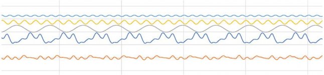

May I ask what DAC you used for that?
Also, you did all the subtraction in the analog domain then digitized the result?
That is not the result of a DAC.
The waveform is the positional output of a linear encoder capable of 1 nanometer resolution subtracted from the calculated precise location it should be at during motion. The calcs of the positional error are done using 48 bit precision. For the actual subtraction technique I simply used an excel spreadsheet, where the three waveforms I subtracted had phase and amplitude handles, the residual was minimized by eye.
Since I know the base frequencies, I could have done a simple multiply using sines and cosines to grab phase and amplitude (NIST uses that), but excel is quick and dirty. Converting to a useable GUI I would rely on some young coders here. My intent was to prove the usefulness.
I used that crop merely to show the advantage of this totally old school technique, where a new school one (FFT) would muddy the causal effect.
