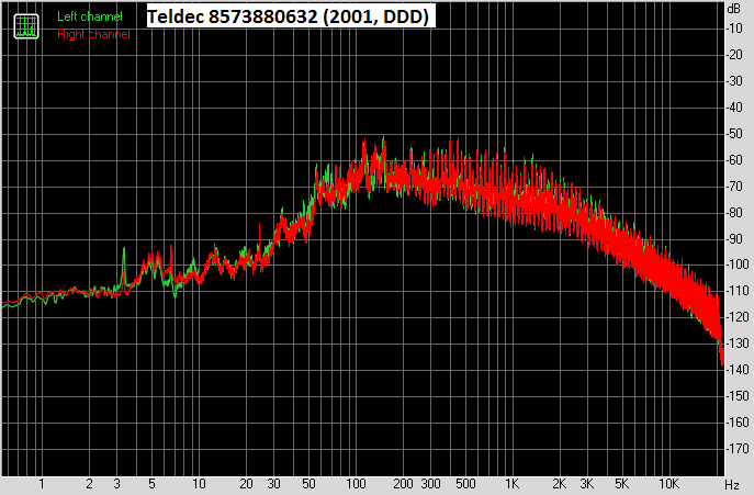

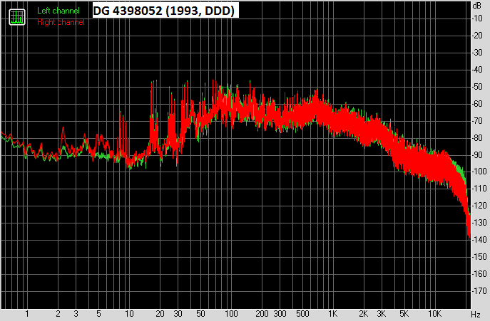

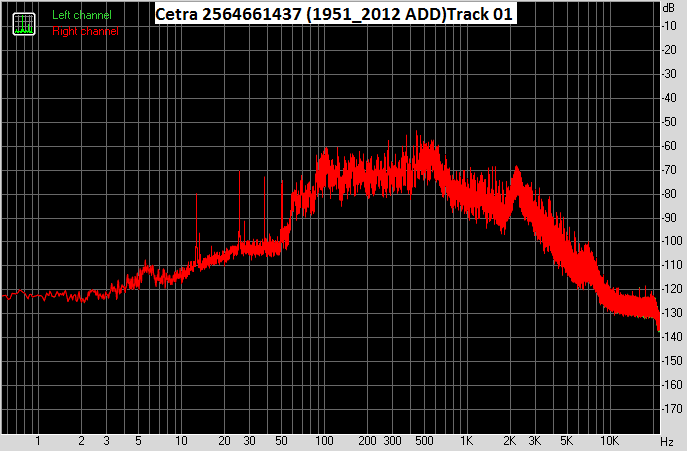

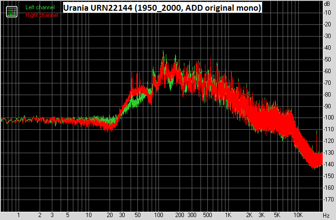

Re subsonic content.
Some FFTs (4M samples) from opera CD rips .
Remastering scissors are obvious.
