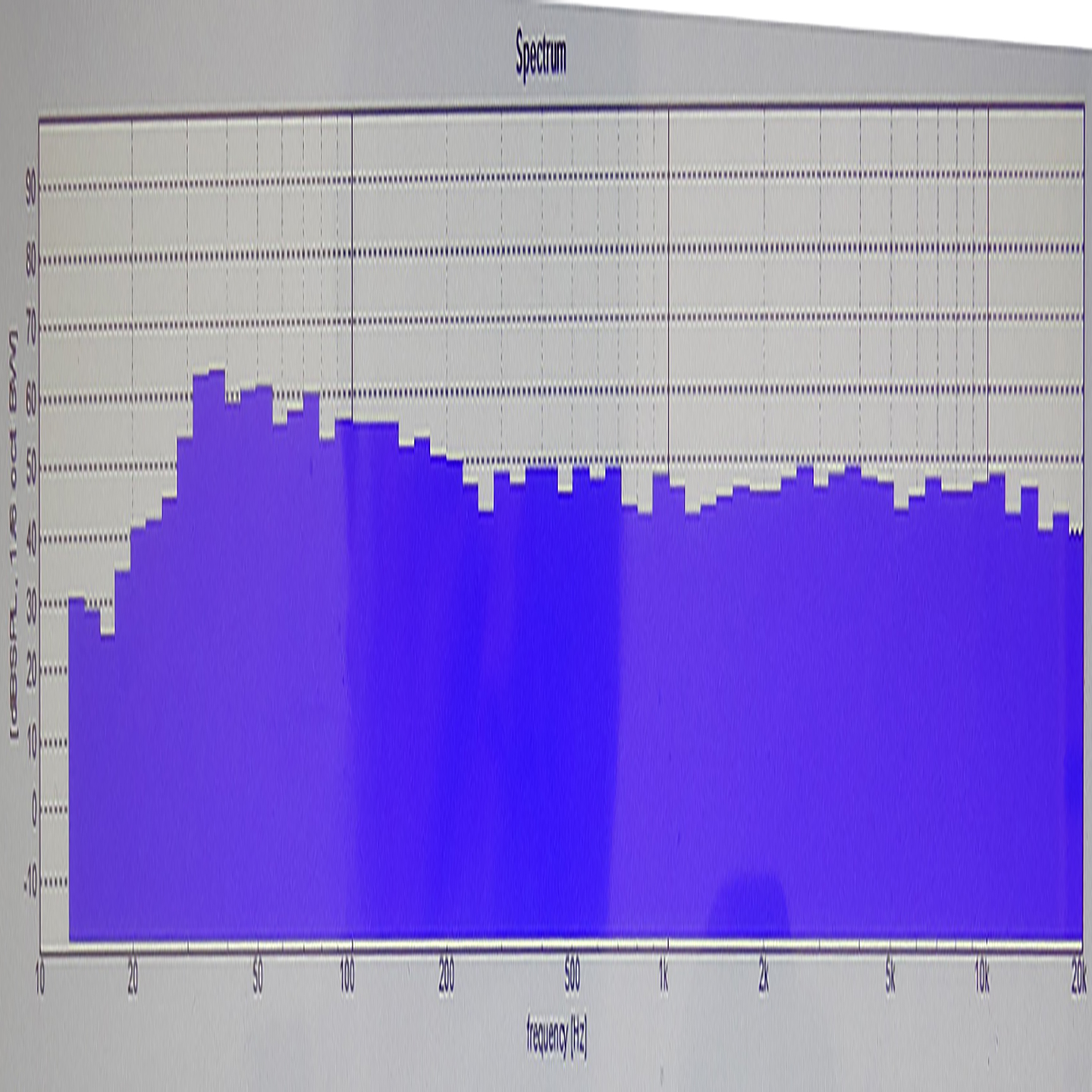

No, it rolls off starting at 40Hz... which is the driver/box response rolling off.
For the music I listen to, it is fine.
40 Hz is lowest fundemental on 4-5 string bass guitar.
Typically, there is little played below 40Hz.
Thanks for your expert opinion. But, no thanks. Maybe for a video surround sound system for the Effects channel.
As for 'water-fall' displays , time, reverb data etal. This isnt the forum for that. So, that is all you get here about my system.

The attached image is one of your channels stretched up so that the chart is closer to square which is typical of FR posted elsewhere. It looks like you could benefit from some EQ-ing.
If you know about DSP EQ, it takes a lot of power to flatten a speaker with large peaks and dips. Thats why I made the point to tell you this was Not EQ'ed and in that case it was very good.
Remember this is 15 feet out into the room. Up close and personal it is smoother. AND, I do not listen 15 feet out seriously... only up close to the speakers so i have nil room influence. I only do serious listening in near-field. Try to remember those important details.
When DSP applied to it will be as flat as those headphone Freq response curves.
The rise is normal when in a corner.
You should see the QUAD ESL...
What is your system comprised of and what data do you have for it.
Almost all speakers in the home environment are designed so that the response tips up by 3-5 dB in the bass registers. This approach has been known for decades.
Looking at the plot, I’d say it’s pretty good basic performance. Clearly some in-room resonance nodes, but as RM mentions, listening in the near field will fix most of that.
And yet, you posted the measurement from 15 ft away. Once again, I don't understand your way of responding.
Which you won't post the images of. :scratch:
I thought you are discussing your JBL M2.
In the case with the image that he posted, it's about 15 db hot in the bass region.
I dont answere or write only for you... we are on an open forum here. Its info for everyone. So, it tends to be generic in nature. useful to many. Hopefully.
You get a 2.5dB rise for every surface near the speaker. (3db in theory). Its in a corner.. so figure it out. Should come out to about 12dB.
However, The other is not in a corner and in total... because bass in not directional and often mixed in mono... the over-all bass is balanced in the room.
