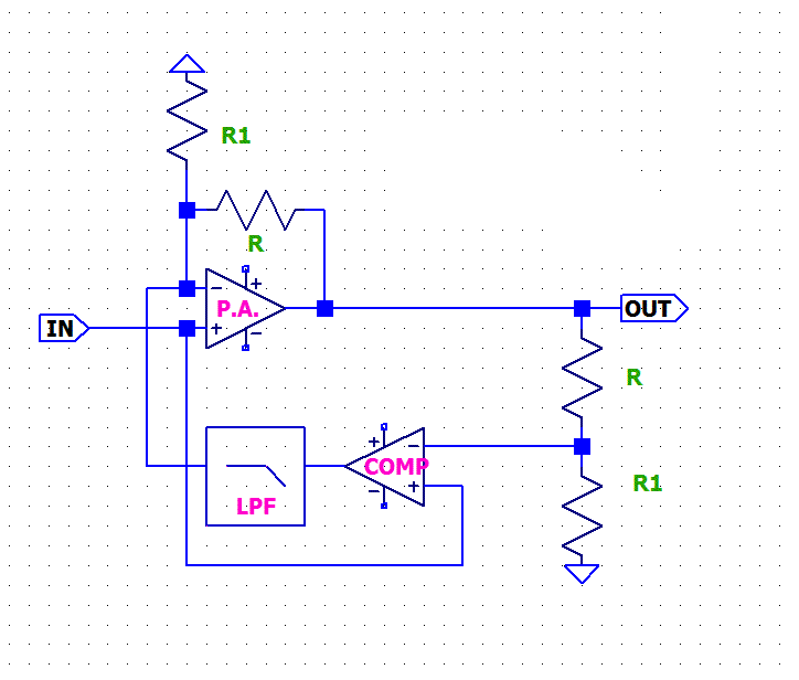

For audio amplifiers, it is a solution to a problem that does not exist. There are always artifacts generated as well.
- I think a problem exists. DC offset in the output. Means the need to adjustments to minimize-it. In an industrial production, it has some cost and drawbacks.
- What are the artefacts you are talking about ?
All the servos we tried and they are all pretty similar in function, seemed to mess with the bottom end to some small degree.
On an objective and technical point of view, if there is no phase turn at 10Hz, and no increase of distortion (but the contrary) with the servo, could-you justify this assertment ?
https://www.diyaudio.com/forums/attachments/solid-state/787498d1570966205-pizzicato-200w-low-distortion-cfa-amplifier-pizzi-schema-gif
Here, the unusual* servo I use in this project.(See attachment)
The original audio signal is canceled in the comparator, before to be filtered and the remaining DC error applied.
Is here any luck we could notice a subjective and noticeable impact on the sound character ?
* No patent pending ? ;-)
PS, ref #31630
