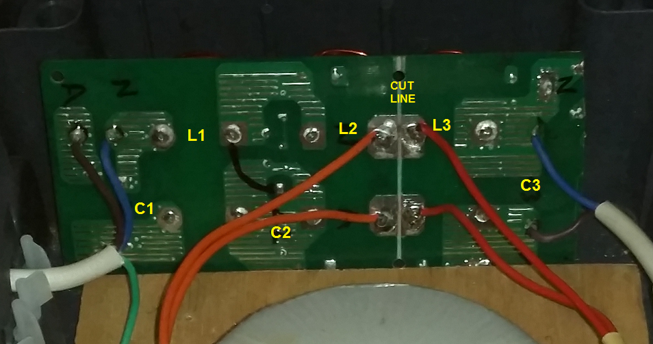

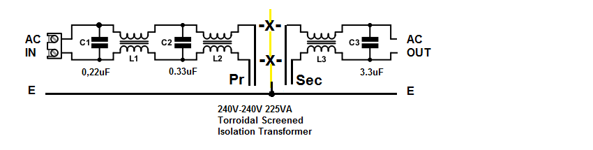

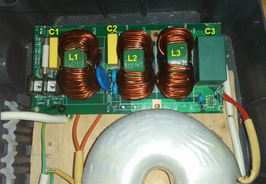

I have constructed an AC filter/screened isolation transformer box for purpose of isolating my music source laptop (and usb DAC) which runs on ext brick SMPS....which causes longitudinal leakage/noise (as expected).
The resultant is cleaner/clearer system with fine film/haze removed from the sound and pretty much the same sound as when the laptop is running on internal batteries, but not exactly the same, ie powering the laptop ext smps still causes a very slight sonic change.
The circuit is as below...
The filter pcb is a section cutout from a salvaged solar convertor pcb.
I cut the pad (-x- on the schematic) connecting L2 and L3 and inserted the isolation transformer at these connections.
Do you advise shunt caps or RC networks across L2/primary or L3/secondary and RC network across final output?.
Destroyer OS in his Felix AC filter recommended 3K resistors in parallel with each of the the CM choke windings....do you have opinion/experience with this?.

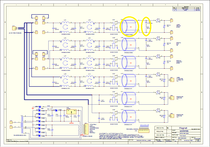

In your HTPS schematic I notice there are 0.1uf/1R5 RC networks across the filtered direct AC outputs, but not across the transformer isolated outputs.....is there particular reason for this?.

Do you have a network analyzer to view the filter performance? Some of the values depend on the inductor/CM characteristics vs freq.
THx-RNMarsh
No I don't have a network analyser, perhaps I can record speaker outputs and see if I can detect differences and compare that way.
