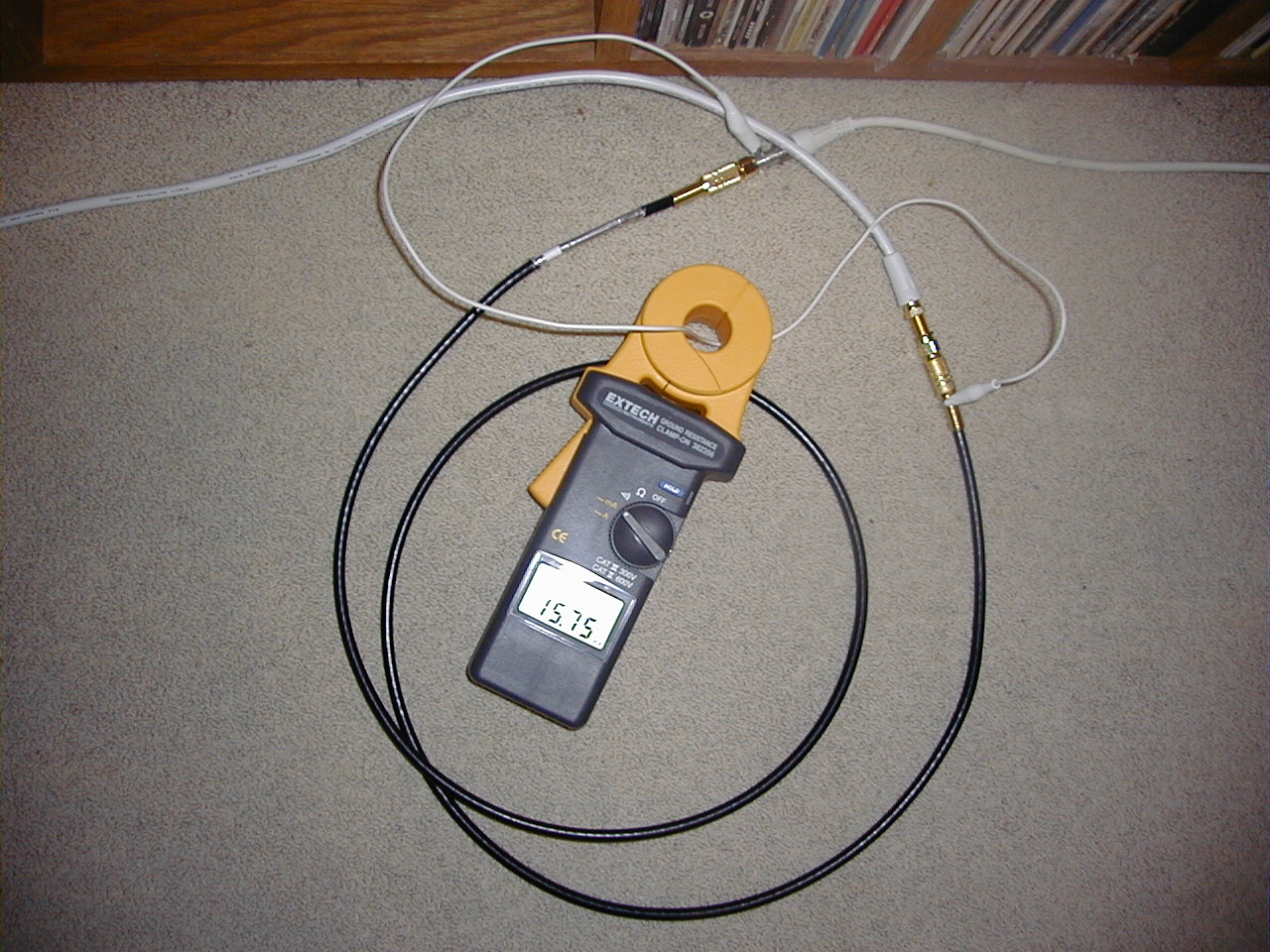

Two earthed points?Not so. This is a legal NEC system Untouched in a residential home. 15 mA, 60Hz flow between two earthed ground points.
Assumptions can kill you. Always measure.

Two earthed points a distance apart is not code. It is dangerous.
Here on the east coast USA we have single bushing distribution on the pole. The HV run is top of pole, return for HV is the neutral wire below the transformer, it has the 240 v pair twisted around the steel neutral for support. Every two or three poles, an earth is dropped.
As a consequence, a small percentage of the return current will be through the dirt itself, 2 to 5 percent IIRC. This forms an earth gradient, which will be picked up exactly as you measured.
Many scenarios can cause the difference to be lethal between two earthed conductors if they are a distance apart. Outside my house for example, a car dropping the utility pole could alter the earthing currents such that a large earth gradient exists.
A very significant problem with separated earths is lightning. A nearby strike will toast devices with separated earths.
PS. A distinction must be made between earthed points and bonding. Bonding is a safety thing for faults in the AC system, keeps exposed potentials low during a fault until the breaker opens. Earthing is for lightning.

yes it is code. New code has all signal and power lines earthed and bonded at single entry point but too late for a hundred million homes.
Two grounds isnt from the ac power wiring system alone It was/is from the CATV grounding. The CATV is/was grounded anywhere they pleased... usually at closest point to TV room and a penetration thru wall to termination type F outlet. Ditto telephone lines. These multiple grounded systems were not required to all come into home at same location as power panel.
Thus, the currents shown was not during a lightning storm. It was there continuously. If you look carefully, you will see it is a CATV coax current flow when CATV is connected to equipment where power is grounded else where.

Ah, you speak of residences where cable and telephone may not enter the house at the same location as the primary AC feed.. It is indeed legacy, a design Martzloff called an upside down house.
In those cases, the second earthing conductor is not functioning as the AC power feed earth, but for the utility.
That is why I always recommend any system using AC as well as another wire link to the outside world such as cable, use a multiport SPD at the point of use.

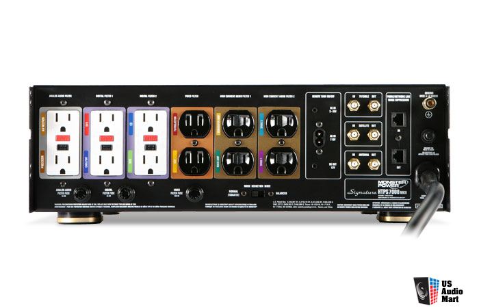

Much too complicated for a casual consumer who just wants that hum/buzz they got when they bought and installed a TV/Video and audio system together.
Besides all the benefits of separate. isolated filters, in the same chassis of all Monster products was the F-type cable which provided transient protection but also grounding to ac power and all gear connected had that chassis as common ground point. no current loops between connected equipment.
(note phone grnd and protection, also)
Its a well researched product. Thoroughly designed and built. The oem manufacture called me and told me they have found about 20 NOS they are going to sell from their warehouse.

The theory, yes. But the practice of using a multiport SPD is not. It is a turnkey device, requiring no understanding of maxwell's equations, code, nuttin.JN.

essentially that is what is on the rear panel.
https://www.erico.com/catalog/literature/TNCR022.pdf
THx-RNMarsh
Terrible. I’d be pretty unhappy if that were the case where I live. I never understood US wiring though where IIUC you mix up Ground and Neutral.
This is not a dig - please correct me if I’m wrong. How the hell can you have 15 mA flowing in a ground unless there is a fault?
The US being a big place uses hot conductors normally three phase to distribute power. In the eastern part of the US one of the high voltage phases is connected to a local residential distribution auto-transformer this in my neighborhood steps down 13,600 volts to 126-0-126 VAC. The 0 volt line is called the neutral and is grounded usually at each local drop transformer and at the building entrance.
Note the neutral is also required to handle the current from the high voltage distribution line. As each residence draws current the is some voltage drop along every length of wire. So if you measure from one power drop's ground connection to another there will be a potential difference. If you drive a secondary ground rod for a service such as cable TV in between two power ground rods it is easy to have a potential voltage between any combination of ground rods.
The idea was to save one conductor in the long distance power lines.
Some local utilities run the neutral or grounded conductor on the top of the power lines to reduce lightning damage. Others may run it lower. As a result there are lightning strikes that only damage half of the connected devices in some locations. In others everything gets damaged, but it does take more of a surge. (A lot of half damaged users vs a few totally blown!)
The safety ground is a different conductor and is connected to the same building neutral ground at one location only.
