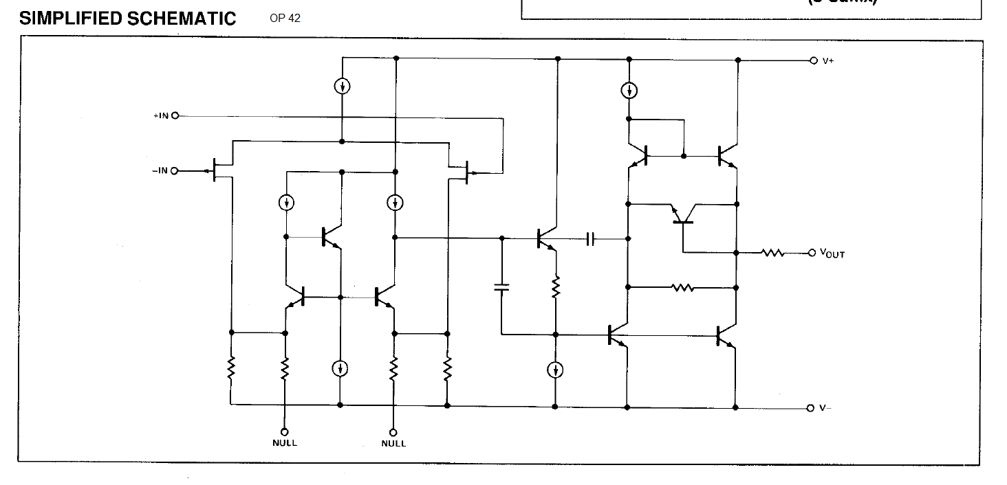

I still search for a really good linear IC, one that can put my jfets to the test. Today, an associate found 2000 OP-42 IC's in his storage room. What can we do with them? I am told that they are pretty good sounding, better than most, and I know that their circuit topology was advanced in its time. (probably derived from a military IC made at Harris associates, back many decades ago, when dielectric isolation was necessary to make close complementary devices in IC's).
Keep them in a safe place, until they go out of production and become unobtanium. After that moment they will certainly sound wonderful.
1980's, right? I am not sure that their circuit topology is so advanced. It is quite fast (50V/us), not very high GBW (10MHz), it has high noise (13nV/rtHz at 1kHz). I am sure that OPA627 is better for audio and better sounding.
