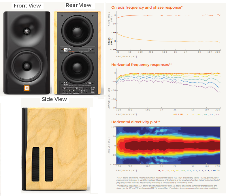

Dutch & Dutch | The Ear
Regarding the mid frequency directionality passive control:
DIRECTIONAL LOUDSPEAKER
I have found that room reflections in the listening room need to be engaged.
When you will receive the D&D 8c, you will have the opportunity to test this. Place them where your omnis are and please inform us of what you think of the outcome of the [omnis/directional] comparison.
PS.Which omnis do you have?
George

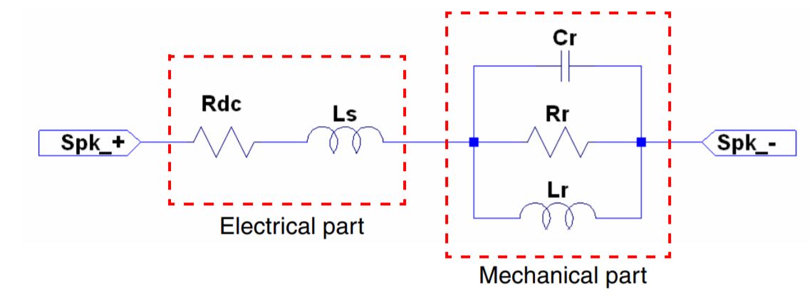

The back emf from the driver is damped effectively by the amplifier output stage? Not necessarily.
Indeed the back-EMF is a voltage source (not a current generator) that opposes the current of the amplifier. The myth of the amplifier adding damping was disputed way back in 1975 when I had that discussion with Richard Small, in those days lecturing at Sydney University.
He was referring to the equation below - and according to it, the amplifier can only make damping worse:
Analyse the equation and the Re is the DC resistance of the voice coil plus any additional series impedance, such as the output impedance of the amplifier, resistance in coils and wiring. So unless the amplifier has a negative impedance (making Re less), the amplifier can only erode Qes, not improve it. In the same way that those other things also erode the electrical damping - not much to get confused about here.
There is a lot of misinformed nonsense about this subject - most amplifier designers have promoted this, speaker designers just allow for the amplifier to have a range of output impedances, because they know some users will be using tube amplifiers, so speaker designers rarely think in other terms - the truth is that the alignment is what determines the damping - yes, amplifiers can affect the alignment, but the alignment can be adjusted so that damping is not lost, lower Fb and/or enlarge Vb. So these things are in the purview of the speaker designer, not so much the amplifier designer.
True and unavoidable since the amplifier is the source of excitation. The only thing we can choose are amplifiers that have a low and linear output impedance. However, the equation really does a great job of pointing out the horror that is a crossover. If you work out the instantaneous impedance of the crossover and add that to the dynamic output impedance of the amplifier, you will see that the crossover swamps out the effects of an amplifier. That's assuming a proper crossover that rolls off the highs from the woofer.
Finally, you're right. There isn't much that we can do about it beyond selecting another speaker model.
