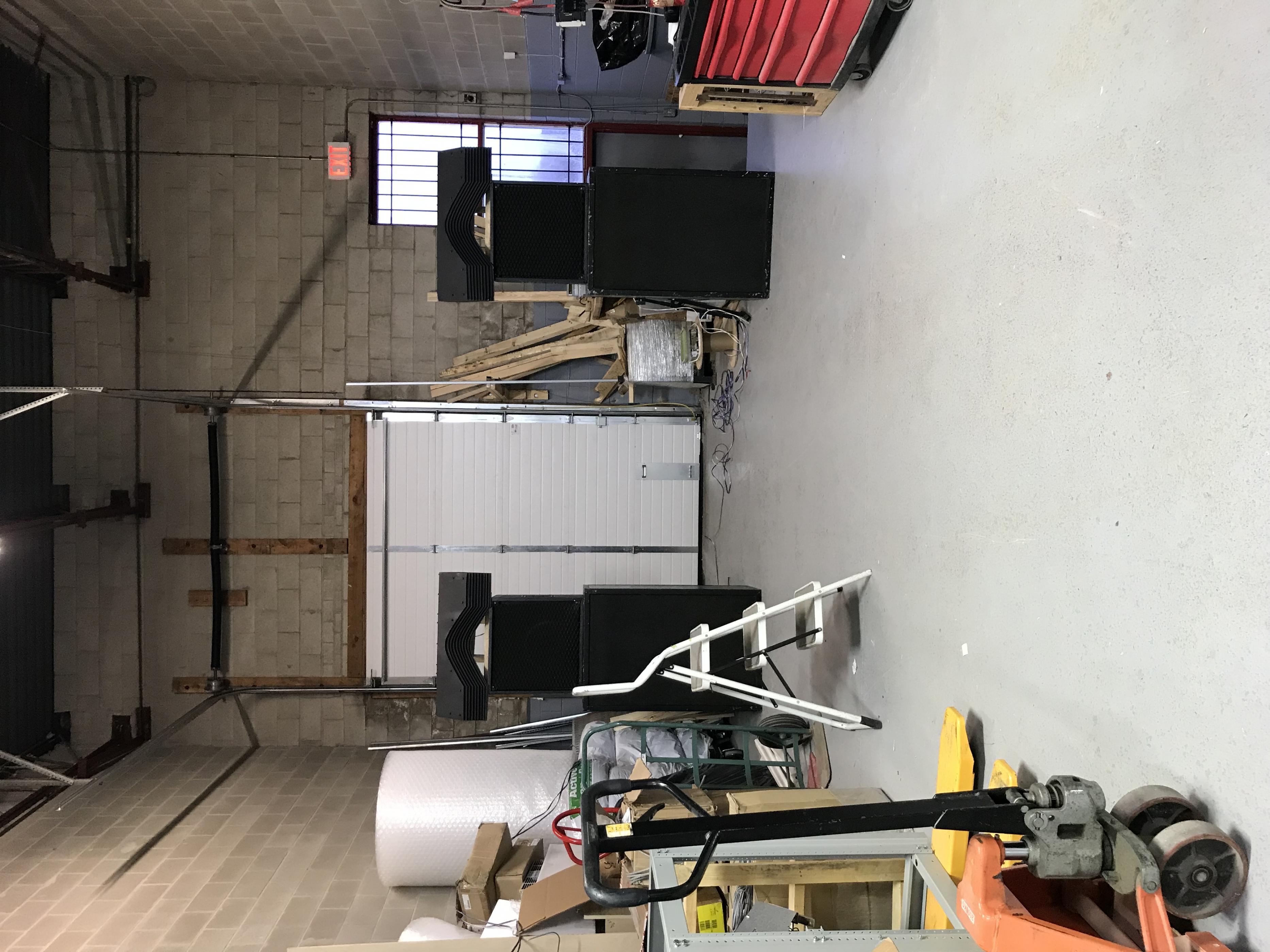

Chris,
I would like to bi/tri amp and DSP correct the 4 way JBLs used at the diy meet, but it isn’t a critical listening system and can’t see the investment happening. The mid horn needs to be shorter or moved to get time aligned, maybe a narrower dispersion pattern than the 140 x 40 pattern of the short throw mid horn, but I settled for a passive network with Richard’s film and foil caps for the crossover and am building a bigger class A to run them, but if I get bored who knows. Not a domestic listening enviornment, way too reflective. Hope to have a new 24/192 dac at the next meet, maybe also a MAc mini with Ammara installed, the version with Dirac dsp measurement and correction so maybe I’ll get some improvements happening.
Picture you posted is on its side but it looks like old JBL acoustic lenses on top of the stack. I never could stand the sound of those things, kind of like multi-cellular horns. With the lenses the louvers seemed to create some kind of distortion. My memory is a bit sketchy but I sort of remember some 60-degree horns that I thought sounded best with those JBL drivers.
