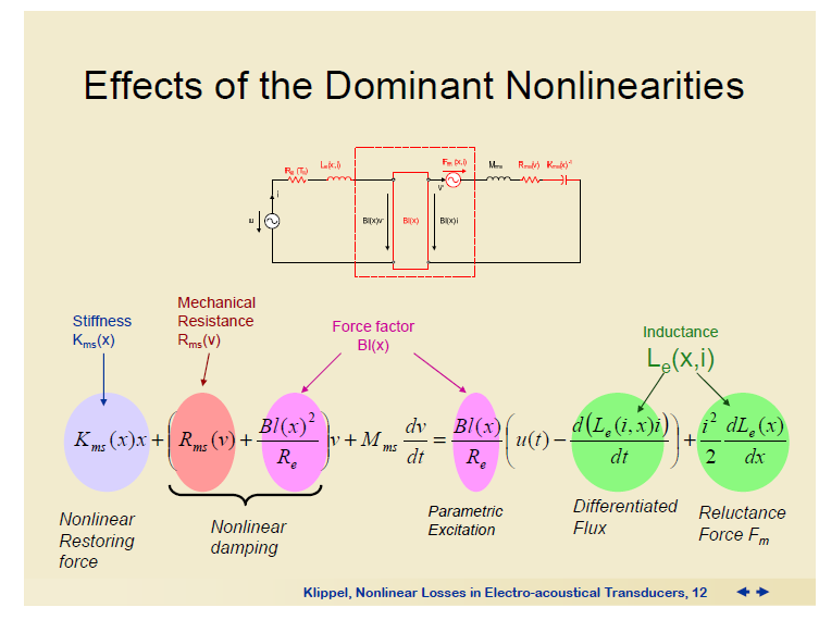

To wit...when a speaker is measured for inductance from 20hz to 2 kHz through resonance free air, one can easily measure negative inductance.
John, do you mean a voice coil inductance or just some "inductance" (covering mechanical side)? A voice coil inductance is nonlinear and is a function current, excursion and frequency. However I do not think it gets negative.
I mean what the meter reports. Phase crosses zero at resonance, and some meters will do the absolute value of the lead/lag, others will report negative inductance. But it is a different energy storage mechanism, just coupled to the electrical one. So yes, covering the mechanical side as you say.
