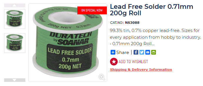

I hope you are not trolling because this will raise the usual sh*t storm....so here goes. I have experimented with numerous lead containing solders including Multicore 60Tin/40Lead, Multicore 63Tin/37Lead, Multicore Savbit (60Tin/38Lead/2Copper) and Multicore LMP (62Tin/38Lead/2Silver) and concluded that lead is not to my liking with Savbit sounding least bad and LMP sounding drive you out of the room bad.......ie IMO lead and silver don't go together at all. I use lead free exclusively nowadays and find that I much prefer it to any of the lead containing alloys.In your experience, what's the best solder to use here?
I currently use this 99.3Tin/0.7Copper alloy because it is easily available locally, I reckon it sounds good* and it does solder perfectly nicely when you get the hang of it. I have also used Multicore 96S (96.3Tin/3.7Silver) long ago and from memory found it to sound really good but I need to revisit it again knowing what I now know....it's also expensive. There are some other Multicore lead free solder alloys that I have not tried - View attachment solderwireproperties.pdf
In answer to your question I find that swapping out the 'who knows what/Hu flung dung' solder at the driver terminal/flex lead joints with the above lead free solder makes a very agreeable improvement in clarity intelligibility and musicality and it follows that all connections to all the drivers should be the same solder, ditto all input and crossover joints with the joints nearest to the final transducer voice coils having the greatest change/benefit ie flex lead joints and signal wire/RC-RLC network connections. Ensuring that all loudspeaker joints and all driver joints are the same solder alloy also sets a 'coherence' in the overall sound and this is critically important IMO......this is a low cost experiment to try and will beneficially change the sound of your speakers IME/IMO.
sounds good* - I find lead puts a bumpiness/lumpiness in the bass/vocals and overall 'wrongly damped' and unintelligible character in the sound, lead+ silver does the same buts adds a hard/bright sheen that does not belong (a false/wrong brightness/detail that grates in time IMO). The Tin/Cu perhaps initially might sound slightly dull but no nasties (errors of omission perhaps but no embellishments) in comparison and long term I find it to be pleasing/pleasant and more naturally detailed and totally preferable to any of the lead alloys I have heard. I find the same deal with RCA interconnects and I find some retail 'high quality' interconnects I have containing various lead alloys are unlistenable now that I know the difference. George, you asked so there is my answer from careful experimenting and long experience, YMMV and to those who will have you believe that solder alloys cannot have subjective effect my reply is simply to try the experiment.
Cheers.

Too bad most products were soldered with Kester '44, lead-tin combination. Everything must sound lumpy and bumpy. Even the Multicore solders (excellent) and others have been used everywhere from the mics and pickup coils, through the recording desks, tape machines (or computers) and onto the media making equipment are lead based solder. The new formulations don't all use silver, lead-free solder is already too high in temperature.
Guess what happens when you solder the flexible leads in drivers? The new, and old solders "wick" up that lead making the first part solid. It's a good way to hasten lead failures. So I would ask you to use extreme caution when recommending some procedures to other folks. If you like to do it and wreck your own woofers - okay. Just don't take others with you.
In case you're wondering, I administered loudspeaker warranty programs and did incoming inspection on re-coned drivers. Never, ever apply heat or new solder to the flex leads going from a speaker terminal where the wire leads to the cone.
Now, on to solder affecting a signal in any way. I'd like to point out that test equipment which is far more accurate and lower noise than audio equipment seems to survive any reasonable solder used in connections of their boards. This equipment is sometimes extremely sensitive to amplitude and phase problems and operate over the frequency ranges from DC to literally light. I have yet to see any equipment that used silver solder (some specific sensors do). I am dying to see an instrument that says on the case something like "wired with Monster wire" as some audio gear was.
