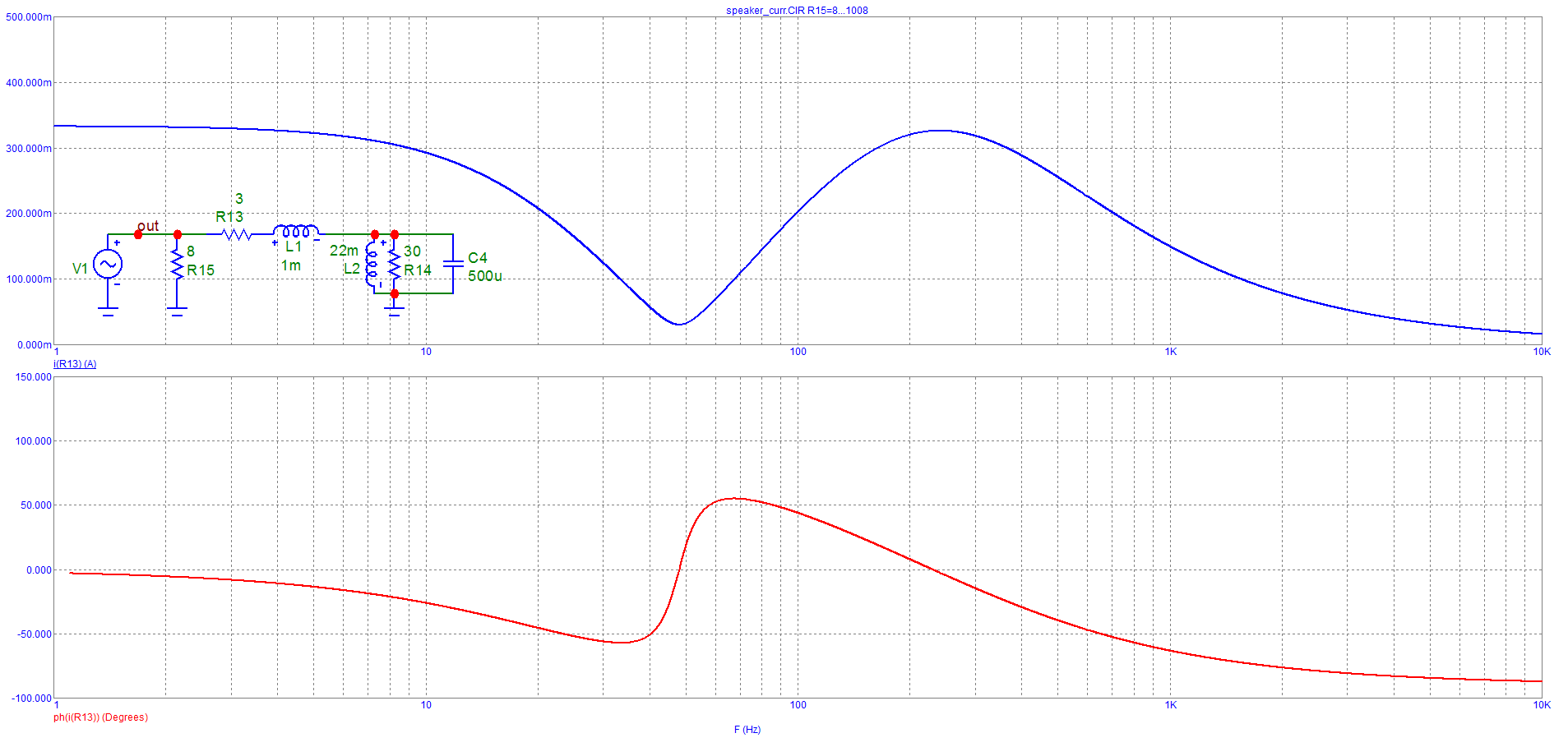

The question still remains that paralleling at the speaker with a R (50-75 Ohms) makes an audible difference compared to no added R.
Why?
THx-RNMarsh

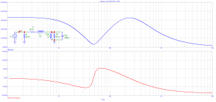

Flattens the current phase angle.
See below, while this is a single driver (Red), you can see what happens when you add a significant parallel resistance (Blue), 8 Ohm driver and 8R parallel resistance, so it becomes a nominally 4 Ohm load. Fine for most amplifiers.
This works even better than adding series resistance, but is also more wasteful than using series impedance.
This time series 18R added, but compare with the above and parallel is the better result. Also, voltage swing is severely curtailed with large series resistance.
I know this is going to cause flak, but this is about the amplifier 'reacting' to the speaker's load. The Re (DCR) of the speaker will be about 5-6R and anything above that in the impedance measurement is caused by back-EMF, basically a voltage source.
If you can whistle into the speaker a tone that matches that from the amplifier while measuring the current, and as you increase whistling (this is of course a thought experiment), then you will see a reduction in current from the amplifier.
That back-EMF is also what causes the current phase angle, since the Re part of the impedance cannot. The Re is only resistance and is not reactive, indeed the Re value limits the effect of back-EMF on the amplifier.
This may be difficult for some to grasp, but it sure is not rocket science.
Repetitive nonsense. If you add a parallel resistor to a voltage output, speaker current does not change at all. See R15 stepped from 8ohm to 1008ohm. You are trying to manipulate reality and people. Speaker current goes through R13. Only i(R13) + i(R15) is changed, which is unimportant IF you have an amplifier with high DF and output current.
