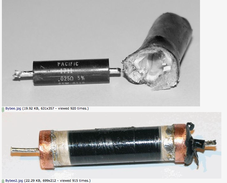

Hi Jacob, take a close look at the construction and you will see a Pacific 25mR resistor that goes inside and connected in parallel with a ceramic sleeve with 25R black conductive coating (1000:1 ratio), the outer cloth and heatshrink can be ignored for the purpose of this discussion. IIRC the Pacific resistor is made from Beryllium and the 25R coating on the ceramic sleeve consists of Rare Earth Oxides fused in a furnace over 36 hrs or so. The 25mR resistor is stated as having velocity of propagation of 0.6C and the 25R sleeve Vp of 0.92C. What happens when two currents out of time combine in ratio of 1000:1 ?. What is the field radiated by the resistor and how does the sleeve conductance interact with this field and what happens ?. Other interactions going on ?.
Dan.
Assuming those numbers are correct (provenance?) then what is the transit time for each, and what is the difference in time? Is that really where you want to hang your hat?The 25mR resistor is stated as having velocity of propagation of 0.6C and the 25R sleeve Vp of 0.92C. What happens when two currents out of time combine in ratio of 1000:1 ?.
Dan.
Based on measurements and reports of listening tests, nothing happens.
A very tiny phase shift, far too small to be of any significance to an audio circuit.Max Headroom said:What happens when two currents out of time combine in ratio of 1000:1 ?
The resistor will "radiate" almost nothing, assuming audio frequencies. (We have been told in the past that the Bybee does not work by blocking RF, so we can ignore RF). There will be a small local induction field, which the sleeve may attenuate a little. No consequence for audio.What is the field radiated by the resistor and how does the sleeve conductance interact with this field and what happens ?
By far the strongest interaction is between the wallet of the purchaser and the wallet of the seller. On the basis that where the wallet goes the heart follows, there is then an attempt to influence the hearts of others and recruit them to the cause.Other interactions going on ?

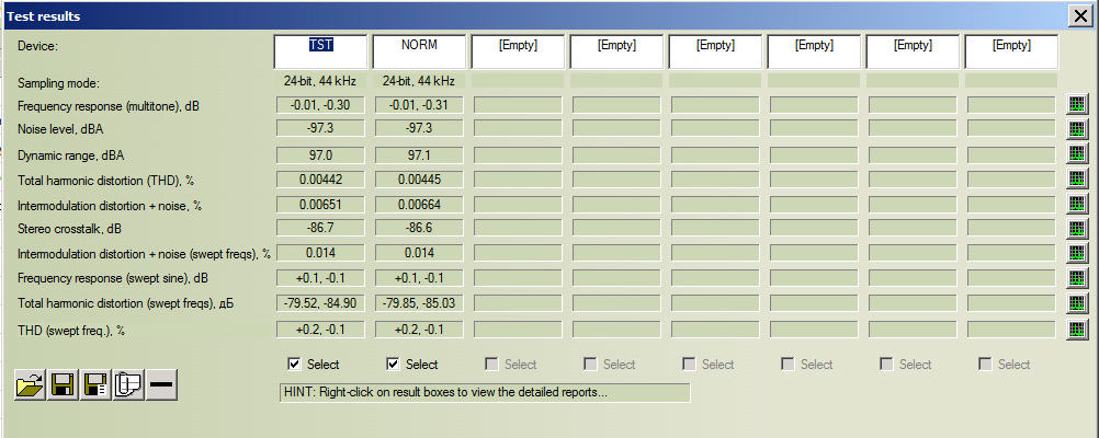

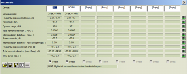

how does this equate to the measurements Scott w took?
They were not measurements but simply actual views of the data.

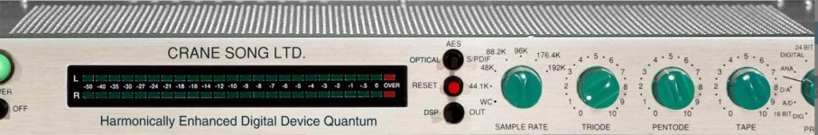

That is exactly why they have boxes like the one in the pic below. It adds distortion to spice up bland tracks. It's a BandAid effect though. If the original recording is good quality, added distortion only makes it sound worse.
Can the Quantum be switched in or out?
