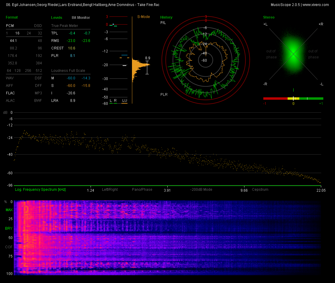

I have done some analysis of the spectral energy distribution of music. As I remember, except for hip-hop, its centered around 100 Hz. Hip-hop is lower. You can use Audacity for this as I remember. It would be worth the effort to update.
Here are the results of the spectral analysis just made on two recordings. The first one is a jazz (well, sort of) number "Take five" from "Jazz at the Pawnshop, 30th Anniversary". The middle plot is the cumulative peak spectrum, and the lower one is the spectrogram (time running downwards along the ordinate, frequency is on the abscissa, and the colour stands for spectral energy). The brightest frequency band (i.e. the highest energy) is centered around 130Hz, and it is also seen on another two numbers ad-hoc chosen from the same disc.

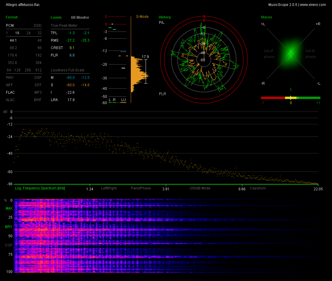

The second example is a classical music recording from a sampler by the German label MDG, who claim not to to use any limiters, compressors, overdubbing, etc. in their recordings. The picture is not as distinctive in this case, with the spectral energy being distributed between 100 and 450Hz.
BTW, the polar diagram shows very fine dynamics of this recording.

That tends to reinforce my fuzzy memory. I have trouble with those plots since I'm unfamiliar with them but it seems to show what I saw some years ago.
