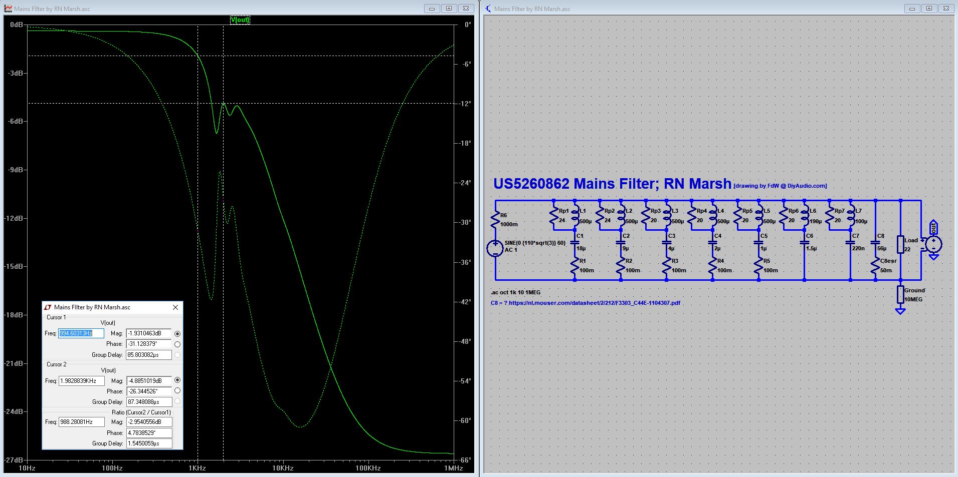

Sorry to intrude, at this time, about the mains-filter topic (so long ago 🙂).
Attached is a AC graph and schematic of the mains-filter as depicted in RN Marsh his US patent 5260862.
There are two questions that I have about the simulation:
1: Why do I not see 20dB of more suppression at 1kHz (maybe I made some wrong assumptions about the mains impedance (or otherwise) and maybe I made some wrong assumption about the load).
2: What about the 56u capacitor (C8), is that not a bit large? and if 56u is needed would this be a suitable capacitor https://nl.mouser.com/datasheet/2/212/F3303_C44E-1104307.pdf
Frans.
Frans.
